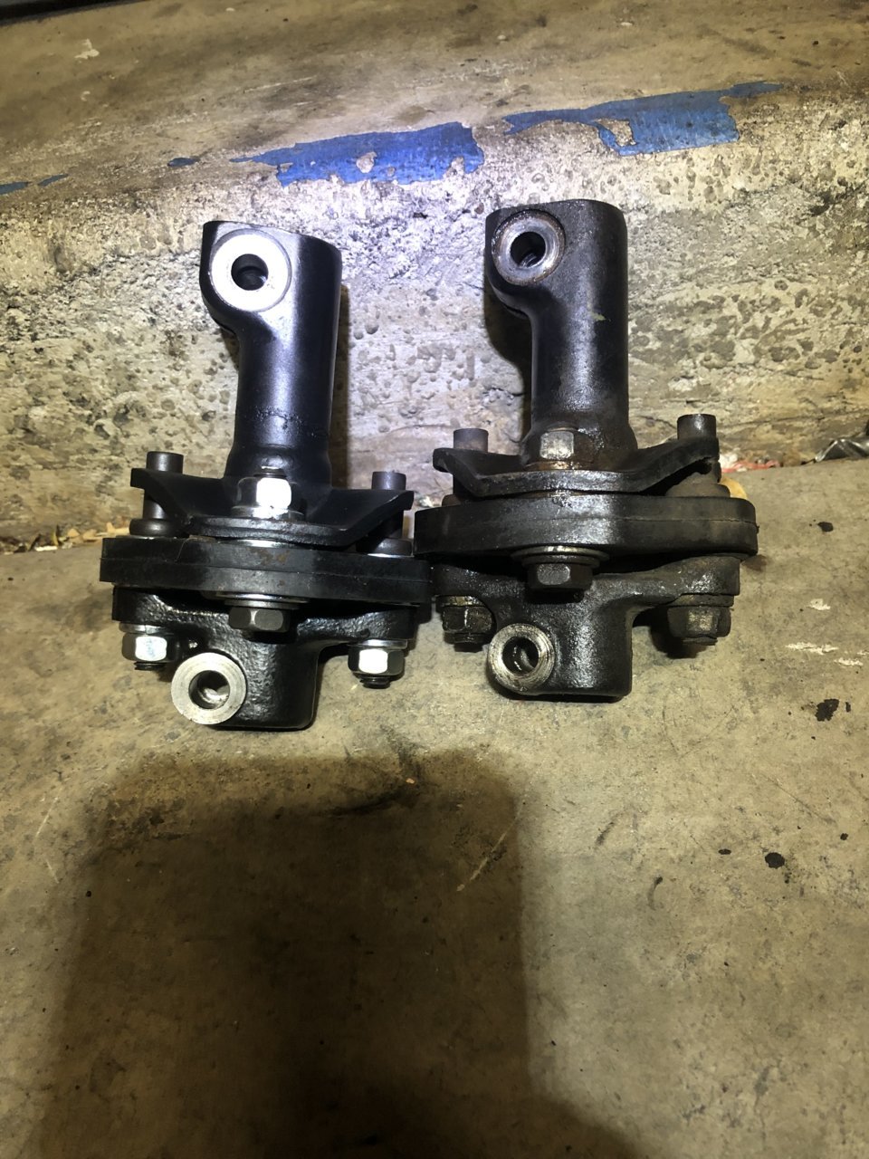

    It’s about time I updated this thread. I gave the dealer my vin and ordered a new intermediate shaft. I replaced it, but I’m still getting binding issues. I took the truck into a mechanic before I moved and mentioned I had replaced the intermediate shaft, and he mentioned I replaced a different part.
    Here is a picture of what I replaced and where it went. Based on the diagrams I’ve seen for the 1st gens, that’s the intermediate steering shaft. Am I wrong?
    Doesn’t really seem like a “shaft” to me. Can anyone help point me in the right direction? Looking to take care of the binding issue so I can get the truck registered in Texas.

  8. Oct 15, 2019 at 6:31 AM
    se7enine
    se7enine MCMLXXIX
    Apr 18, 2013
    #102322
    23,430
    Reno, NV
    You can remove the clock spring and test in the driveway to see if it still binds without it. If you need another you could try the junk yard. They usually don't bind unless you remove the steering wheel and over turn it to one side by accident. It has sticker instructions on the face for how to center it.

    have you tried putting the front up on jack stands and having someone turn the wheel? maybe you can see if there is/where the noise is coming from (grinding). or if there is any noticeable part that seems to be causing the restriction.
    as well, just because the rack was replaced doesn't mean it can't be bad. as with anything, even new can be bad or have a defect :)

    That's true. The clock spring noise seems to have calmed down. My bigger concern is with the binding. I really have to manhandle it sometimes to get the wheel to turn, and other times it sticks and doesn't return to center after completing a turn. Most of my research points to the intermediate steering shaft, but the only information I seem to find on that relates to 2nd gens.

    Did you try turning the wheel when the intermediate shaft was removed? Don't spin it more than normal though, or it would damage the clockspring.

    Has to be some sort of carrier bearing also up under the dash for the column. I would think prob. a pair of them.

    But wouldn't a bearing make it difficult to turn in both directions?

    I s'pose you are right. I forgot that strange tidbit.
    I guess I'd tear that thing all apart and check every stage of operation.
    Sounds like the rack has a spur though.
