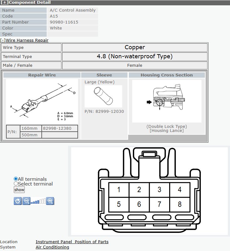

    Toyota doesn't sell pigtails, you have to buy the connector body and terminals separately.
    I won't say it can't go on fire but I've never heard of one burning down from it.
