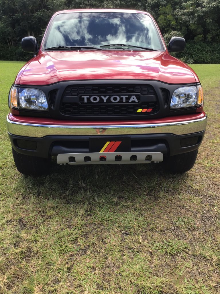

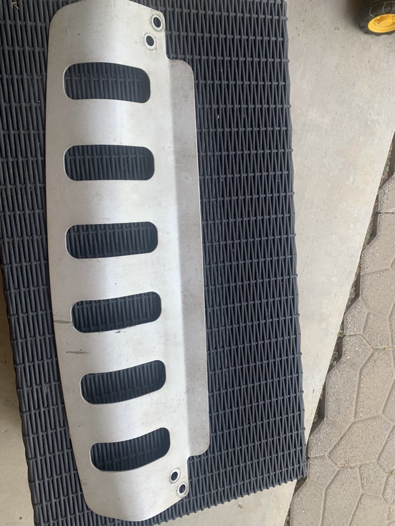

    Hello fellas,
    I recently came across an oem skid plate. I rarely see them available and I was excited at first. Now, turns out I need brackets and hardware in order to install. Anyone have any leads or know how I can purchase the nardware and brackets needed?

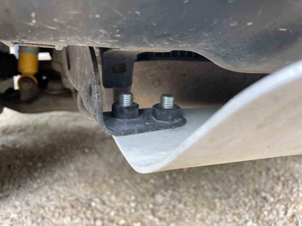

    Wish I could give you the part number for these brackets. This is what they look like. The bolts are M12 1.75. I just had to go get new ones because I lost the originals when I took it off last.

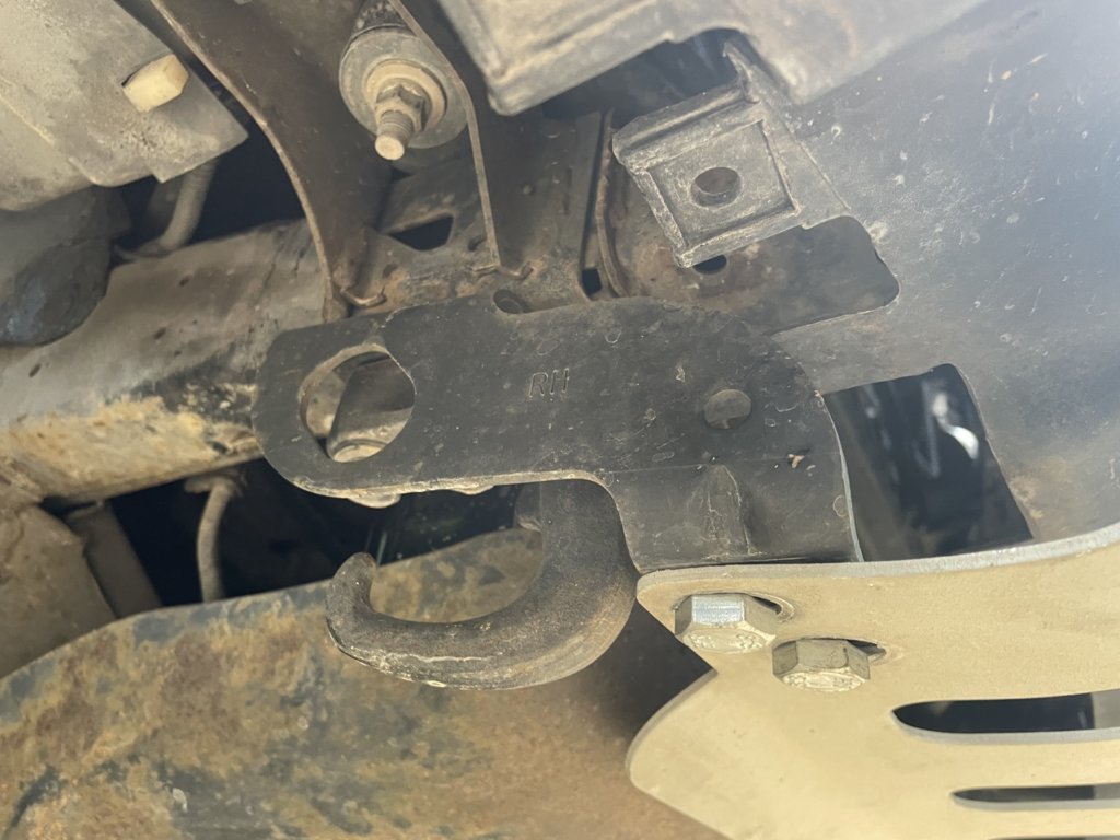

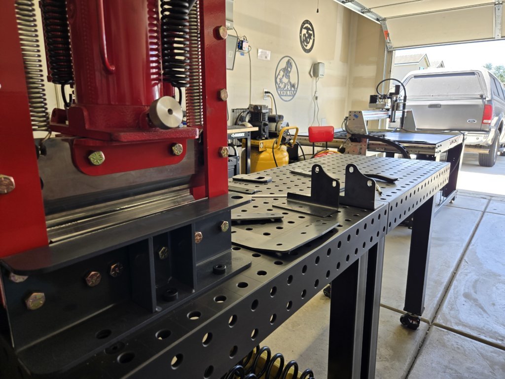

    His bolts for both his hook and loop (factory) seems as if they've never been removed.
    It was really hot out so we didn't want to spend much time trying to get them off but I did get them off on the passenger side.
    Driver side needs to sit for 24 hours with some penetrating fluid.
    Anyway, I used the mock up I made (before he arrived, no dimensions) and it was pretty much dead on. Just had to widen one flange, notch an angle off the long leg for clearance, and input the hole dimensions in CAD and the first piece was dead on perfect.
    Driver side is identical in terms of hole spacing so I simply mirrored the passenger bracket.
    Easy stuff really.
