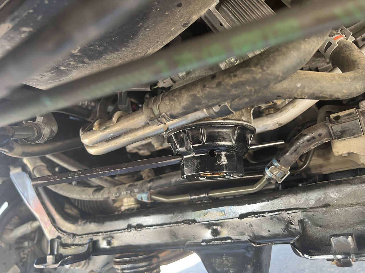

    Anything else I can try before towing to the shop?
    The bottom plug was crossthreaded and leaking oil, noticed when I got to work. Went and got a replacement metal housing thinking it would be an easy swap. The toyota filter wrench broke the tabs on the housing immediately, strap wrench did absolutely nothing, so I drilled through to use a punch as leverage. The housing broke off. I’m extremely frustrated with myself and this situation.
    Last oil change was well over 2 months ago. Housing drain plug must have been slowly unthreading cause it was the source of the leak.
    Anything else i can try? Otherwise I’m going to tow it to a truck shop

    I'd agree on tapping tangentially to the housing with a sharp screwdriver/punch and a hammer.
    You can damage the threads if you go bananas destroying/breaking what you have left in there. I'd be careful.
    Out of curiosity, did you do the most recent oil change?

    No, just stick the punch as far up and in on the tabs to have the least chance of breaking it off. Couple taps on one, move to the next one in line, couple taps, repeat until it spins off. Like using the back of a can opener to tap the lid free on a tight jar.

    sorry, meant to say that I already tried that and broke the tabs. I meant is there harm in trying to split the housing? Dont wanna damage the metal threads

    You already broke all of them, all the way down? In that case a flat tip screw driver might be able to bite into the remnants of the plastic tabs enough to start turning it when tapping.

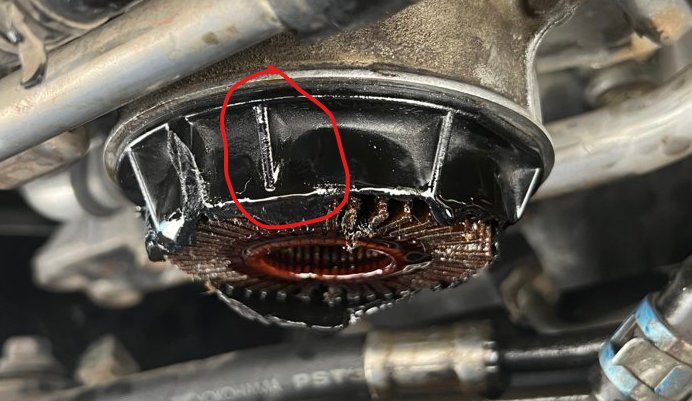

    Take a screw driver (large flat blade or the like) and put it against the flat part of the tab that's left and tap it with a mallet... don't go all hulk on it, but if you start tapping it in a counter clockwise direction (when looking up at it) it should loosen up and start turning off... don't use anything metal to break it up or you will damage the aluminum threads.

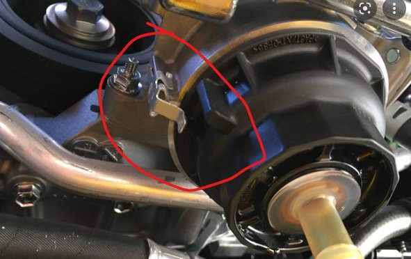

    Also, make sure you don't have this metal tab stuck up against one of the remaining tabs, it won't turn if it's stuck.. Sometimes those cheap oil filter housing wrenches pushes this tab IN towards the tabs rather than the tool pushing them OUT like they are supposed to.

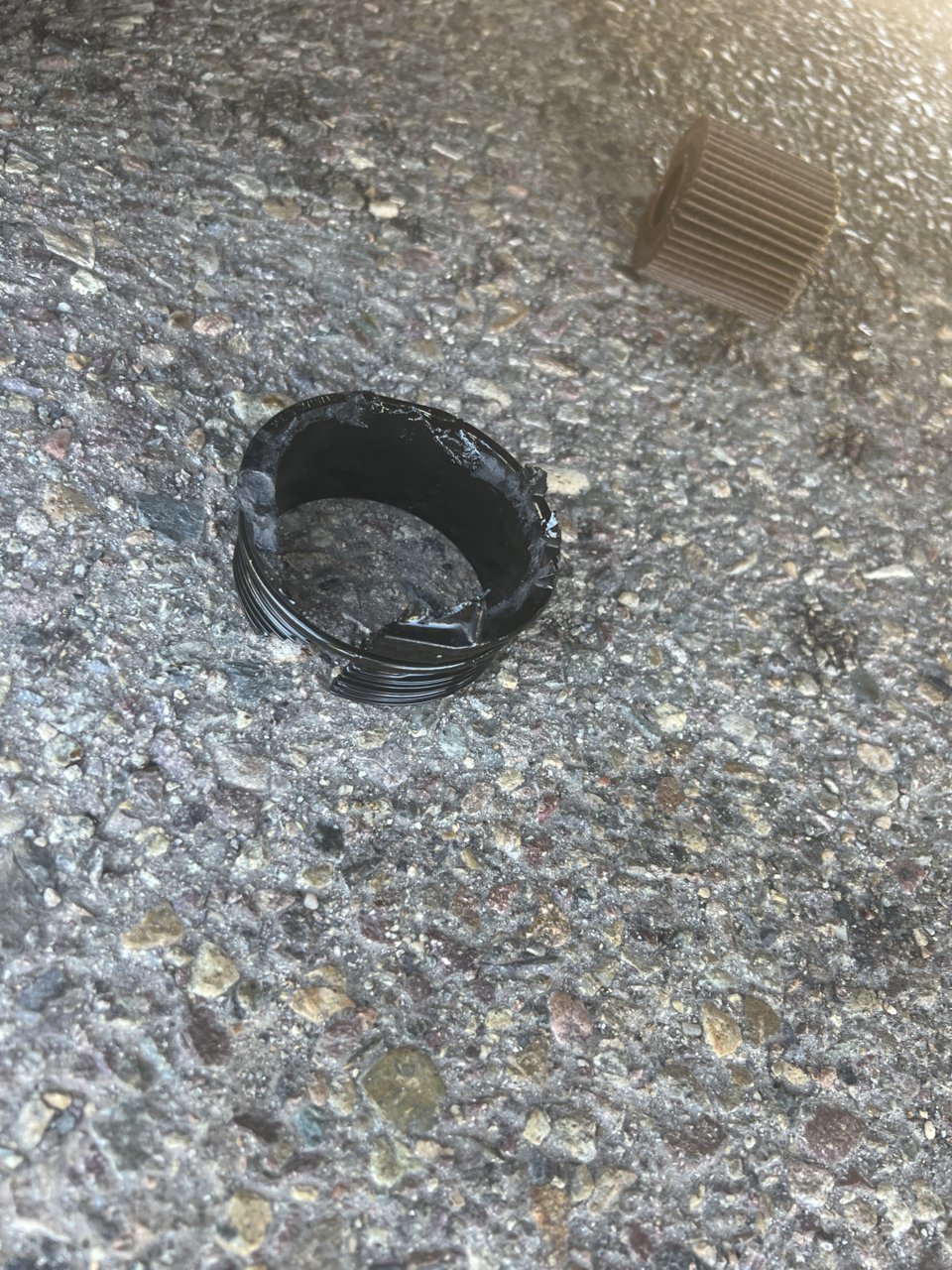

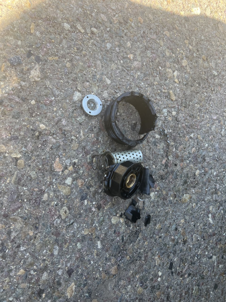

    Ended up getting it by continuing to break the plastic flange where it meets the metal housing until it cracked and came out. Thanks guys!
