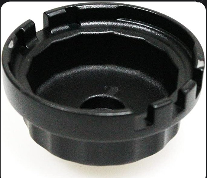

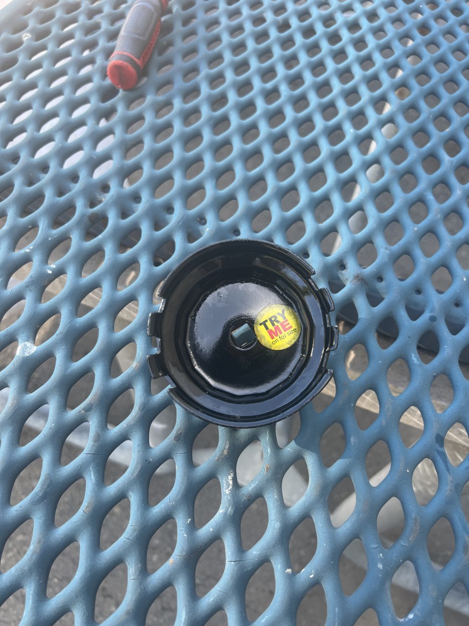

    Actually curious which wrench the OP has. It looks like this only has the middle tabs broken off, mine (the OEM version) grabs onto all 3 on both sides.
    kahanabob and ilyace[OP] like this.

  8. Jun 21, 2022 at 11:33 AM
    #28
    ilyace
    ilyace [OP] Well-Known Member
    Jun 28, 2021
    #369861
    179
    2020 MGM TRD 4x4
    This is the one I was using

    drizzoh
    drizzoh itsjdmy0
    Jun 29, 2020
    #332922
    2,269
    Andrew
    Arizona
    2021 Tacoma TRD Off-Road 4x4
    That looks pretty similar, looks like your filter housing is a bit different than mine though - the 3 tabs are bigger, like the one posted here.
    My posts were geared towards the normal crowd who gets themselves into an awful situation because they don't have the correct tools or know-how. Glad you were able to get this sorted out.
    Edit: nvm that only shows 3 tabs on one side. These are weird. lol.

    2017 White SR5 DCSB V6 4x4
    This exactly one i use on my 2 cars. It works fine and aligns properly with tabs.
    I usually let the engine to cool off before taking the filter housing. Comes off much easier than on hot.
    ilyace[QUOTED][OP] likes this.

  20. Jun 21, 2022 at 12:55 PM
    #40
    zoo truck
    zoo truck Well-Known Member
    Apr 21, 2020
    #325379
    8,948
    2020 quicksand sr5 tacoma
    None
    More like the wrong wrench. New motivx wrench is suppose to eliminate breaking, or cracking those tabs....it only grabs the flutes.
