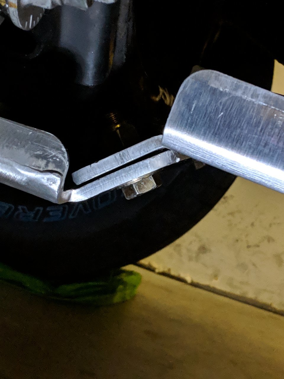

    This has me concerned. I am wondering if the length of the mount post were cut correctly. I have an easy fix for you, I can send spacers and it’ll bolt right up. I’m going to have to investigate because although it should be tight, it shouldn’t be that tight obviously.

    Thanks for the quick reply. I can post any other pictures or measurements you need.
    Would the spacers be for the middle and rear mounting points? That would mean I need longer bolts for those two mounting points in order to clear the diff.
    I also noticed that the IFS sits considerably higher than the trans plate and I have to use a jack to bend the trans plate up. Even when I do, the outer edge of the IFS lip hits above the trans plate lip (on the actual horizontal plate) and prevents a gapless mating surface, no matter how hard I crank the two joining bolts. I was going to grind down the IFS so that I could get it to mount to the trans plate without any gaps.

    I can send both but I believe you only need the front. I can send hardware too. Message me your order number please.

    It appears that the skid plate is hitting the front diff about Midway between the middle and rear mounting points. I thought about stacking washers on the middle mount but the diff would still rest on the plate.
