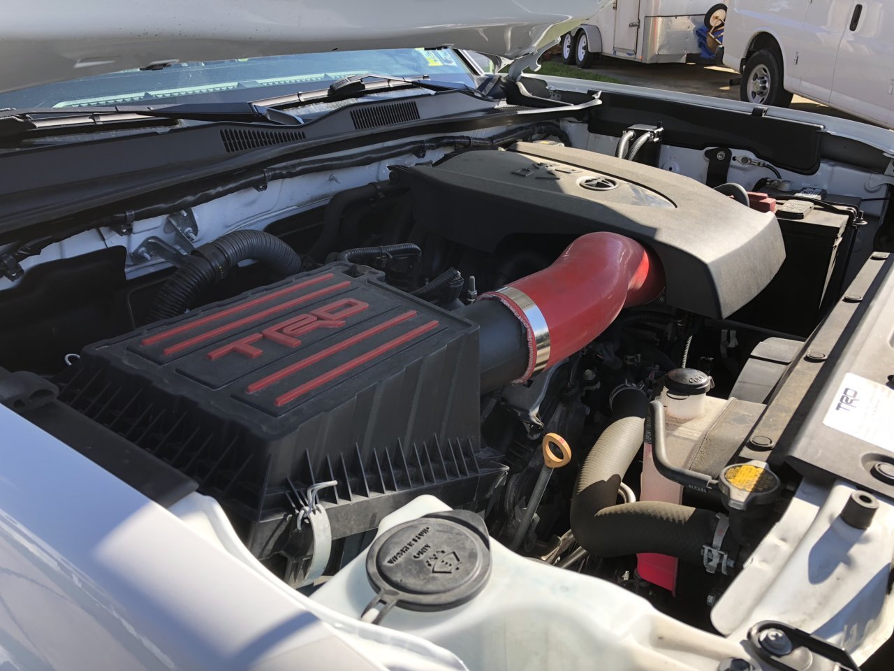

    Zero gains except for my son's expression at WOT

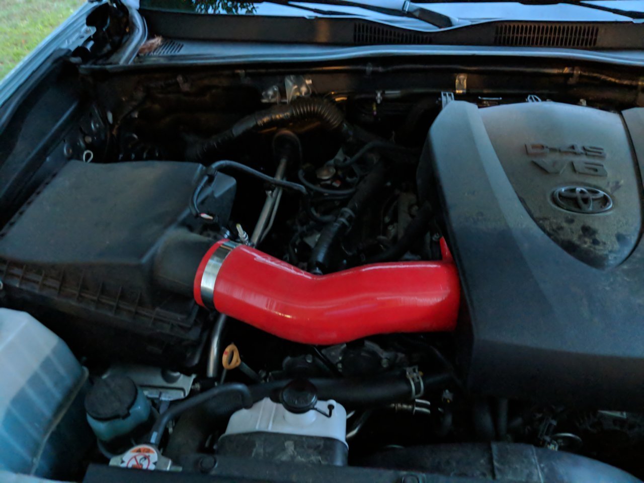

    Yes, sort of. If you want a clean run, the HPS tube goes from the air box to the TB and has the EGR (?) line as part of it. If you just want to cut out the resonator section, then the parts store might have something as long as the left and right diameters are the same. As you can see in the OP kludge, it ain't pretty and probably causes worse performance?

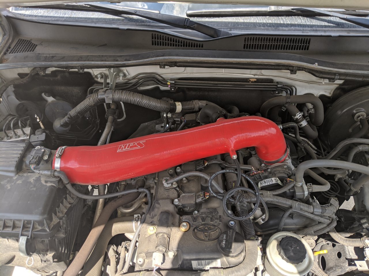

    From Me to HPS:
    "Hi, I have a 2016 Toyota Tacoma 4-cylinder. I would like to run an air intake tube from the stock airbox (after the MAF) to the throttle body directly and remove the stock resonator box above the engine cover. In order to do this I need to reroute the vacuum hose and breather hose from the resonator box to the new tube. Do you make something that would allow me to accomplish this, or alternatively would you be able to fabricate something that would do this?
    There are many people with the 4-cylinder on tacomaworld.com that want to bypass their resonator boxes for aesthetic value (under hood simplicity and deeper intake growl), without using a 3rd party cold air intake (cai), because many of us believe the stock airbox configuration will preserve engine longevity and a 3rd party cai will decrease performance (mpgs) and engine longevity.
    Please let me know if this is possible with an existing product you have or whether you would be willing to fabricate a part to accomplish this."
    From HPS:
    "Hi Peter,
    Thanks for your inquiry and feedback.
    We forwarded the request to our R&D team and they will be working on this in the next couple weeks. The lead time for the first prototype is about 2 months from now.
    Best Regards,
    HPS
    15332 E Valley Blvd, Industry, CA 91746
    Phone: 626-747-9200
    Fax: 866-277-5441"
    WOOHOO!
    Kabogski and tonered like this.

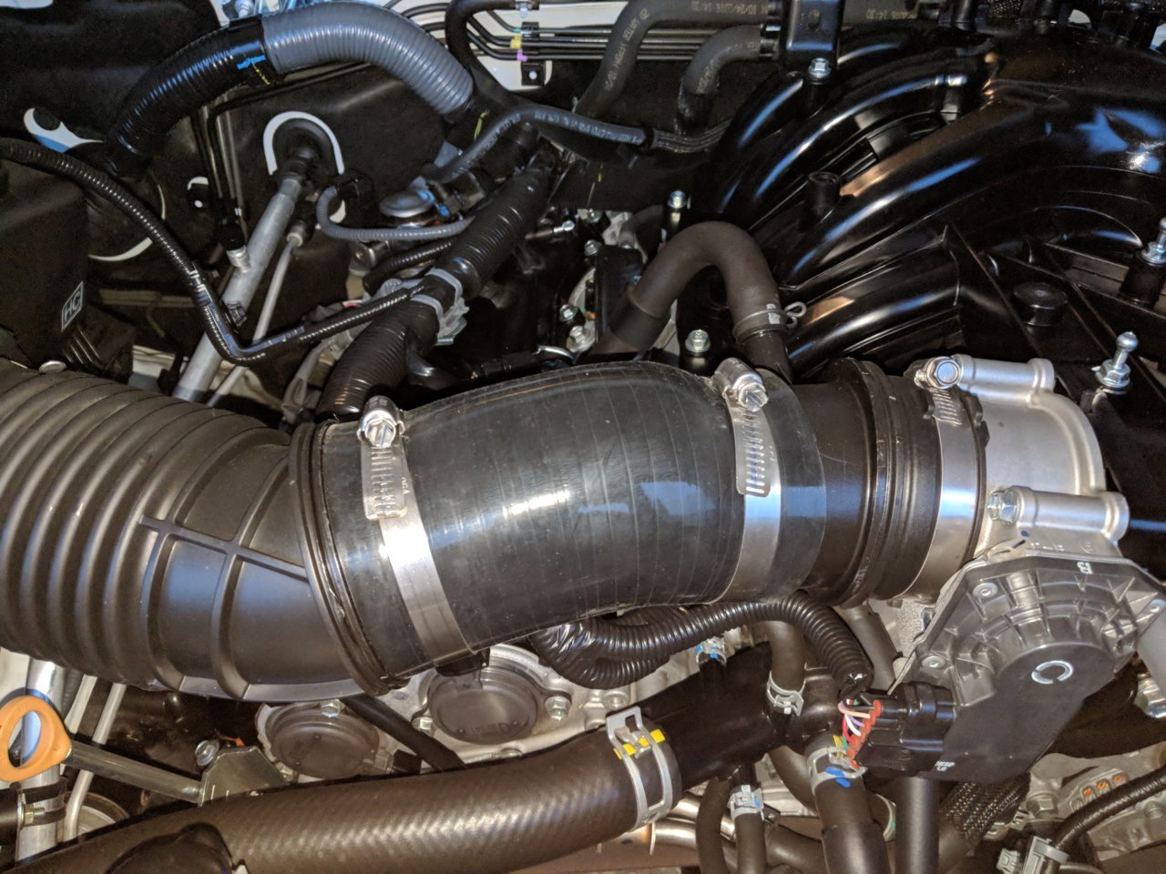

    My Butt Dyno says more low end. Ecu took some time but now they're best friends. I feel like I never take it out of 5th on the highway now, instead of constantly downshifting to 4th to pass before.
    Mpgs are identical to slightly better. A little more cab noise but honestly the 4 banger is a little louder than the 6, so it was already a little noisy. Definitely want the equal length exhaust header to pair with this.
    Much cleaner under the hood, and changing spark plugs/coils feels much less daunting now.
    Anything specific you want to know?
