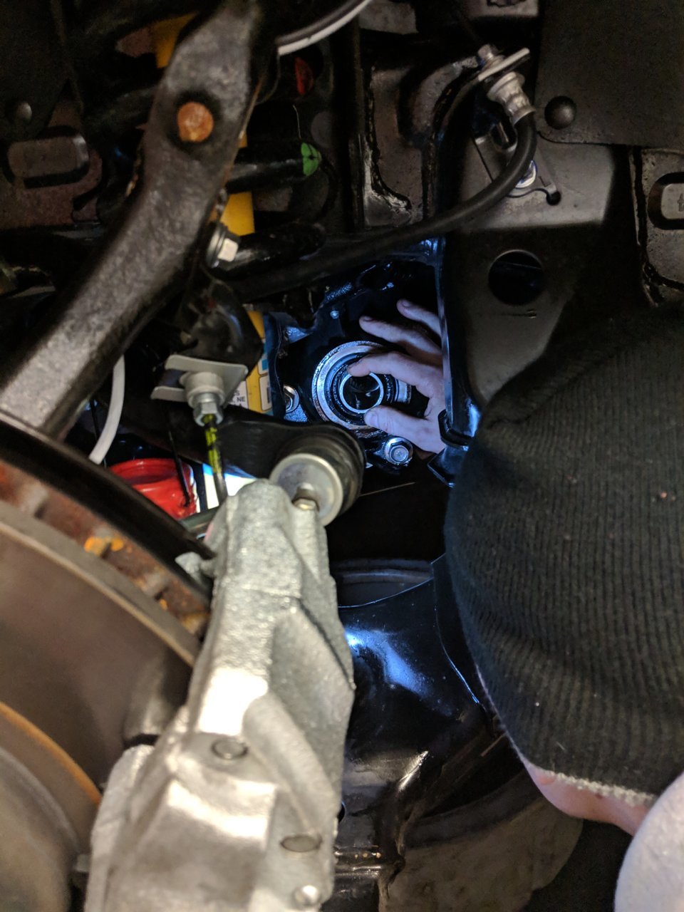

    I got everything finished up last night. I was expecting it to take an hour and it took five lol
    Things I learned:
    -Pushing upward from the bottom while pulling at the axle helped substantially. I tried prys, using the metal ridges to hit it outward, yanking at it and a lot more. The solution ended up being pushing from the bottom while prying from the side and having a buddy pull at the same time
    -Couldn't get the metal tool to fit behind the bushing for the life of me. Ended up just breaking the bushings lip with a chisel to resolve the situation.
    -When putting the new bushing one in, it was like it didn't fit. The tolerance is VERY tight. We didn't want to force it and cause any damage because I needed to get home that night and it wasn't worth the risk. I tried various tapping methods and a socket, couldn't get anything to work. Ended up putting it in the freezer for about 45 minutes and we got it in first try after that (def wasn't my idea, i would've never thought to try that).
    -There was a little bit of a struggle getting it back in, but not nearly as bad as getting it out. Put the open end of the c-clamp faced down and it slides right in.

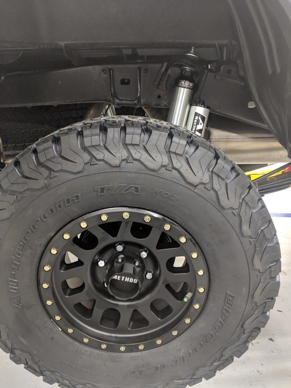

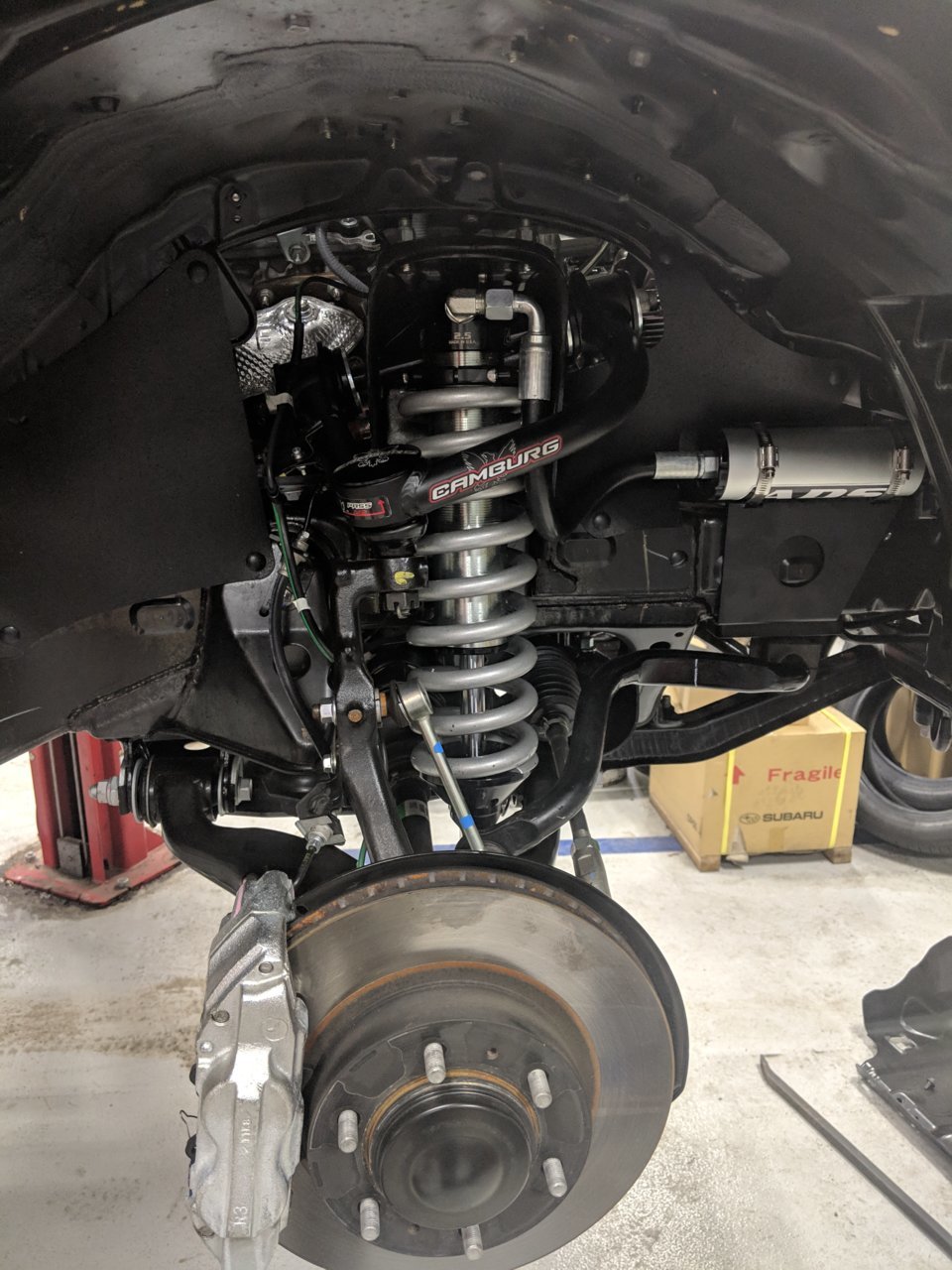

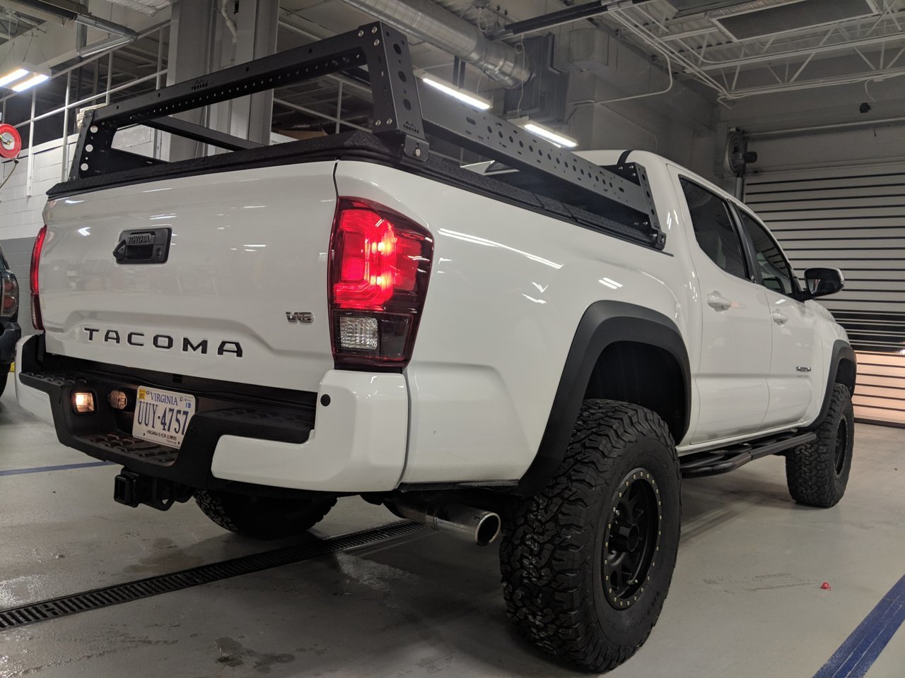

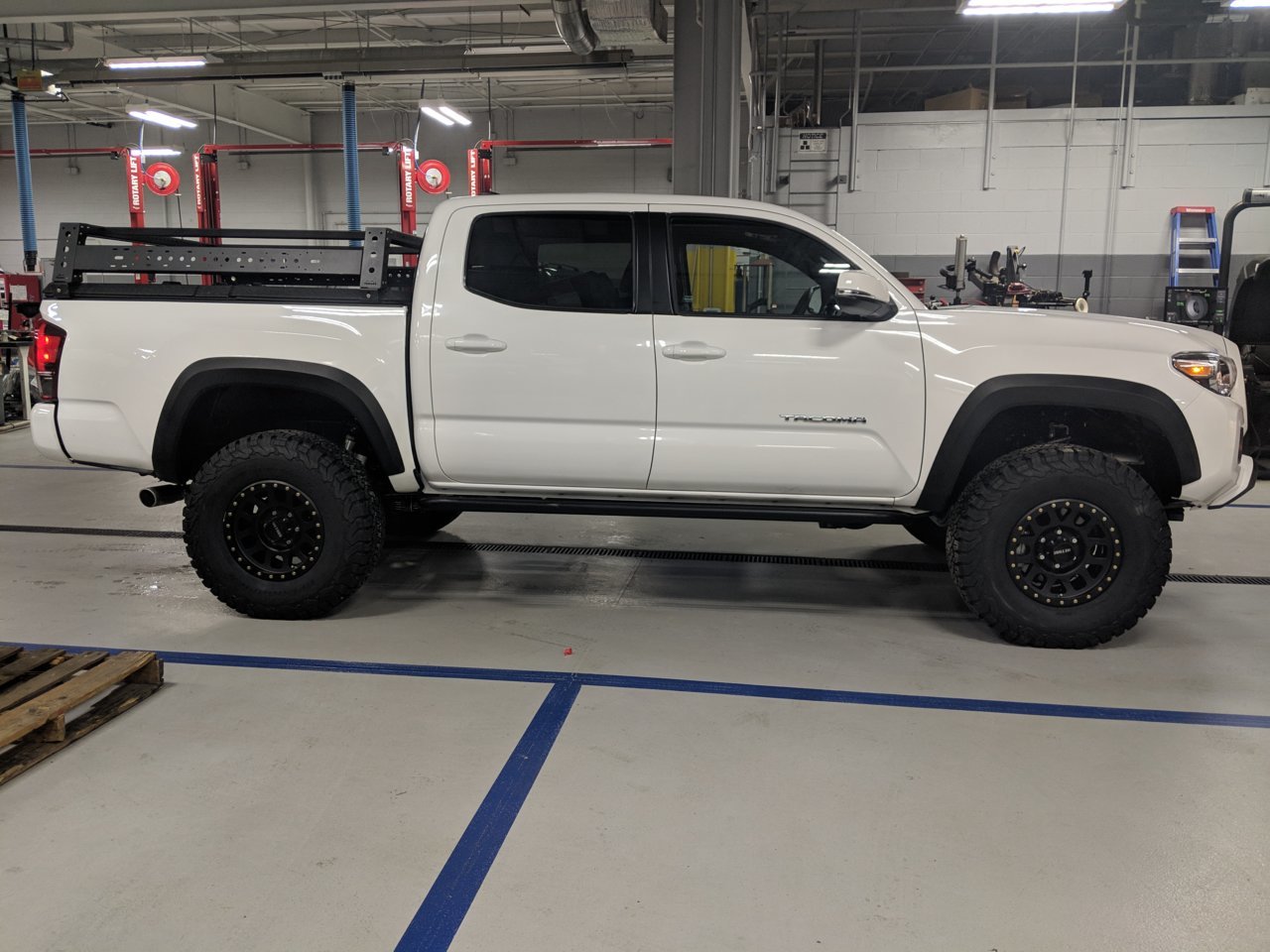

    Making progress

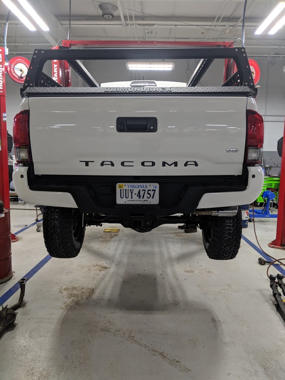

    So happy to finally get it on

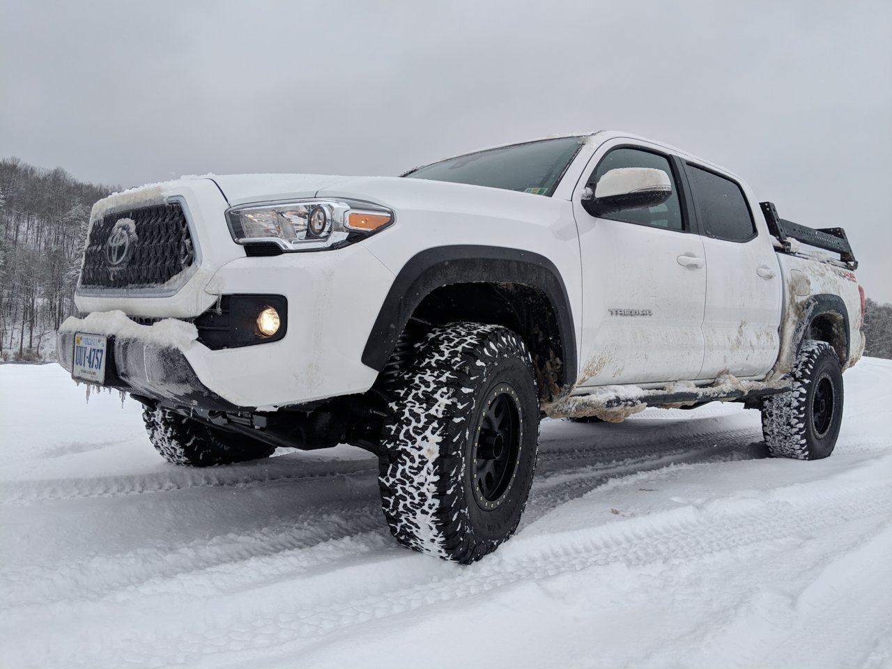

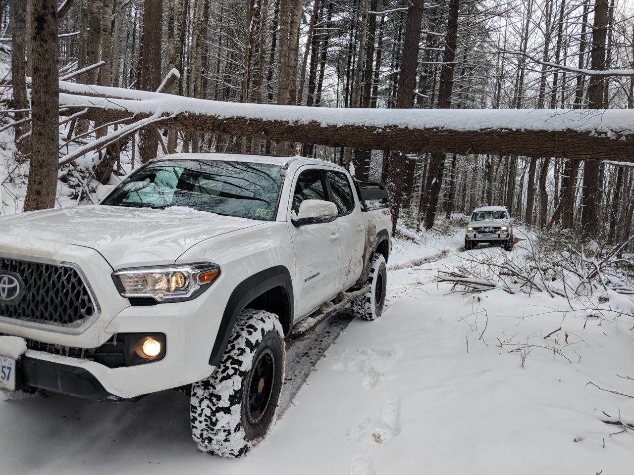

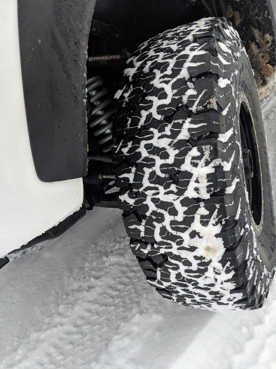

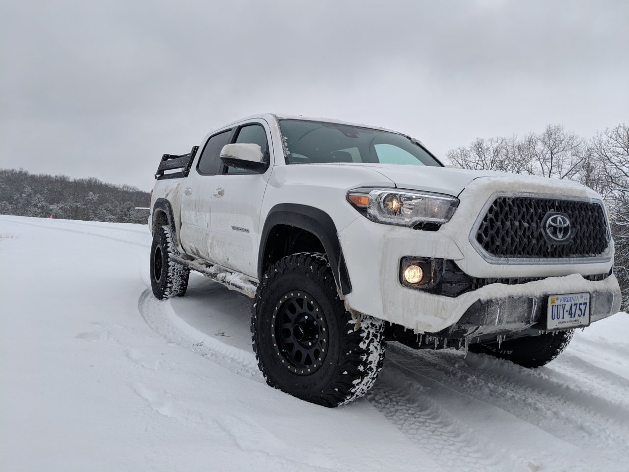

    I got to take mine out today, I'm really happy with the ADS. It rides better than stock and I think it looks great with about an inch of preload. We went up some trails with about 8 Jeep's, they we're certainly better off than me. I slid a lot, had to go in 4LO and use MTS just to stay on the trail where there were some steep degree slants. We were on about 4 inches of snow and some icy spots. IIdidn't get many pics at all but overall it was a great time.
    One thing I had read a lot is that I'd have to do the CMC, so I had bought a plate for it. I don't have any rubbing at all though, not even full lock or backing up.

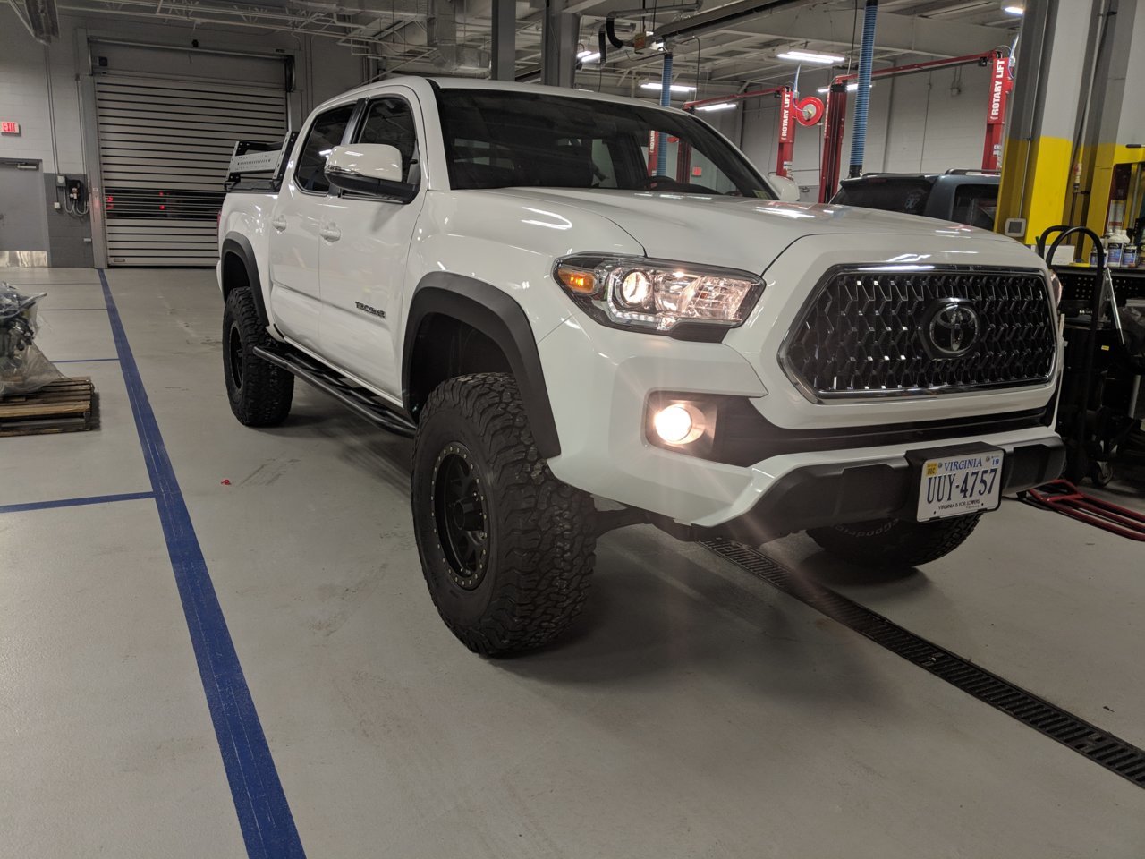

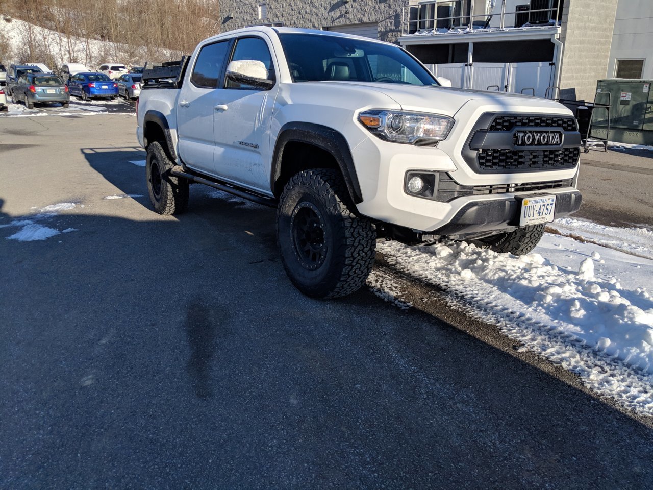

    Got the pro grille on last night. 600 miles and it's really starting to come together

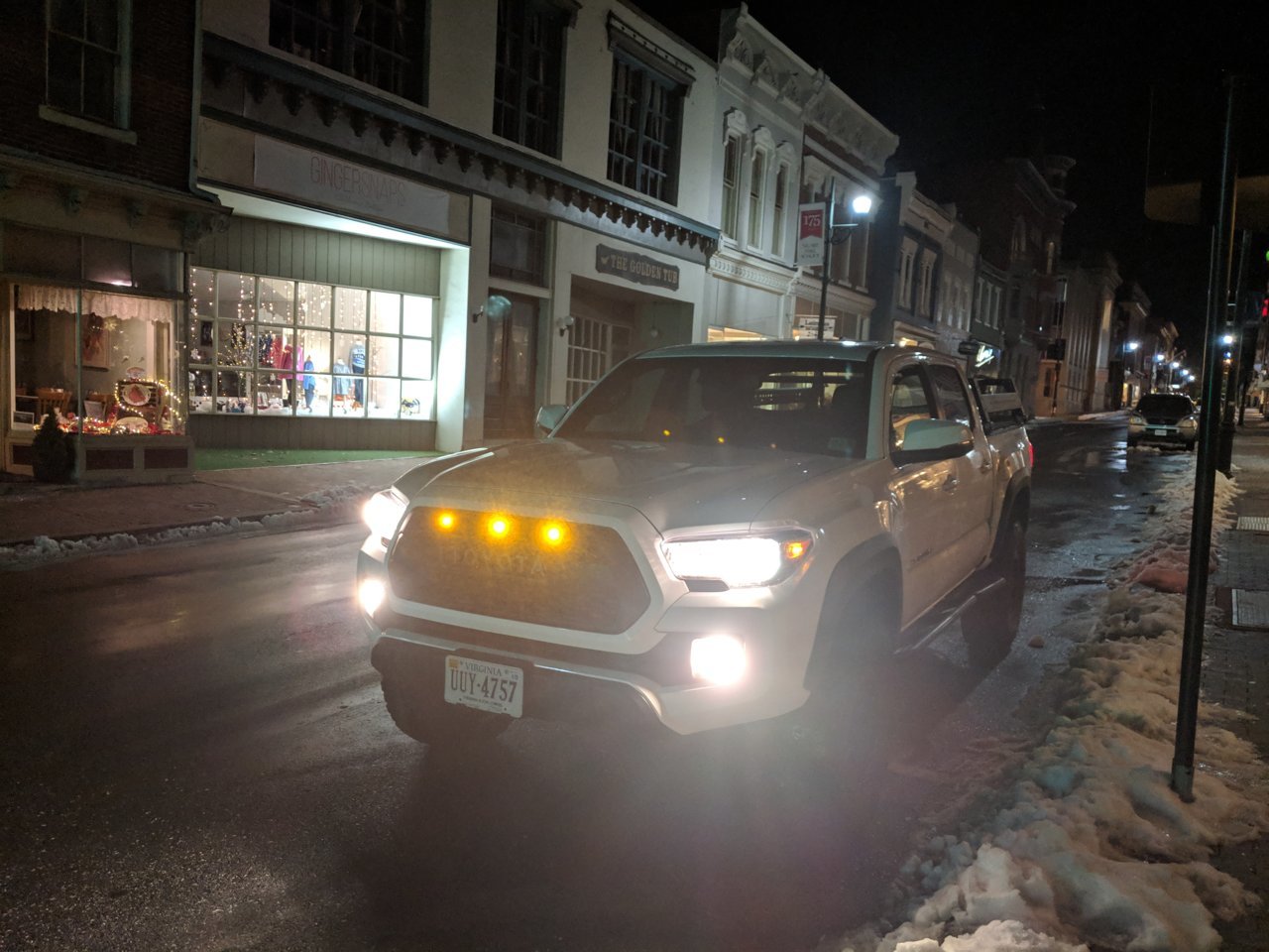

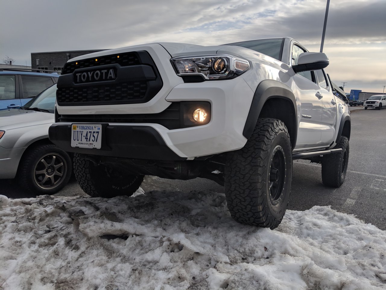

    Raptor light installed (sloppily). I honestly might remove them, I'm not sure if I like them as much as I thought I would

    Not a fan, but everything else is looking good. Looks like those tires just packed the snow in and probably why you had traction issues. Did you air down at all or just run regular psi?
  14. Jan 16, 2019 at 5:34 AM
    #54
    Frawstme
    Frawstme [OP] Well-Known Member
    Aug 27, 2018
    #264315
    125
    Yeah, I aired down a little but just to 22psi. I wasn't sure how low was too low lol

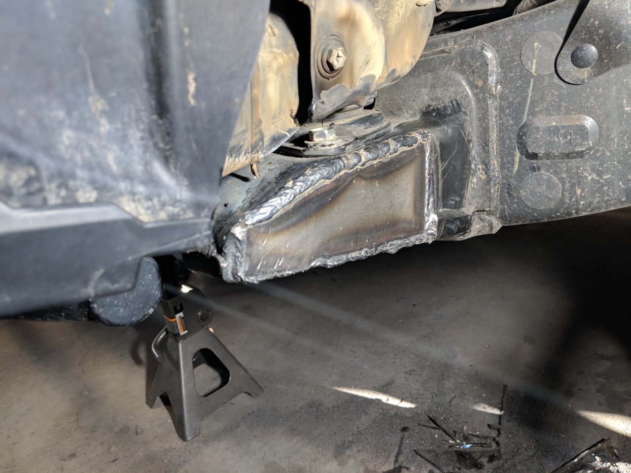

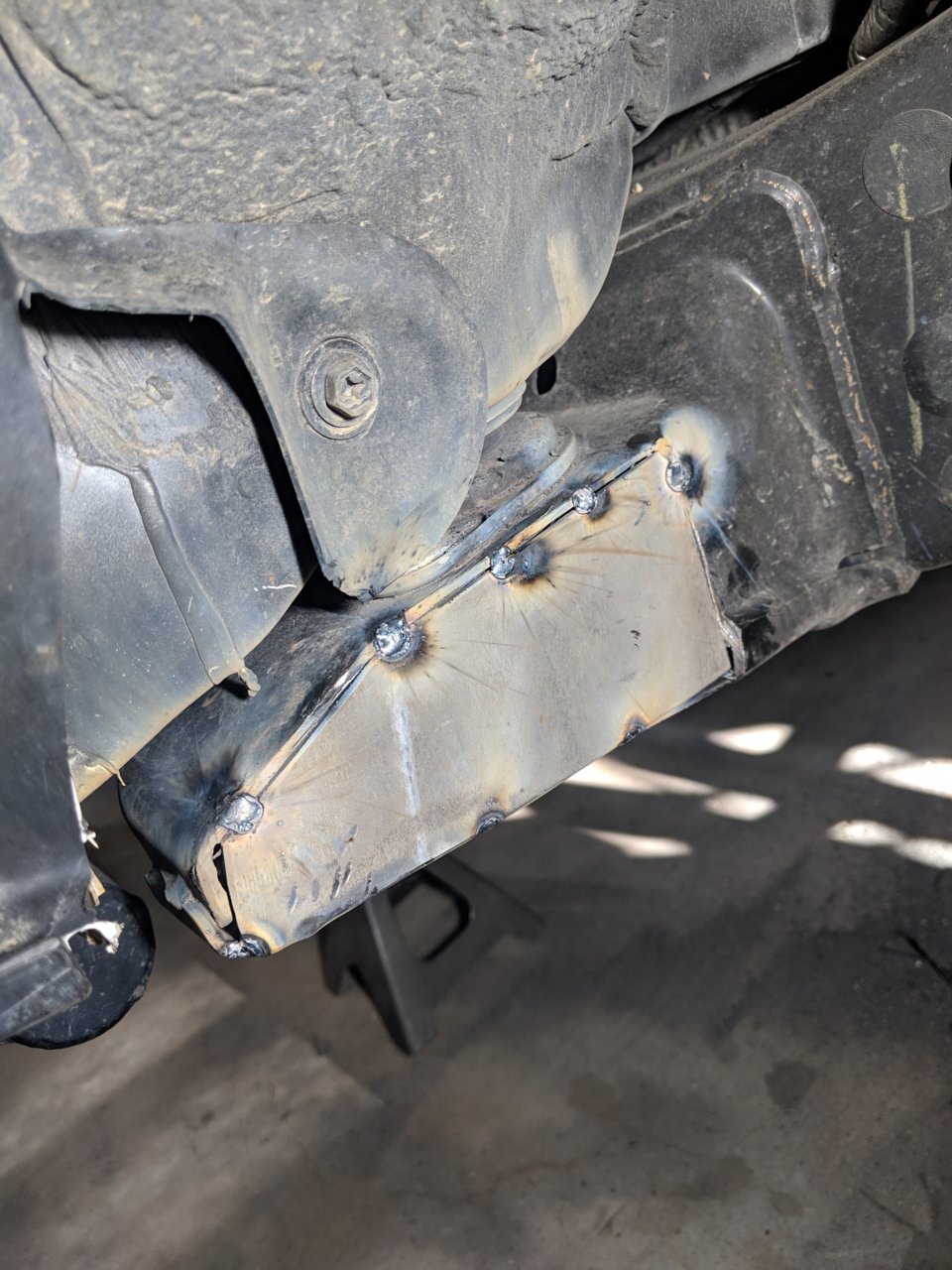

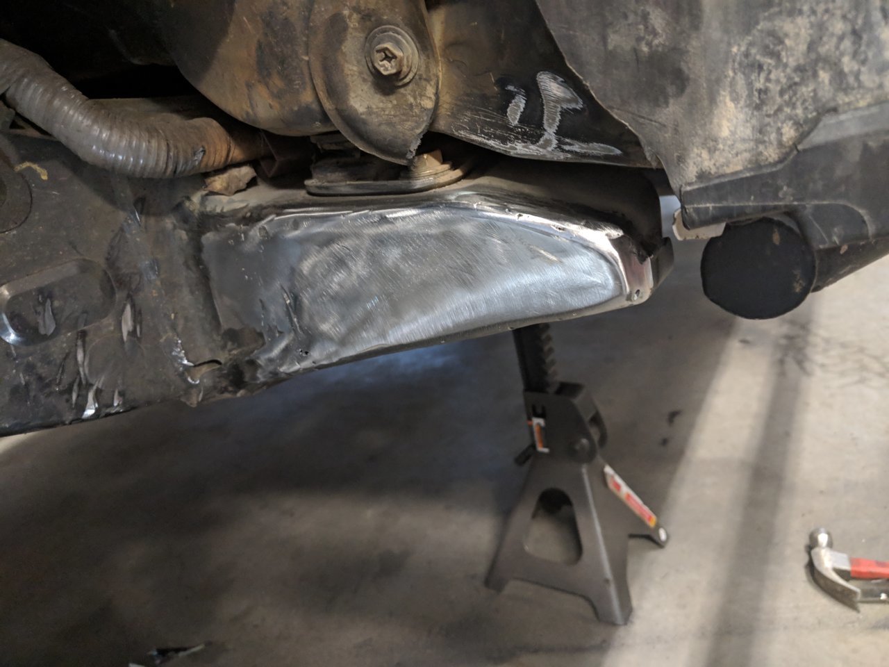

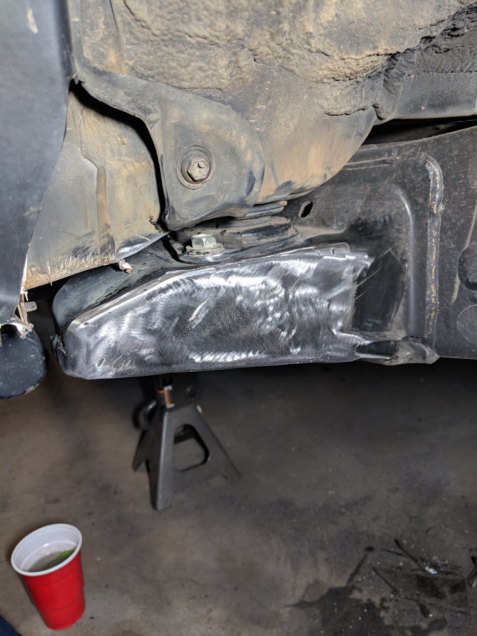

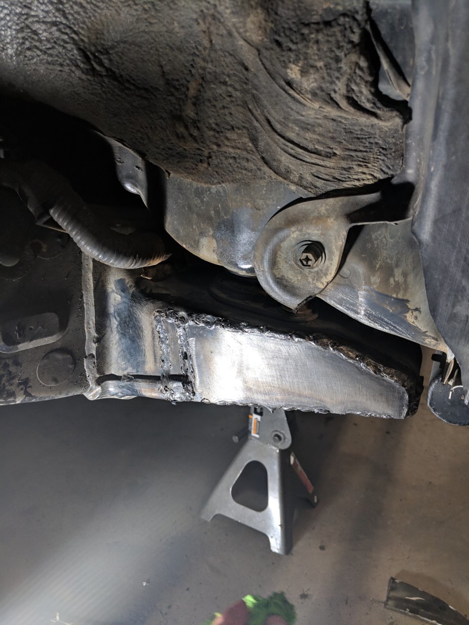

    Did the cab mount chop today. First pics are driver's side, we accidentally cut too far in and had to weld a secondary plate so it turned out sloppy. Passenger side ended up a lot better.
    Actually I'll upload them later my connection sucks here

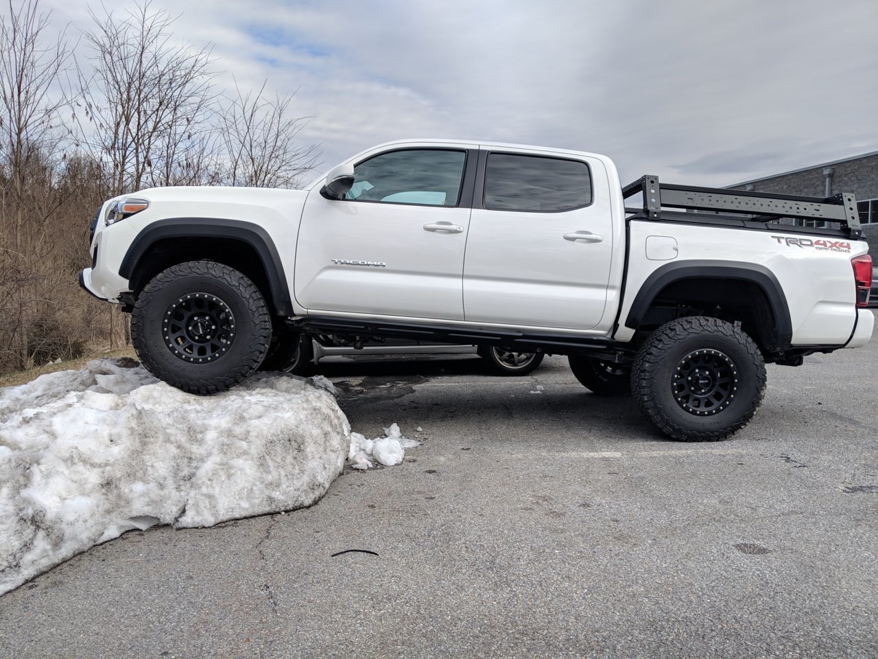

    It's odd, because I was almost never rubbing except if I lurched downhill at a pretty extreme angle. Now I did the CMC and I keep rubbing on something when I parallel park. I can't find what it is though and it doesn't happen each time.
    Anyways, I was bored and took some pics today in our "trucks only" parking spot ;)

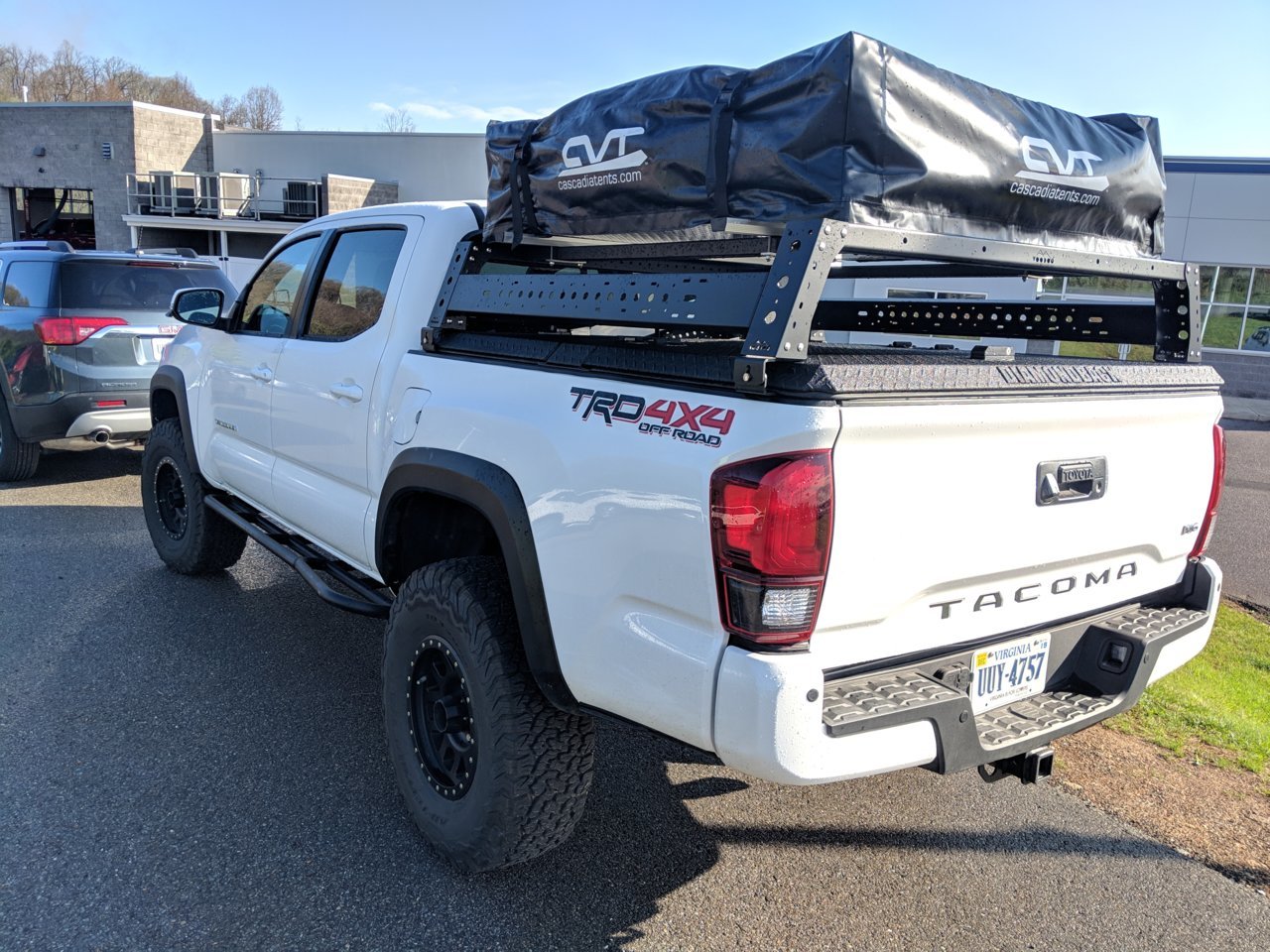

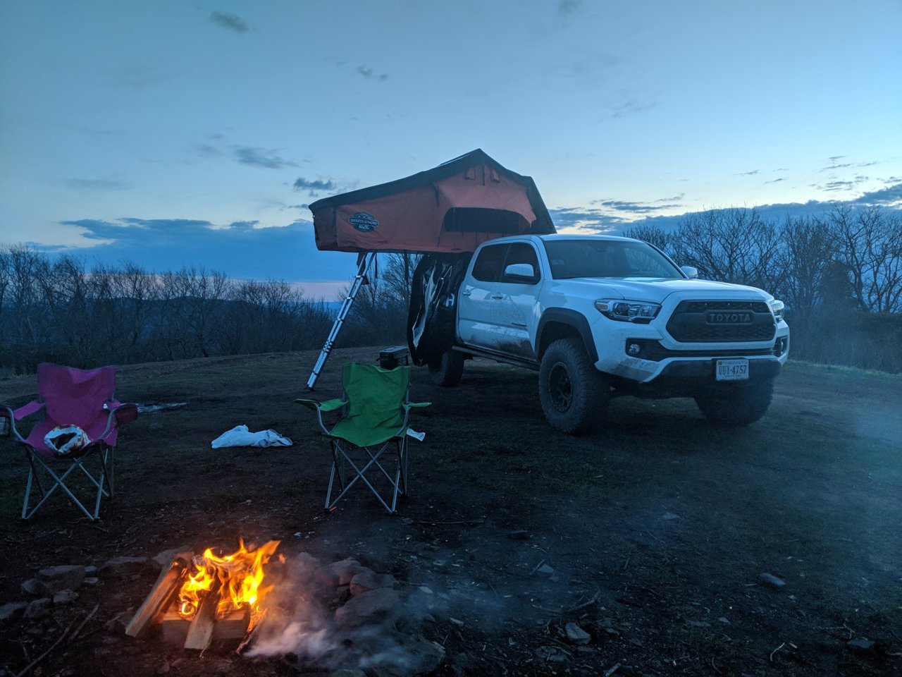

    It's been a while since I posted an update. I haven't done much with it but I finally got my rooftop tent fixed and was able take it out camping. Super excited!

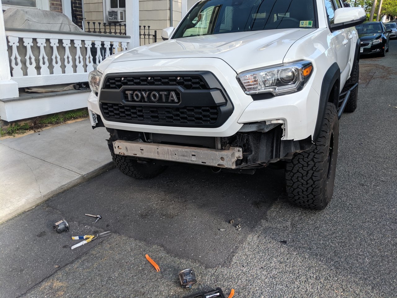

    Did some prep and preliminary cuts for my bumper that came in today. Installation on Friday, i can't wait
