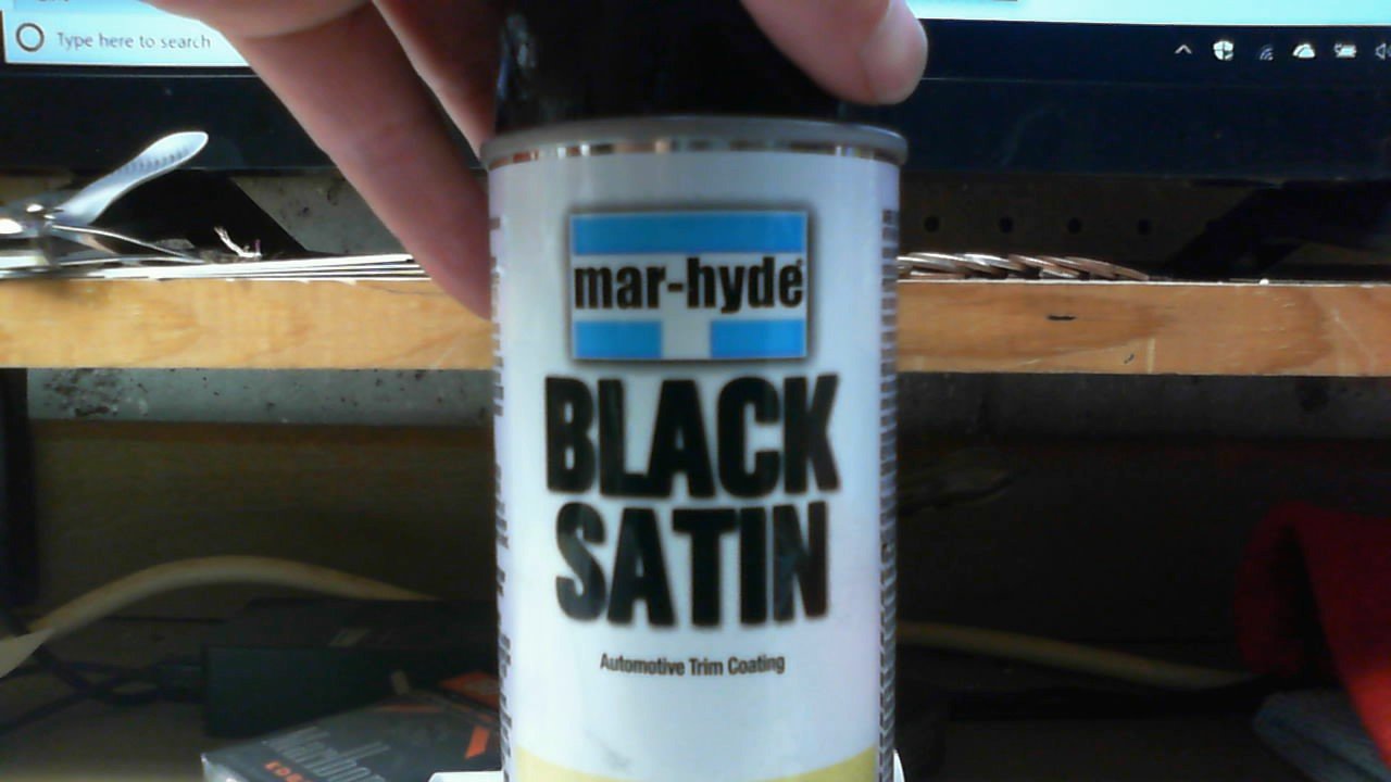

    The sun really does bleach them out in time, I do paint a lot of those on my Dealerships lots … Just degrease the area mask off and paint it, I've been using
    Mar-Hyde Black Satin over 20+ years on plastic trim and bumpers for car lots.​
