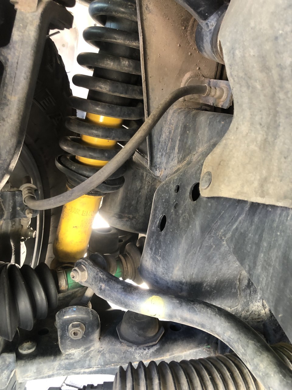

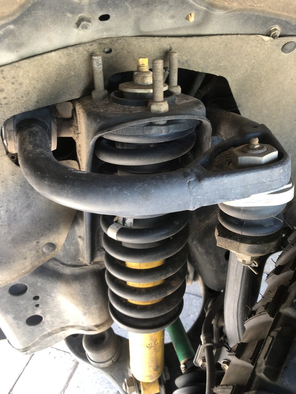

    So here are the fronts, hope the cell phone picture are good:

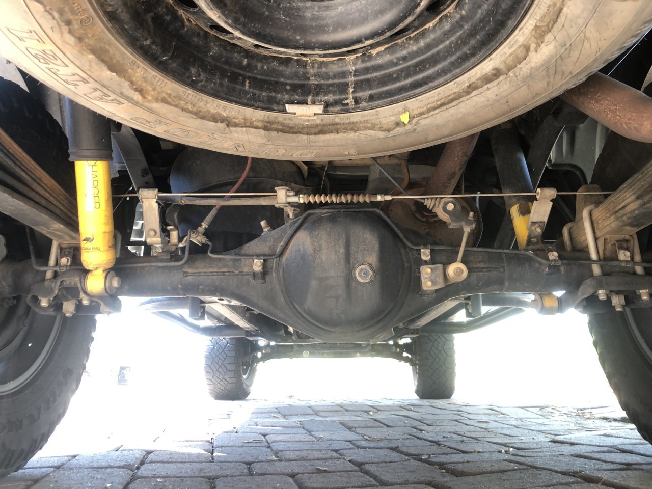

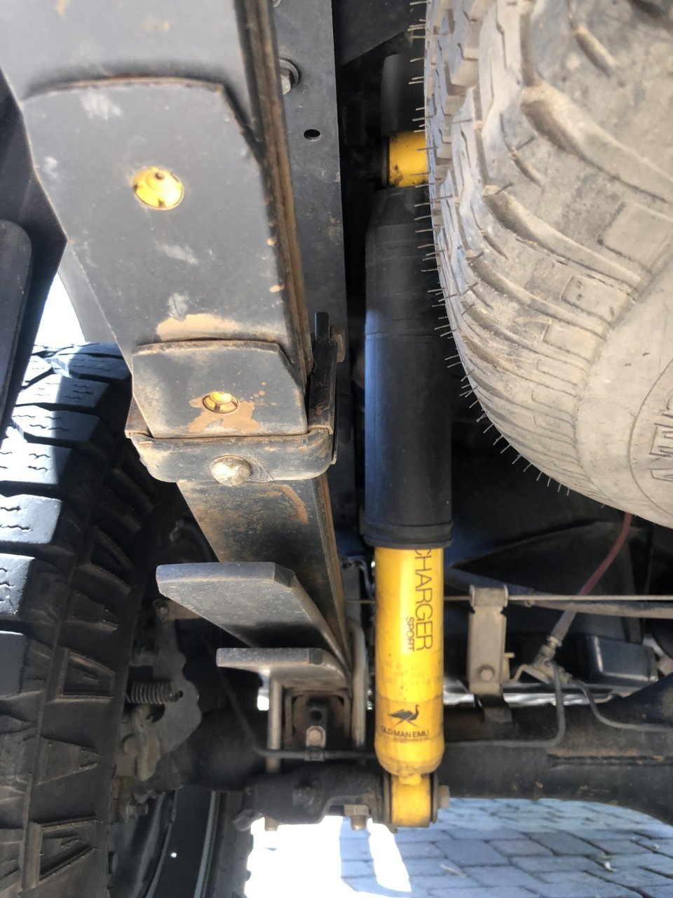

    And here is the back:

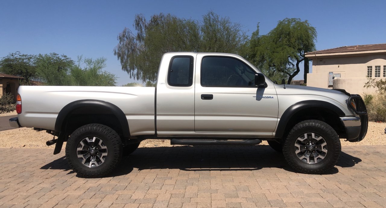

    And this is what it looks like. My goal is to be able to climb easily into the bed.

    Nice, even installed the extended brake line in the rear.
    The suspension looks a little old, and your cv axles look to have minimal angle.
    I bet you're not even at the full 2" over stock height any more.

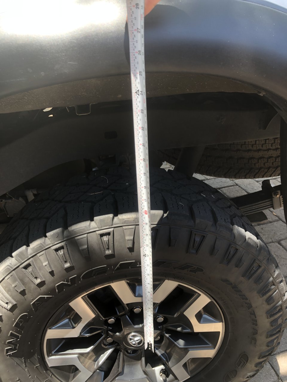

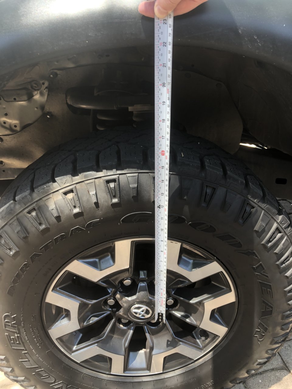

    Picture from the side of the truck?
    Height in inches from the center of your wheel to the bottom of your fender?
  15. Jul 27, 2021 at 11:50 AM
    Kwikvette
    Feb 27, 2019
    #284735
    79,756
    Fresno County
    4 run, 2 don't
    That's a step, not a slider.
    Will definitely not protect against any rocks.
    Looks to have 1.5" of lift give or take.
    I think it looks great.

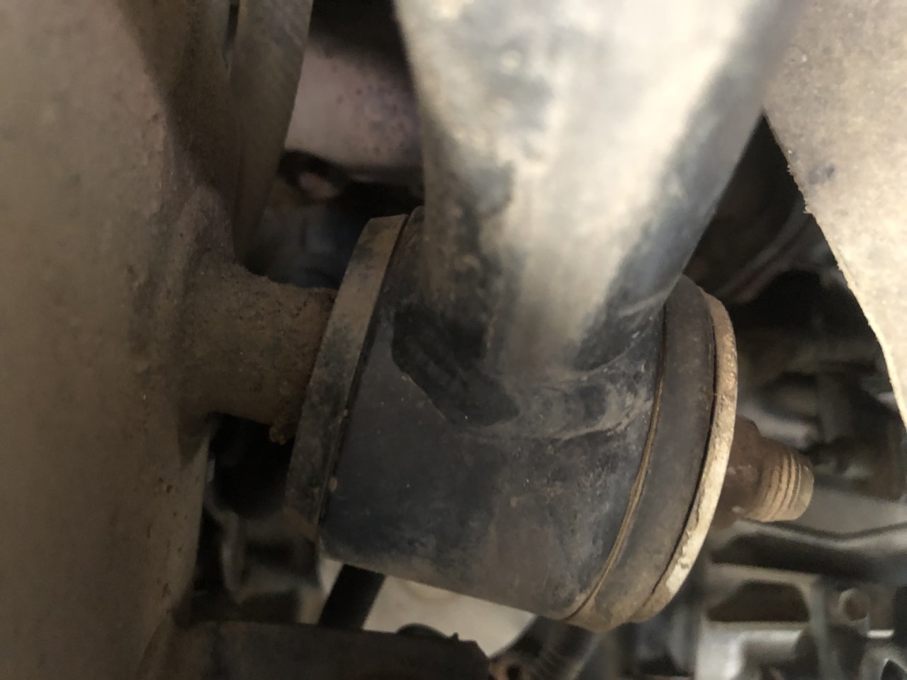

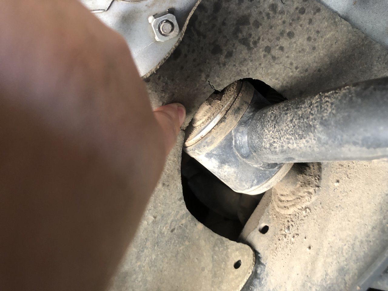

    1. Toytec/Eibach 3 inch lift 2. Line-X truck bed 3. Line-X Fenders 4. Premium sound system 5. ARE Topper
    Ya- I'd leave it like that. It looks great!

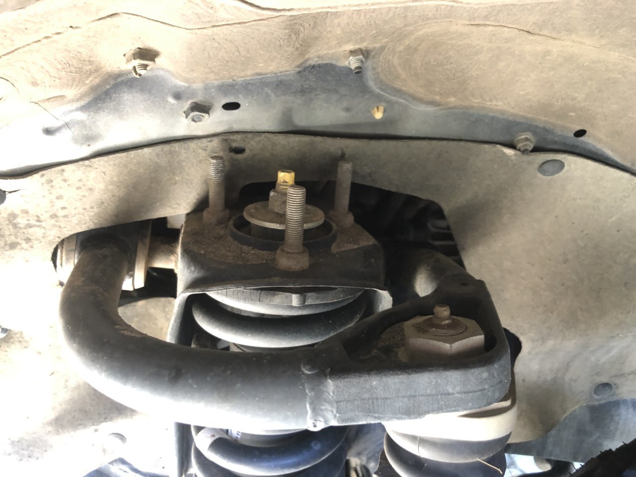

    On another note- Can you take a picture of your driver side SPC Upper Control Arms. I have the same ones and mine seem a bit different where the bushings and screws are. It is where they are bolted at the top. Both sides left and right driver side if you could! TIA

    Front is 22", rear 25". Wheel diameter is 30".

    Not sure if these help; I can retake them.
