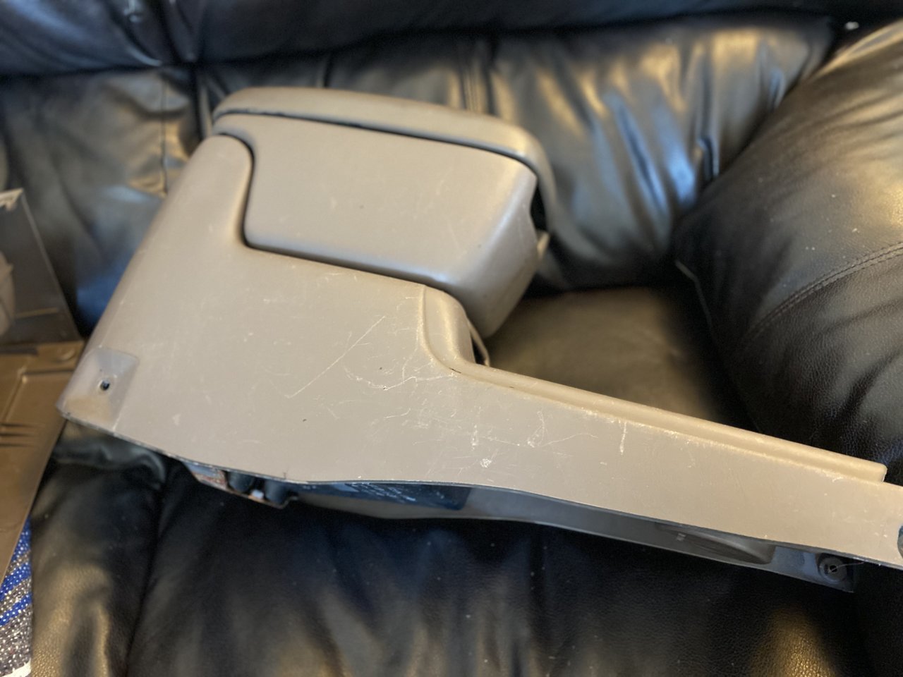

    My center console has a ton of scratches and was curious if there’s a way to restore it. I’d assume sanding it all down and repainting is an option. But is there any other way besides painting?

    Heat/Hot Air Gun. It melts the plastic and leaves it looking brand new. I used it on the shift console trim that was all scratched and tarnished, and after a few minutes with the heat gun it was all gone and blended.

    Yes I second this. Go slow though and don't overdo it. You can melt or warp it pretty quickly.

    I’ve done this but for me it left the area with a high gloss finish where I used the heat gun.

    Keep the heat gun moving in a 4"x4" area about 4-5 inches away on low. If an area gets too hot it will get glossy and there's no going back after that. Once an area gets hot enough to start seeing small scratches disapear, let it sit and slowly cool. The area will keep its heat for a while and the heat will keep working on the scratches. Repeat this several times until you get the results you want. This worked best for me. The heat gun will not take out deep scratches, it would get way to hot to melt those out and the plastic would melt and warp. Just light scuff marks.
