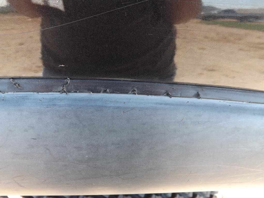

    Well I tried the power sprayer and it worked ok. Got the plasti dip off the back ones. Took a while though and wasn't perfect. I got too close to the little rubber strip that seals the top of the fender flare to the bed, and kinda melted a few etch marks into it. Not too bad though. But it is noticeable. Might see if I can get new ones for the back at least. Does anyone know if these strips are available to purchase? Like from the dealer? They seem to be glued on the lip so Idk what I'd use for that. Any suggestions on an easy method? Or maybe sand those spots down? Not sure what to do since its a hard rubber. The spots are very little and like 4 or 5 little etches on each side. Again barely noticeable but, looks tacky. I'm bummed... I shoulda just went ahead and used goo gone to begin with. I tested a spot and it dried pretty quickly and faded away, and looked clean. So I think I'll try that on the fronts and just wait a week for the oils to completely dissipate. The flares are kinda dirty and stained a little bit anyways so the goo gone should help them get really clean before I heat em up.

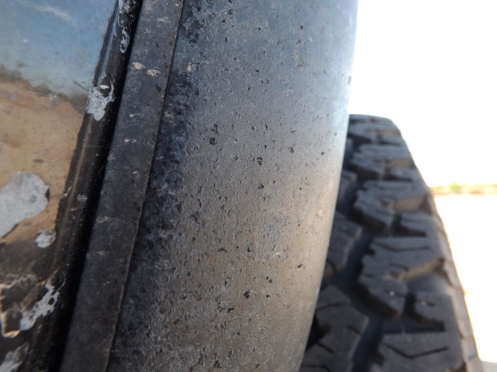

    Another thing to note, is on the bottom front of the back fender flares, they are all etched up with little scratches all over from all the rocks hitting it from the front tires as mine stick out pretty good. Again I live on a dirt road so it's been pelted pretty good. I need to figure out what to do as far as mud flaps or something, but not too worried about it right now. The paint looks like it was sandblasted. Ha. Oh well. Getting a new paint job eventually anyways. Anyhow, would there be a way to smooth out those scratches from the rocks in the plastic? I would say fine grit sandpaper, but I've never worked with plastic before.. and I don't want it to be all scuffed up from the sand paper in just one spot of the flare either since I'm not coating/painting them therefore it won't be hidden. I was thinking that after I heat them up it probly won't even be noticeable anyways. I am not too worried about it because they kinda act as my mud flaps so to speak anyways so I'm not too worried about them being pelted with rocks. Unless there's an easy method to smooth it out and have it blend in with the rest. If not hen I'll just leave it as is. I'll take some pics tomorrow of them..

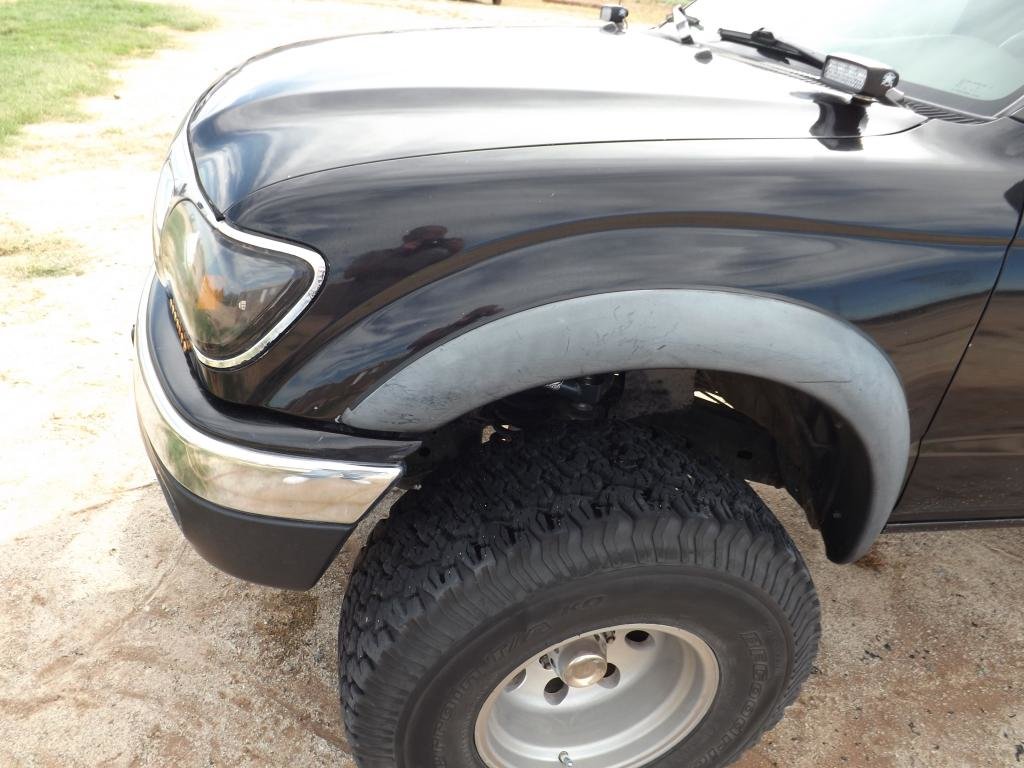

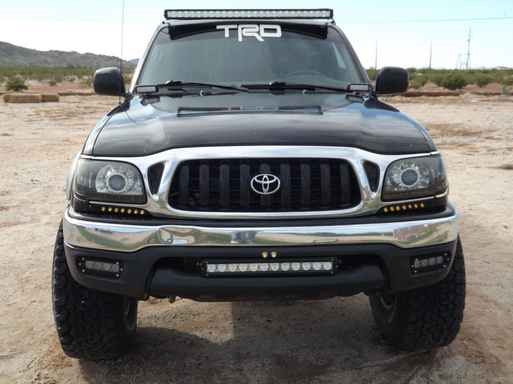

    Finally got around to working on this a little more!

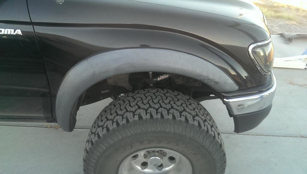

    Here's a daytime shot of the completed front bumper. Still lookin sharp!!:cool: I hope this lasts!!

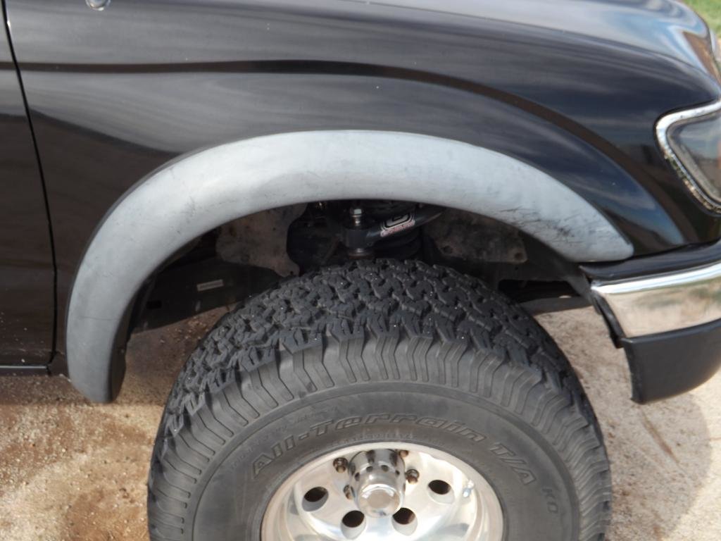

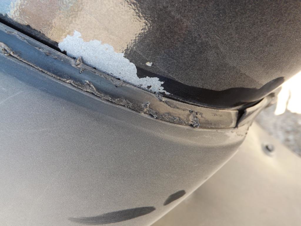

    And here's those spots I 'melted' with the power sprayer...
    Not too bad I guess. As you can see it also stripped off a good chunk of paint there too. And the next pictures show the rocker panels in front of the back tires a lil. It's just been getting pelted for 3 years. It will be getting painted sooner than I had hoped. I will need to figure out what to do for mud flaps first. Then all that will be left for exterior is painting, and touching up anything else like trim pieces, wheel well stuff, and it'll all be lookin perty sharp and restored! :)
    I also went ahead and bought the goo gone and used it today too. Didnt dissolve as good as I thought it would or how they show it on vids.. It also speckled that dissolved plasti dip all over the side of the truck so I had to buff the entire thing by hand with a wet rag to get off alllllll the little specks it left. Guess I shoulda taken the flares off. And it did seem to make the back ones a little darker seeing as I went over those with goo gone even though the plasti dip was gone. Just to get it off the edges and the rubber trim pieces, and to clean it. But it looks like its fading back away pretty quickly so it should be ready for the heat gun treatment next week.

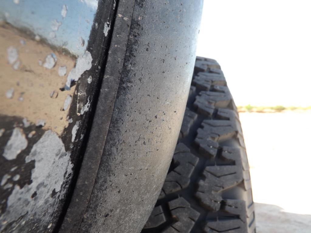

    Oh and here's the back fender flares. What I was talking about regarding all the rock chips/scratches. Think I'm just gonna leave it and heat it. Shouldn't be noticeable after that. I dont think there'll be an easy way to make it smooth again.
    And last but not least, here's the front flares after I dissolved and sprayed off the plasti dip with goo gone. As you can see it looks pretty 'normal' as far as how it looked before the plasti dip and the goo gone hasn't really absorbed into the plastic. But ima wait till next week just to be safe.

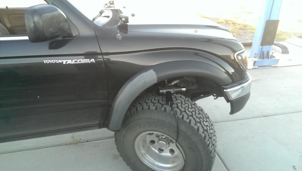

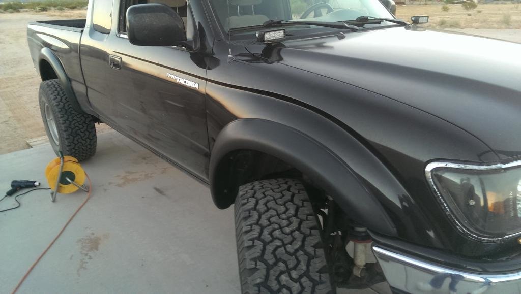

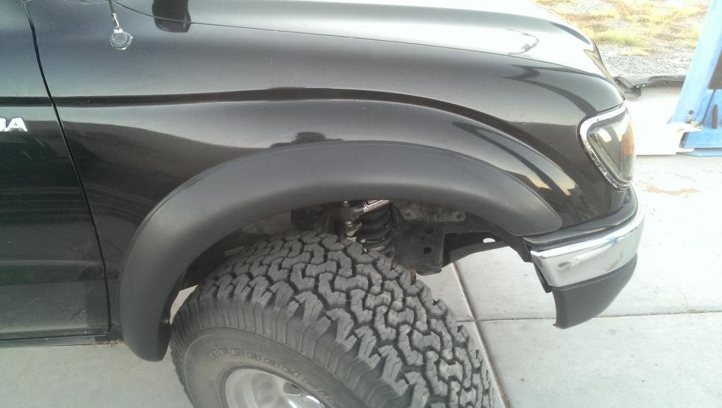

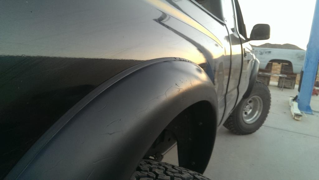

    Welp, got the fender flares all done! Took me about 2.5 hrs, but was taking my time. And I went over them twice really good. Even got a bit of glare/reflection coming off them now as they came out a little bit shiny:D
    Only thing I might add if you do this, is be careful when you are heating close to that tiny rubber trim piece on top of the flares. It started to deform and melt in a few spots on me. Had to go quick in that area, but it heated up really quick anyways because thats the thinnest spot on the flares. So be careful!
