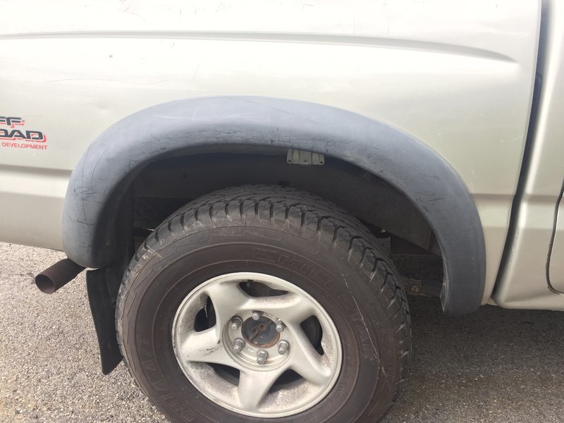

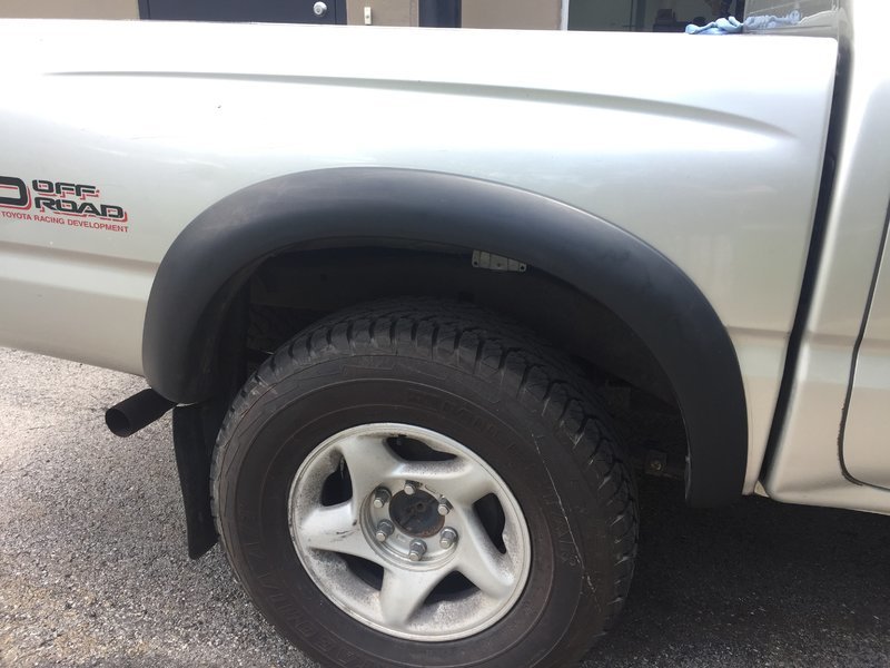

    I shot some clear coat on it to prevent UV fading but couldn't stand it. Splotchy and too shiny. Should've just done it right in the first place.
    So I sanded it down and sprayed 4 coats of Rustoleum Universal satin black. It lasted 7 years on my last truck and was still going strong when I sold it.
    That's more like it.
    Conclusion: the heat gun is ok but very temporary. Better to just paint it.
