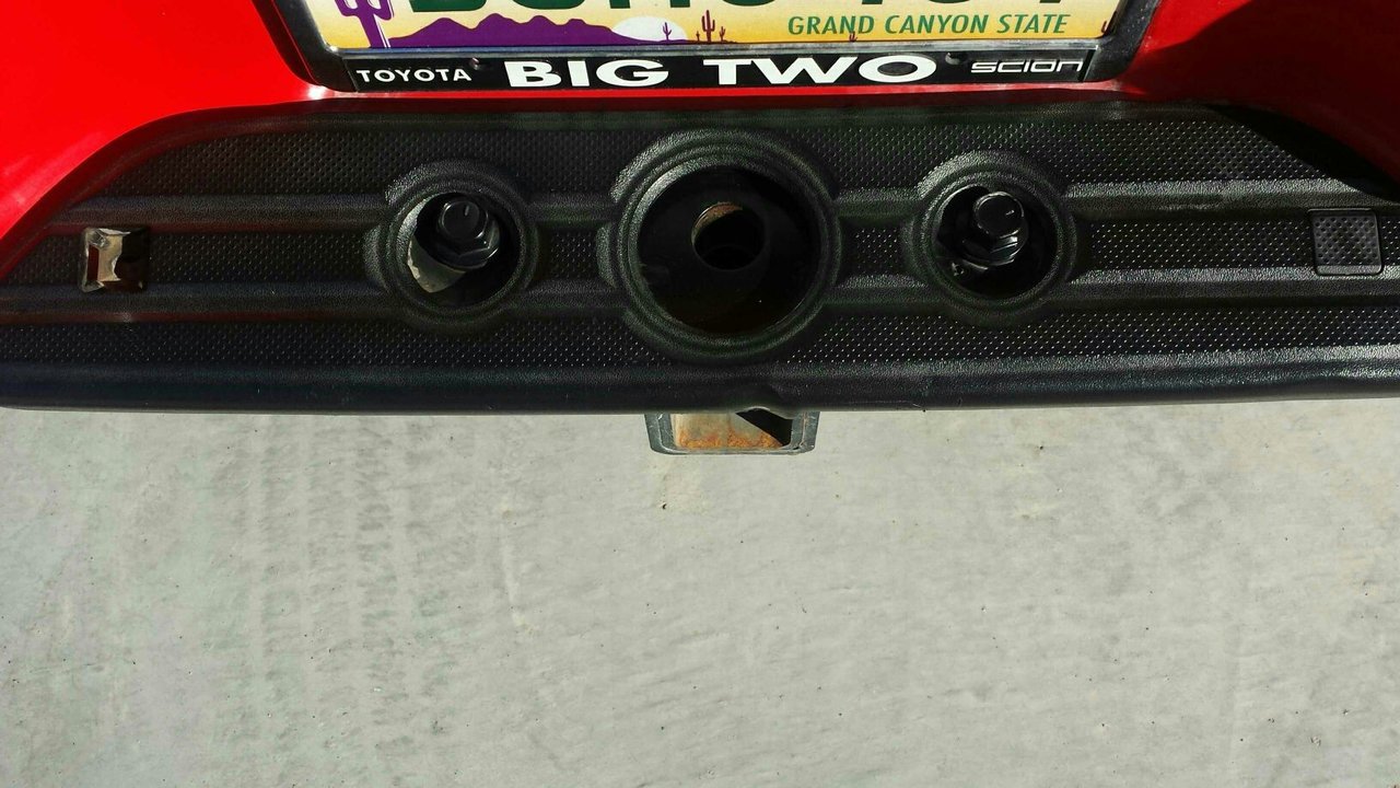

    So my plastics where trashed! But look what 303 did to them! All I can say is wow. How long do you think this will last though? uploadfromtaptalk1446825015470.jpgee0bc268adc3bc021ddfa7594a24612b_50919731caf901578eb554bc1965af66bedfa064.jpg

    303 along with all other products just mask the problem and give it some SPF on top to reduce the fading more. They have products that are supposed to "dye" the plastics, but nothing really works.
    The problem with 303 and others is once it rains, the product likes to run, so based on weather conditions, car washes, etc., you apply it when needed/wanted. It's a great product, but you will need to apply every wash if cleaning your truck thoroughly. If it rains, just look for any running and you normally can buff out.
