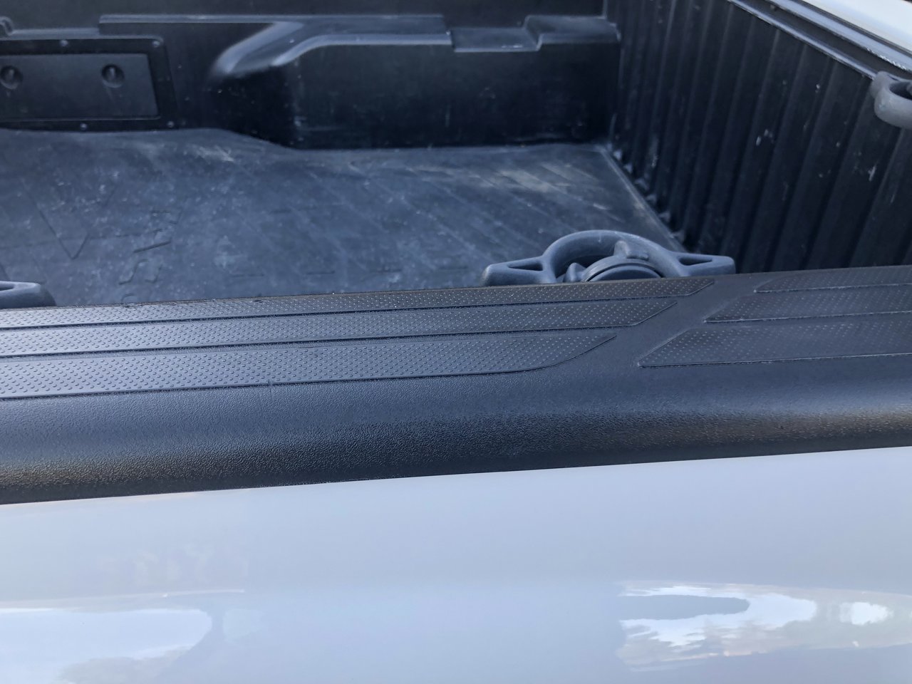

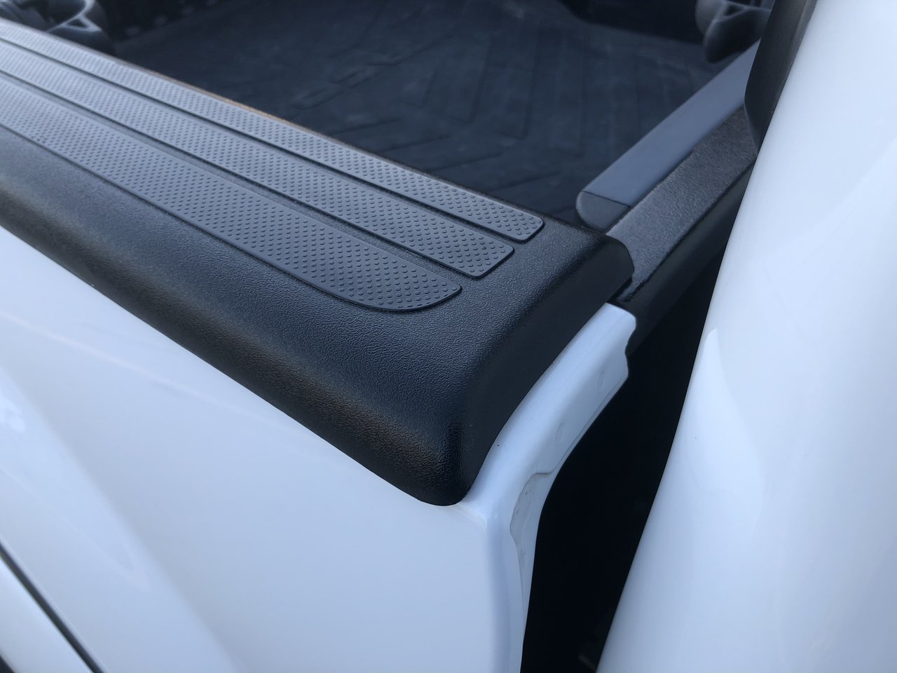

    Here is some pics I took tonight after putting some 303 on my bed covers
    4A9B2C9B-EAB7-4CE1-BB22-9D3F02250A00.jpg E2FB9ECD-4451-411C-9912-CF0848716CC9.jpg
    350BED0C-33AE-40FD-BAF2-760231818B59.jpg CBB891A6-8AAC-4F40-B88F-9CC9C6012A8A.jpg
    Not perfect but i did one quick coat while I was touching up my door seals.

    I don't think you'll find anyone here who doubts that 303 Aerospace Protectant makes black textured trim look better after an application - as it did in your pics. Personally, I like the product and use it on the seats / upholstery on my boat on a regular basis - for protection from the sun's UV rays.
    Where I think you will find some push back is on how long the product lasts. My experience is that the next good rain storm or car wash will pretty much totally remove it. Please note that 303 is not alone in the category of "looks good for a while." Black Wow, Peanut Butter and Vaseline also fall into that category. What I think many people are really looking for is something that "looks good for a long time." But getting back to 303, I would suggest that if you start using it before the plastic has oxidized, it should prevent or slow down oxidation over the long haul better than many other products.
    And getting back to the OP's question, 303 does nothing to remove wax / polish residue trapped in textured plastic - as one of your photos shows.
