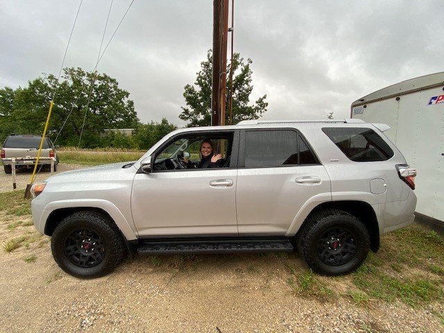

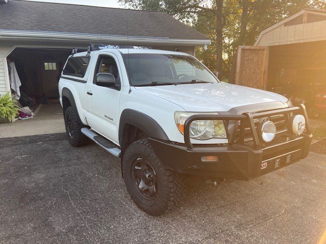

    oh, and here is his and hers, just for kicks :) 4Runner.jpg Taco.jpg
