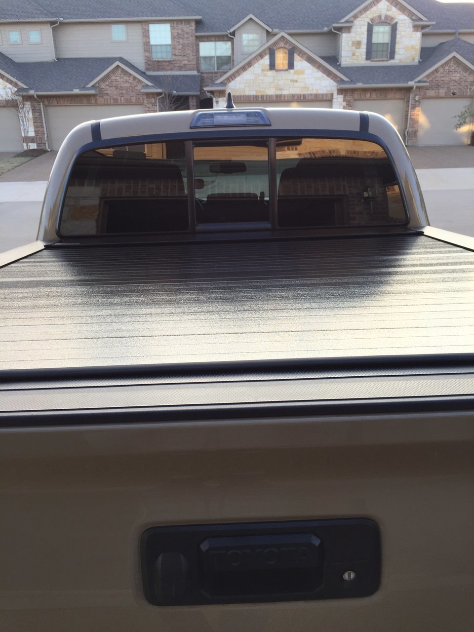

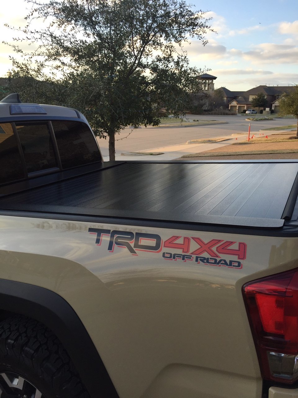

    I loved my Pace Edwards electric retractable cover and here is a pic with my old 2016 for comparison.

    Thanks for the comparison. From what I can tell, the gap on mine is much bigger than what I see on the Pace.

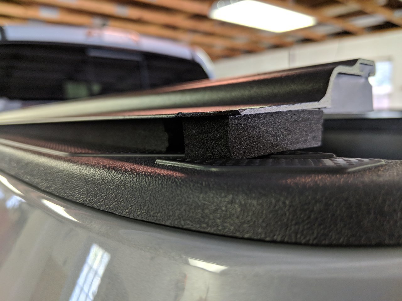

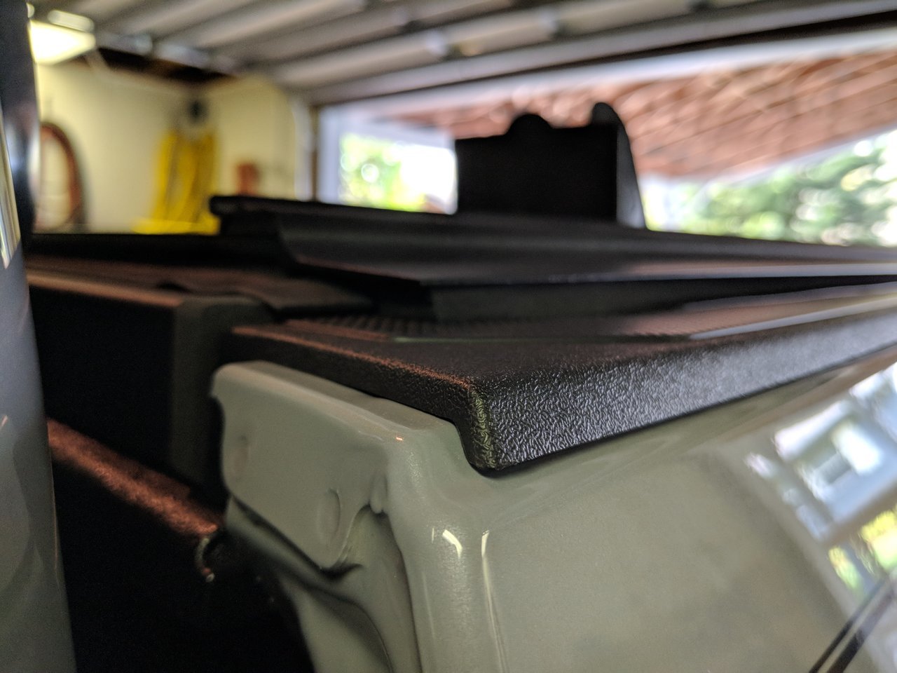

    I took a couple of pics this morning, see what you think...

    I have the Gatortrax MX which is the same thing as the Retrax MX and mine definitely does not look like that! Mine does sits about a 1/4" higher towards the front vs rear on both sides but nothing like yours.. not even close. I would take it back and have them reinstall it. Sorry OP :(

    to me it looks like you need to scoot up the cover a little closer to the cab. I had that weather strip right to the edge. Yours looks like 5mm short of it.
    also the rear it looks like it pointing upward vs the front.
    check this install vid at 7:25 you can see he puts a knee on it before tightening. that's what you need to do
