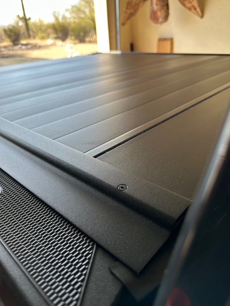

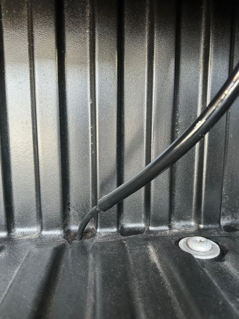

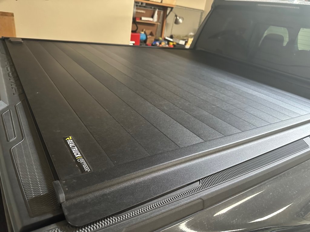

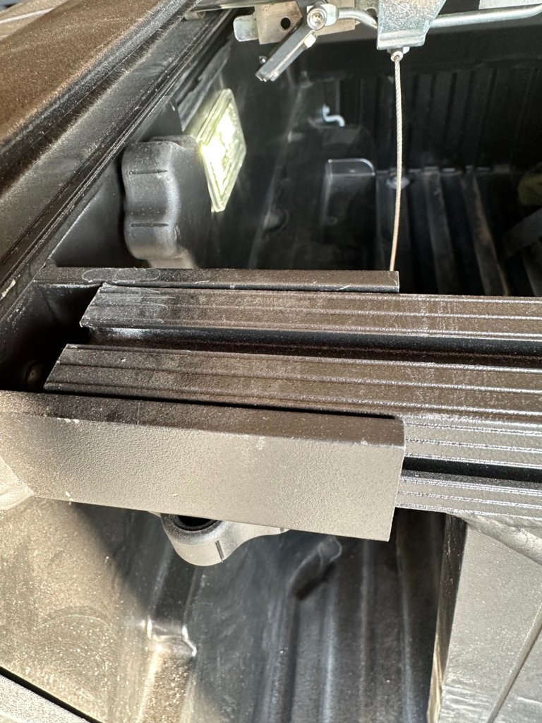

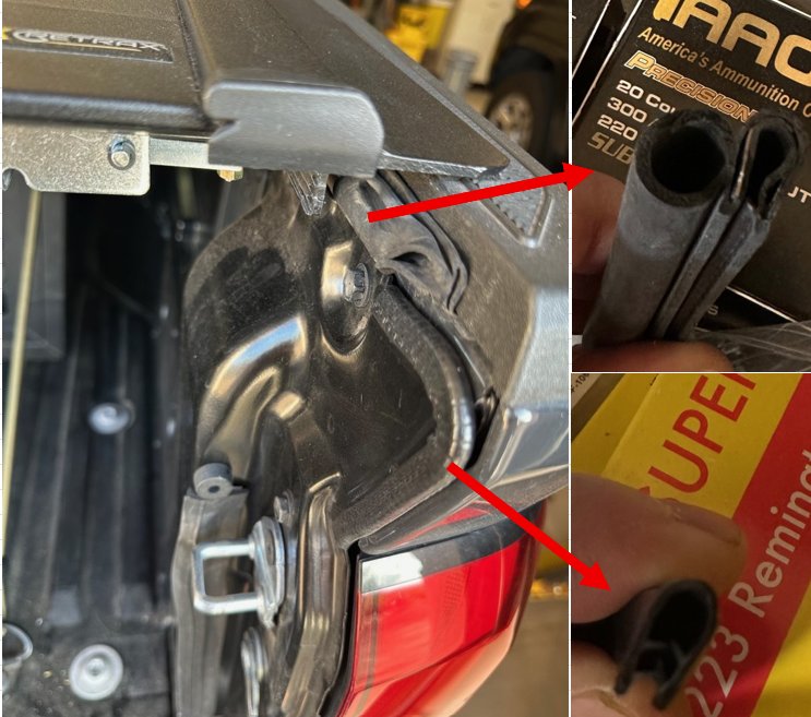

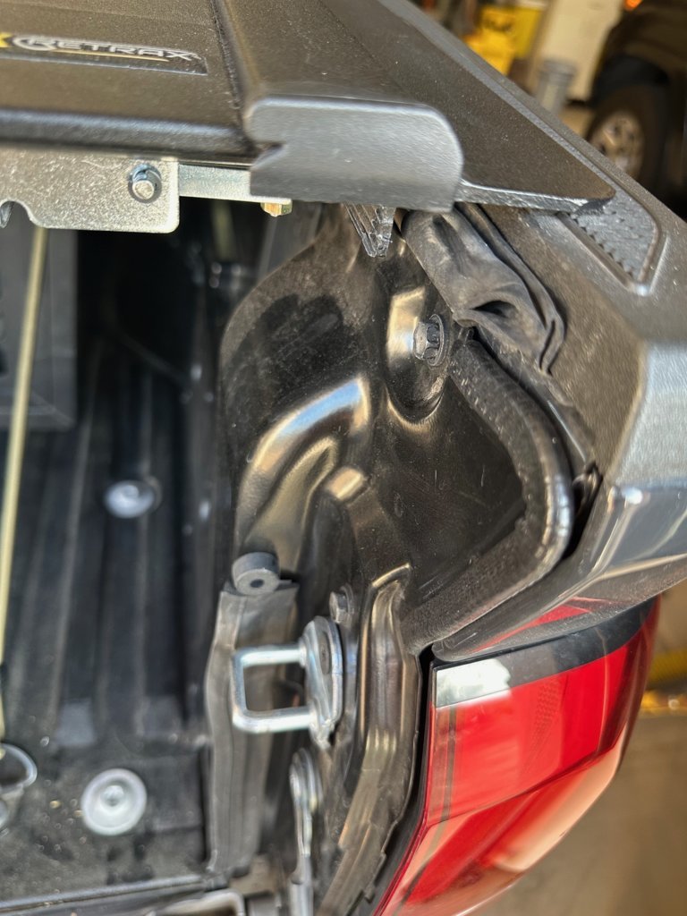

    No pics of install as there are several posts and videos available. Install on a 2025 is very straightforward. I like that the drain tubes now has a reducer to fit through the factory drain hole so you don't have to drill it out.
    I didn't like that you have to use a key to lock/unlock the cover. I have a key card, I don't carry keys. Keeping the key in the console and getting it out would have been inconvenient. Retrax makes an electric retractable model but then I'd have a fob to carry.

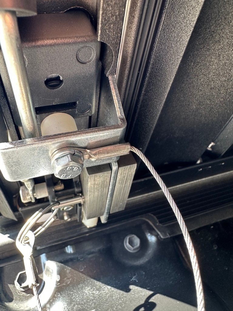

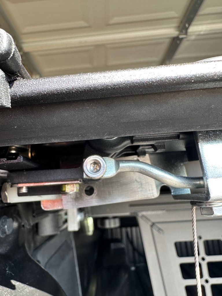

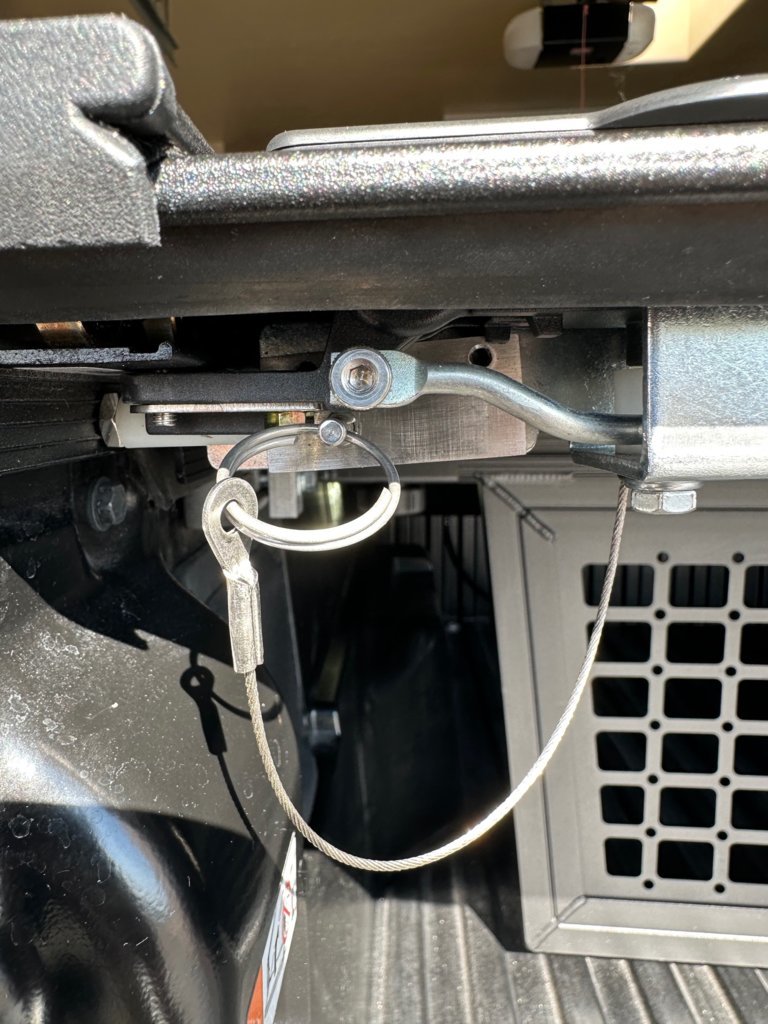

    I ended up reinforcing the latch bracket and drilling it for a ball detent pin. The pin blocks the locking arm so you can't lift the latch. Now I lower the gate, pull the pin, lift the latch, and slide the tonneau. I can't unlock/slide the tonneau without opening the tailgate first but the new Tacoma with the higher/deeper bed and especially the taller Pro, makes loading over the side awkward anyway.

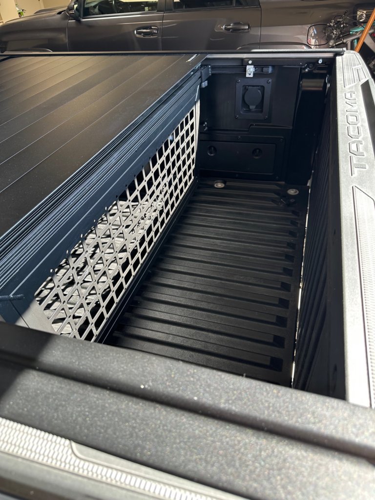

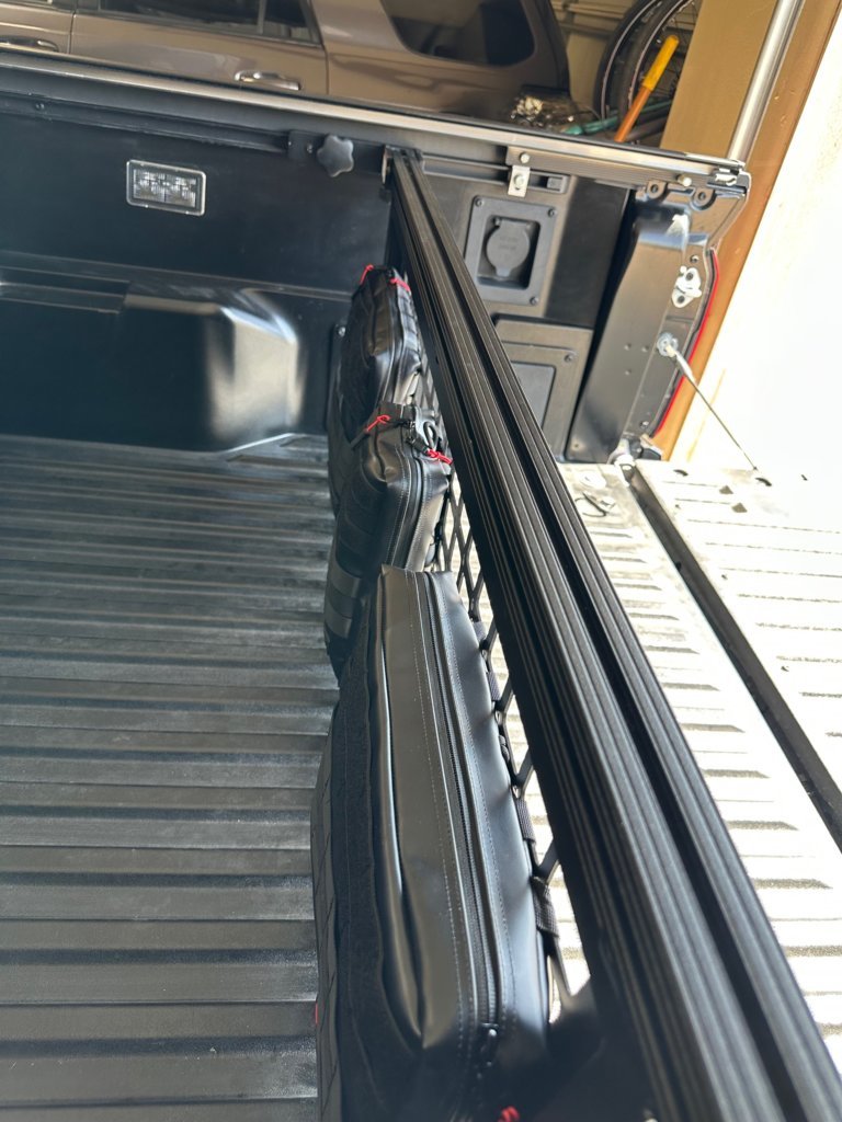

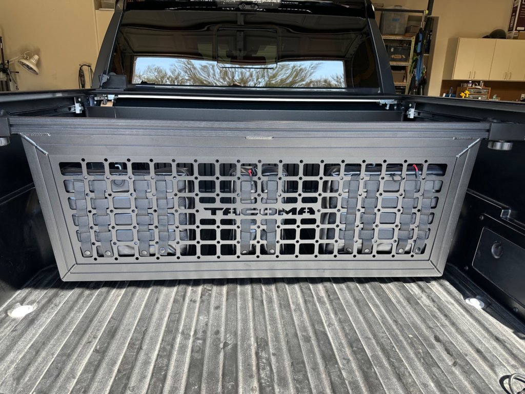

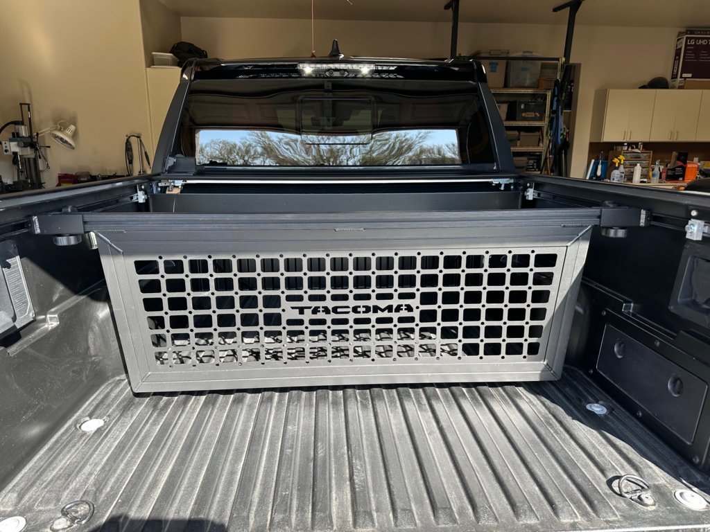

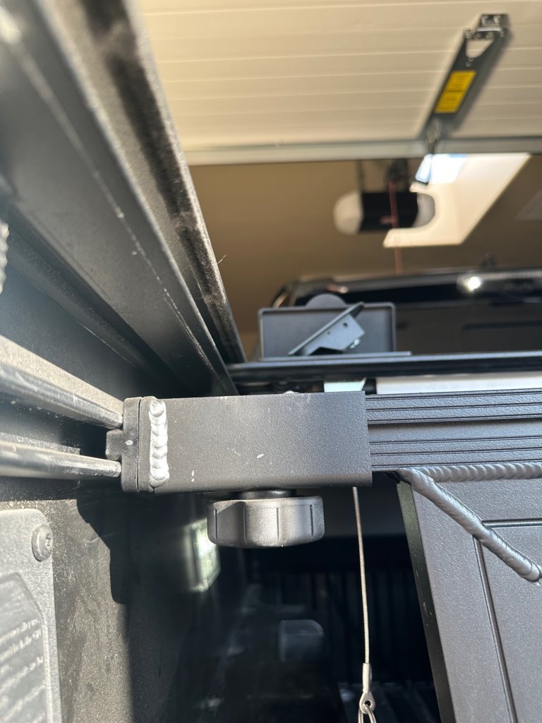

    I wanted to get some side molle to store stuff, but the tonneau cannister is too close to the sides. I ended up getting the Toyota bed divider instead and I am happy with that. It allows me to load gear/packages near the tailgate and keep it in place. It slides back and forth allowing me to keep things where I want it. With the Retrax I did have to trim 1/4" off of each side to be able to easily remove it. You don't have to cut it to make it removable but you would have to loosen the rail T-slot brackets to get clearance.

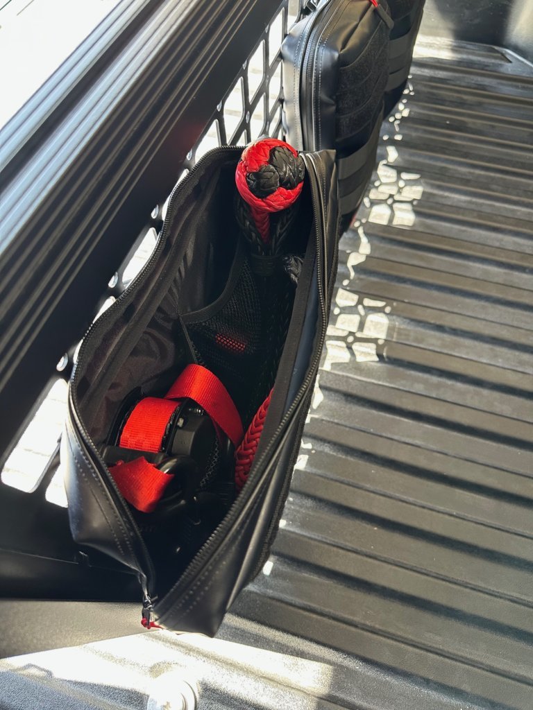

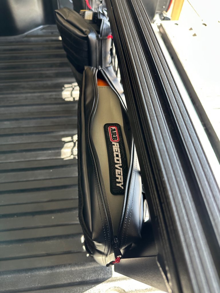

    I added molle pouches so now I can fit my recovery strap, ratchet straps, soft shackles, a 120v air pump, and some other stuff. The perfect solution for not having under seat storage room.

    looks good.....but now do you have a 4 foot bed?

    It's still 5' at the bottom...There's obviously a trade-off between security, looks, ease of use, and lost storage capacity. It gets me and my rescue gear up the mountain, carries my range gear securely, and fits my Home Depot project loads with no problems. If I need more room I borrow my buddy's trailer. I only did that about once a year with my previous access cab and 6' bed (that also lost a foot from the tonneau cover).
