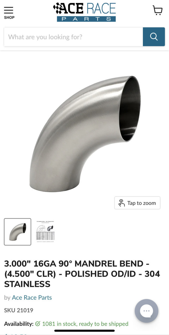

    Using that BTF build as inspiration. I’m updating the shape of the front bumper from the BTF tribute by adding a few more bends that wrap around the front styled like the original smittybilt. Also building a real rear bar that mounts to the bed similar to the original. The BTF one clipped into the rails.
    Smittybilt used 3” thin wall tube on the original bumpers with a 4.5” bend radius.
    I considered pipe, but Using SCH 40 pipe with a similar OD would make these insanely heavy.
    Looks like those heavy metal rails are 1.75” OD tube with .12 wall. those do look a little small. I’m not a huge fan of using pipe for welded structure. You can get equal if not better rigidity using larger OD thin wall tube vs smaller OD thick wall pipe, depending on the structure design.
    I’m planning on using these ACE RACE pre-bent 3” tube elbows and straight tubes on mine and doing a multiple pc welded structure vs a single bent tube.

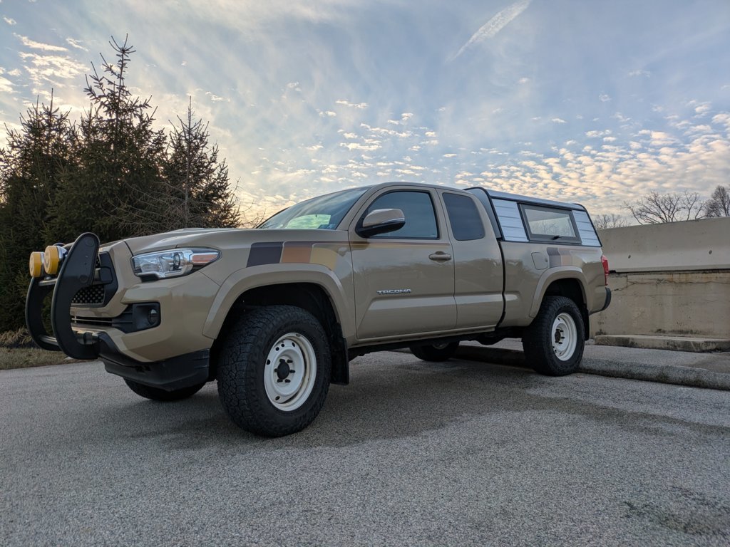

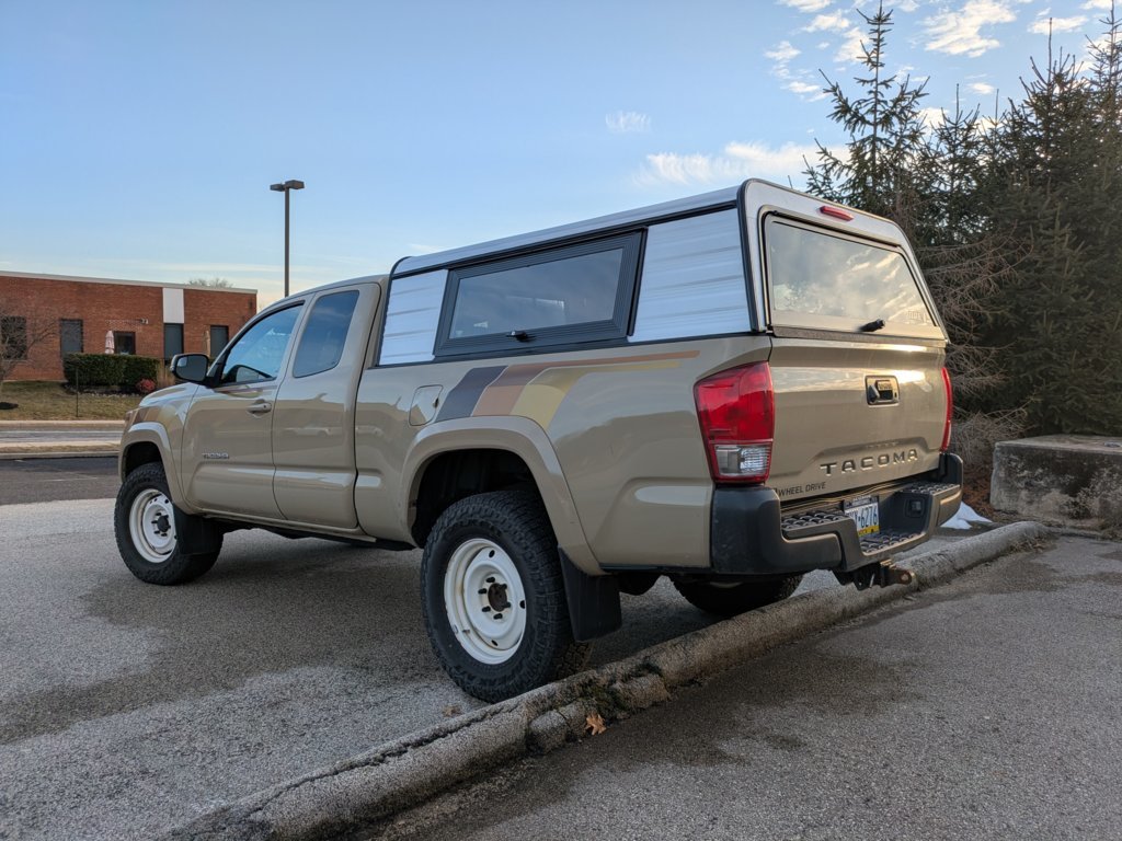

    Wow, I'm happy to see I'm not the only one with the love of old Toyota Pickups. Here's mine that I've been working on for a few years now.
    Started as a stock TRD Sport and loved the Sandstorm color on both new and classic trucks.
    -Reproduction graphics that are slowly starting to UV fade, adding to the vintage look.
    -Steel wheels are OEM TRD Sport spares. Some engineer at Toyota just for the TRD Sport designed a 17" spare to look like the factory steelies on 60's Toyota Pickups. $70/ea at the dealer and some white powder coat and the TPMS sensors even bolted in. (then sold the OEM aluminum wheels for more than the above combination, including swapping the tires over)
    -Push bar is from a 90's 4Runner I pulled from a junk yard. $50 later and I bent and fabbed the attachment points so it bolts to the factory bumper bar.
    -KC Daylighters I put some lower power LEDs inside and triggered them from the parking lights. So they glow at nigh but aren't bright enough to melt holes in the covers. (I melted a pair on a previous Tacoma after I bumped the power switch)
    -The white cap is the same ARE aluminum cap they've been making for 50 years.
    A 1" lift and the 4 WHEEL DRIVE decal on the tailgate round it out.
