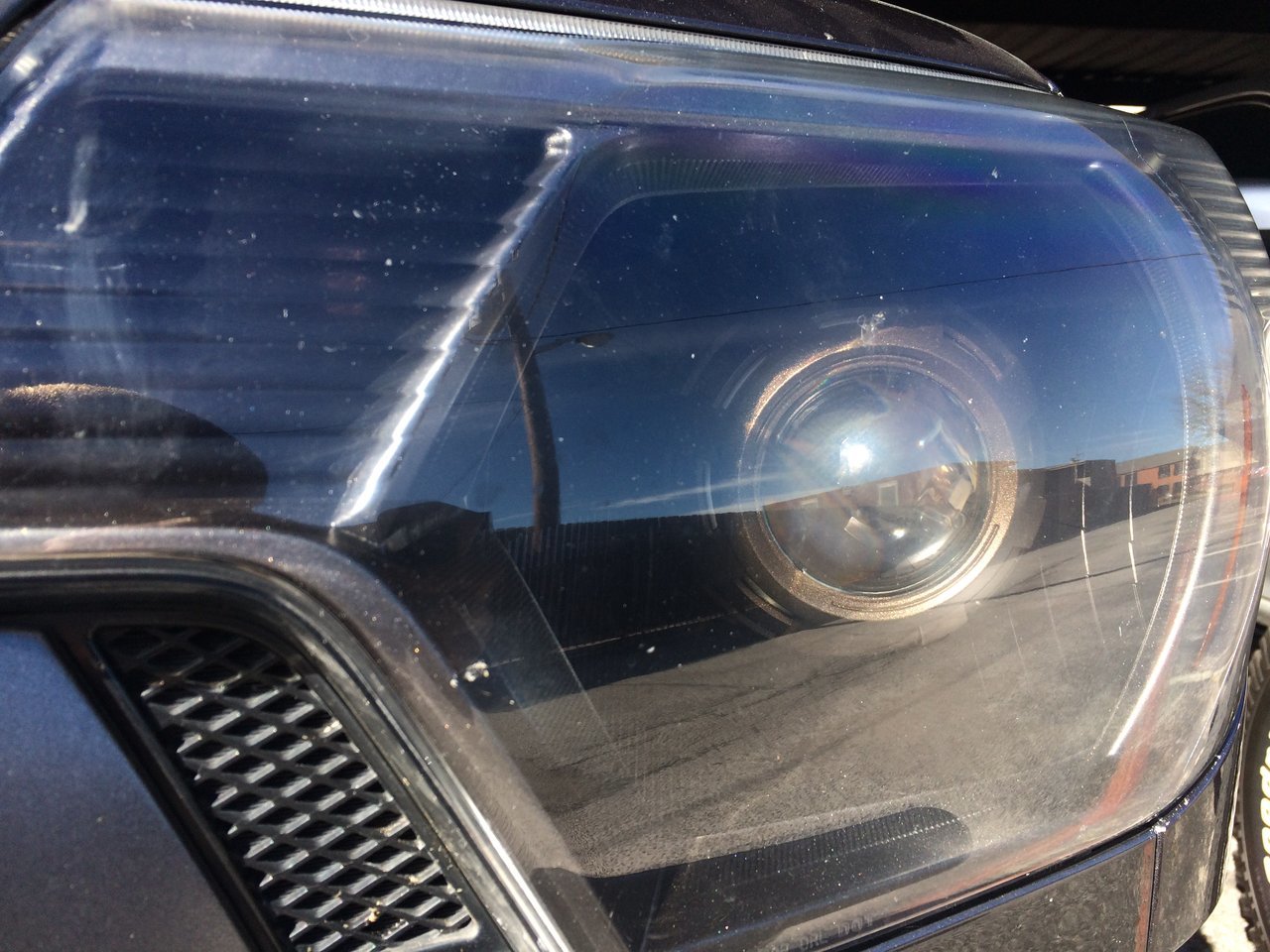

    I got a kit from retrofit source and did it myself with a help of a friend

    Does the kit include the projectors or did you paint the original ones you had? Those look fantastic.

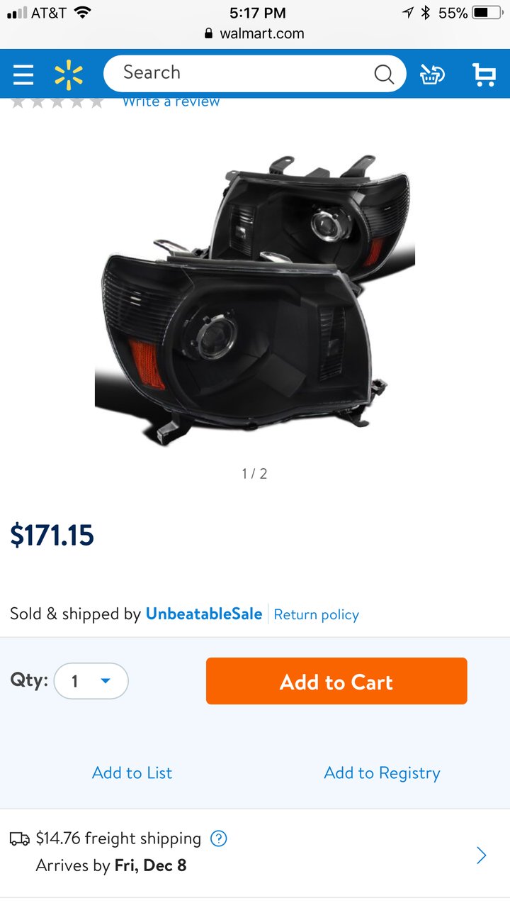

    You do know that you can get those off Walmart.com now for like 160 or 170 right? Depending the website you use

    Jesus christ :facepalm:no, just no

    Comes with everything u need, I painted the inside myself

    Damn bro. Walmart!!

    Hey it beats the hell out of $800 plus lol. I would rather do it myself tho once you have done it once it’s not as bad after that.

    Definitely do it yourself, I'm sure quality, light output, and life expectancy are not up to par on those walmart lights

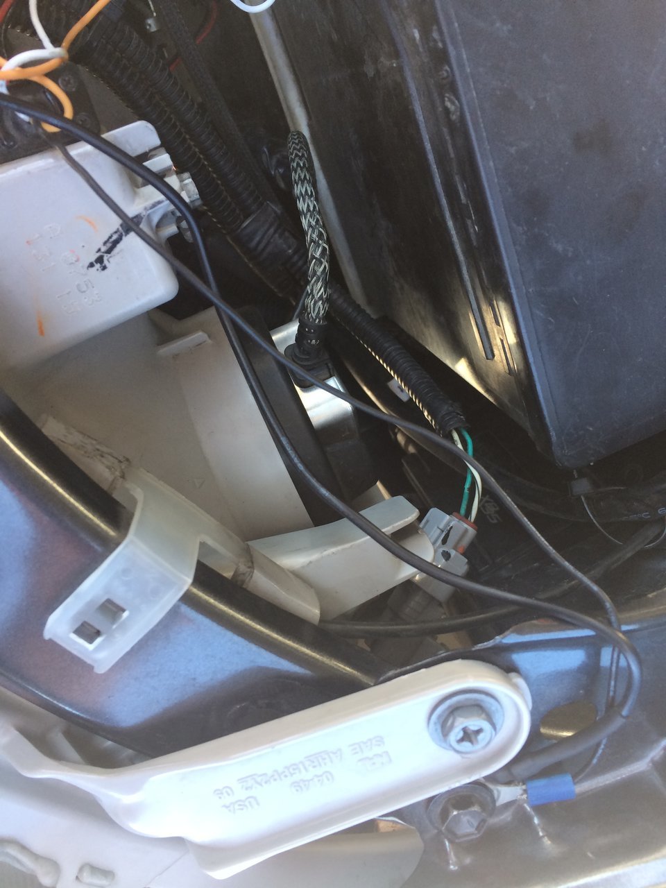

    Love the youtube vids :thumbsup: I just dropped a few in behind the chrome reflector of the headlight housing! With the bezel surround, you'll never see them, and if one day down the line the condensation were to come back for some reason just remove the headlight and wiggle it around so they fall towards the back of the light and you can either use your finger or some needle nose to pull them out. I was able to get it in and out with my fingers, you should have a enough space.

    Crappy pic but a reference none the less. Just pop that rubber boot back and slllide it in
