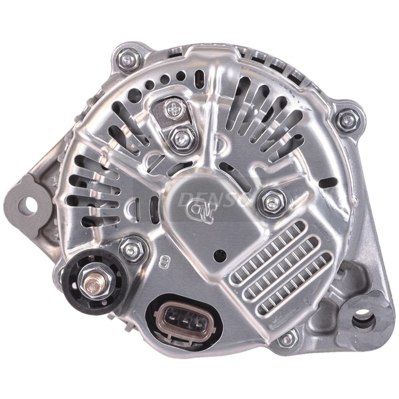

    This is my shot at retrofitting a higher amperage alternator into my 1st Gen 2003 Toyota Tacoma. I got a lot info from the forums here. I only went with this one becuase of the same connectors. Ironically it happens to be from a 2003 Jaguar Vanden Plas.
    This is a OEM DENSO 210-0421 Alternator

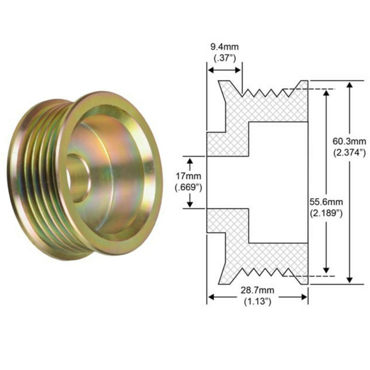

    The connector is the same , so no need to retrofit that section, but the pulleys are not the same so they have to be swapped from the OEM alternator or just buy a new one like I did with my setup. I got my pulley off fleabay for like $9 and total $12.50 shipped to my door. The alternator was a steal on Amazon for $120 from the amazon wharehouse returns 2nd chance purchase instead of the $250 price, LoL !

    it's the same alternator except his has the ROUND plug & mine has the oem toyota OVAL plug.

    The Jag alt was an upgrade for 1st gen 4Runners/3rd gen pickups back in the day. Thats why the round plug.

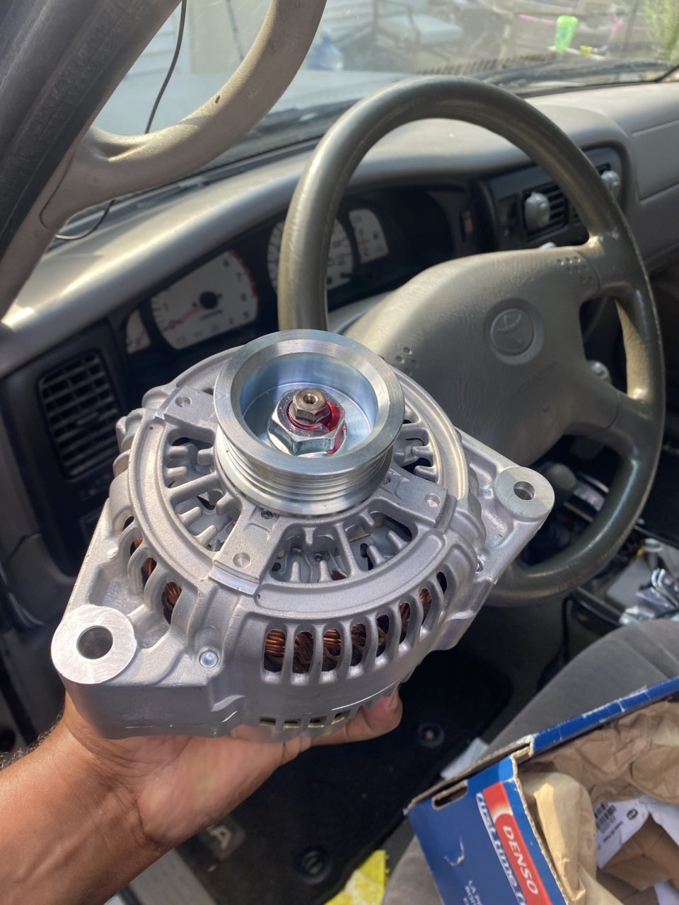

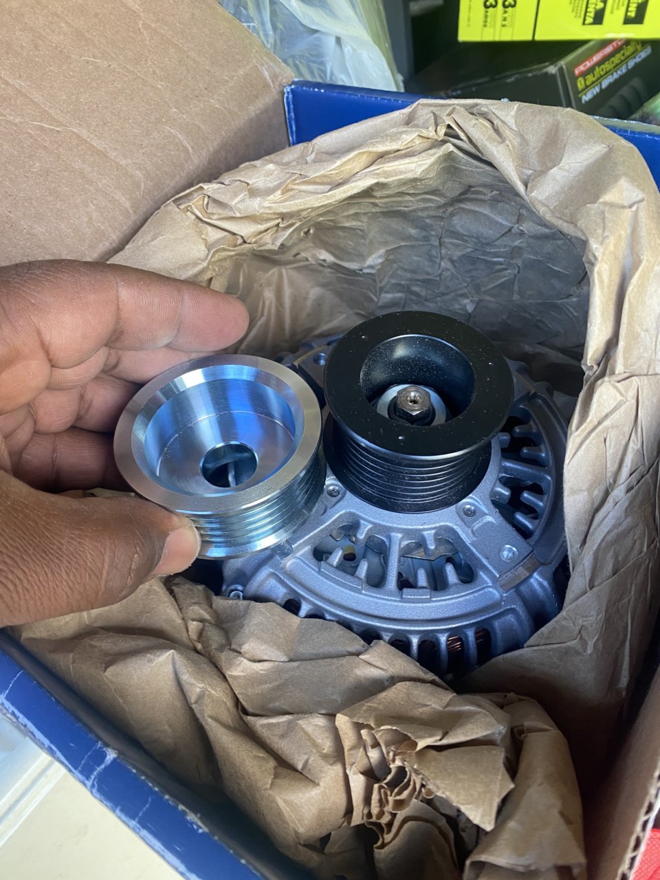

    I had my local mechanic swap the pulleys, but he just held it in place with one hand and then used a dewalt battery impact gun/drill on it, came right off ! 123

    Right before the install with a NEW Tacoma pulley. He put a dab of loctite thread lock on it and presto!

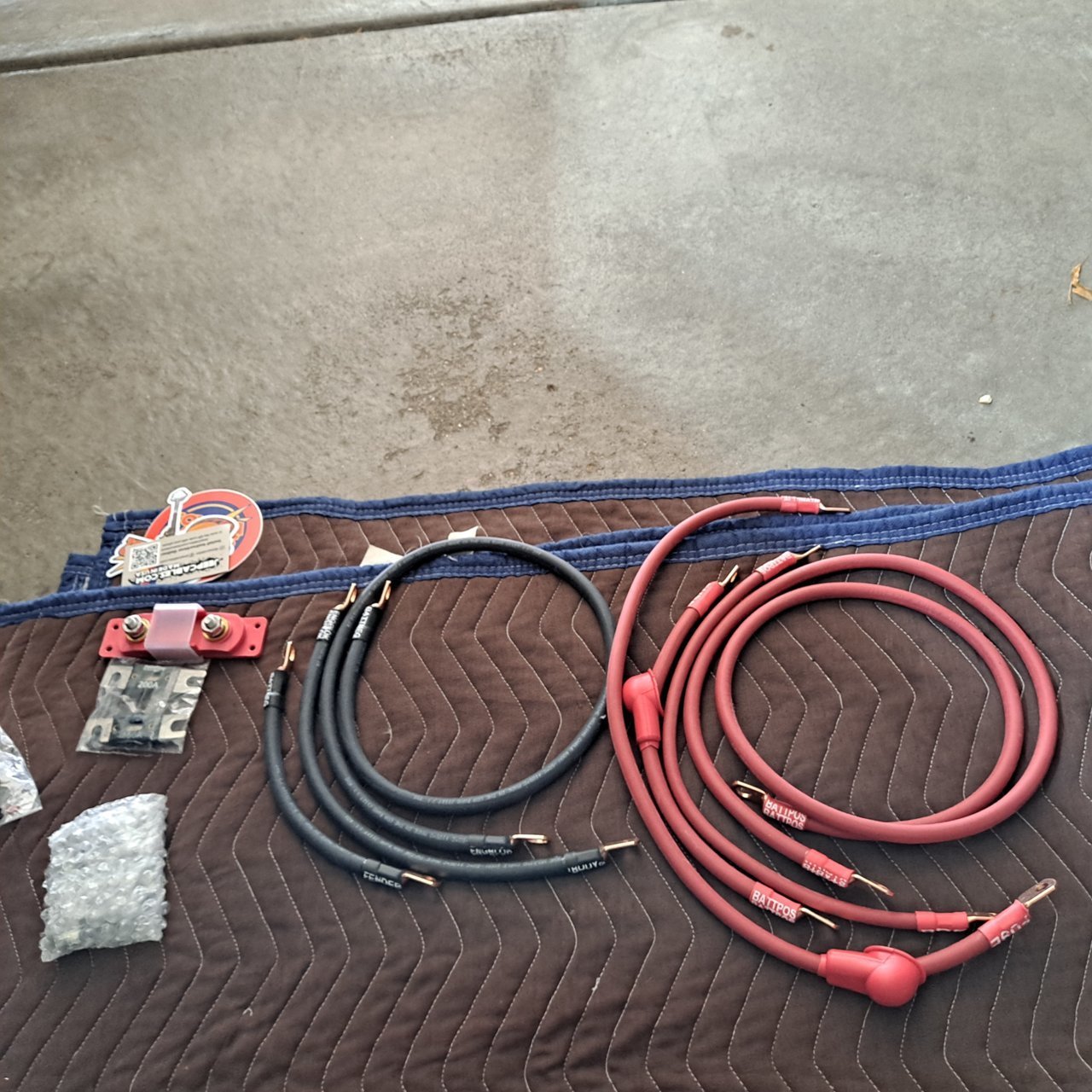

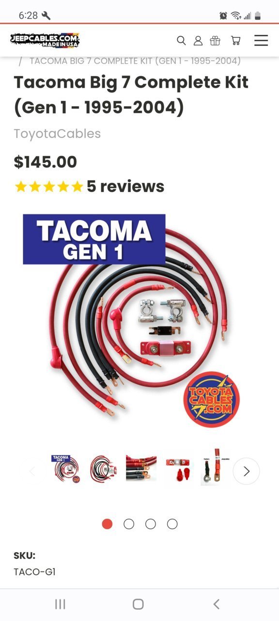

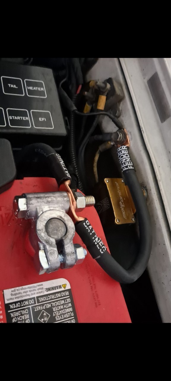

    BTW, thanks to your Amazon list I did it the right way by upgrading the fuse to 120 Amps and the upgraded 4 gauge wires as well, I also did the negative cable as well. Thanks!

    This is a great kit with 2 gauge FYI that I just bought AND two different rated fuses,
    Comes in 0 gauge also

    Damn I wish I would had seen this earlier. Nice kit ! Really heavy duty, I may go that route if I add any power hungry accessories.

    I've also had the grand vitara alternator in my 5vzfe for years, can't remember what the amperage is but it was higher than stock. I also wish I saw a kit for beefed up wiring like posted above, I made my own.
