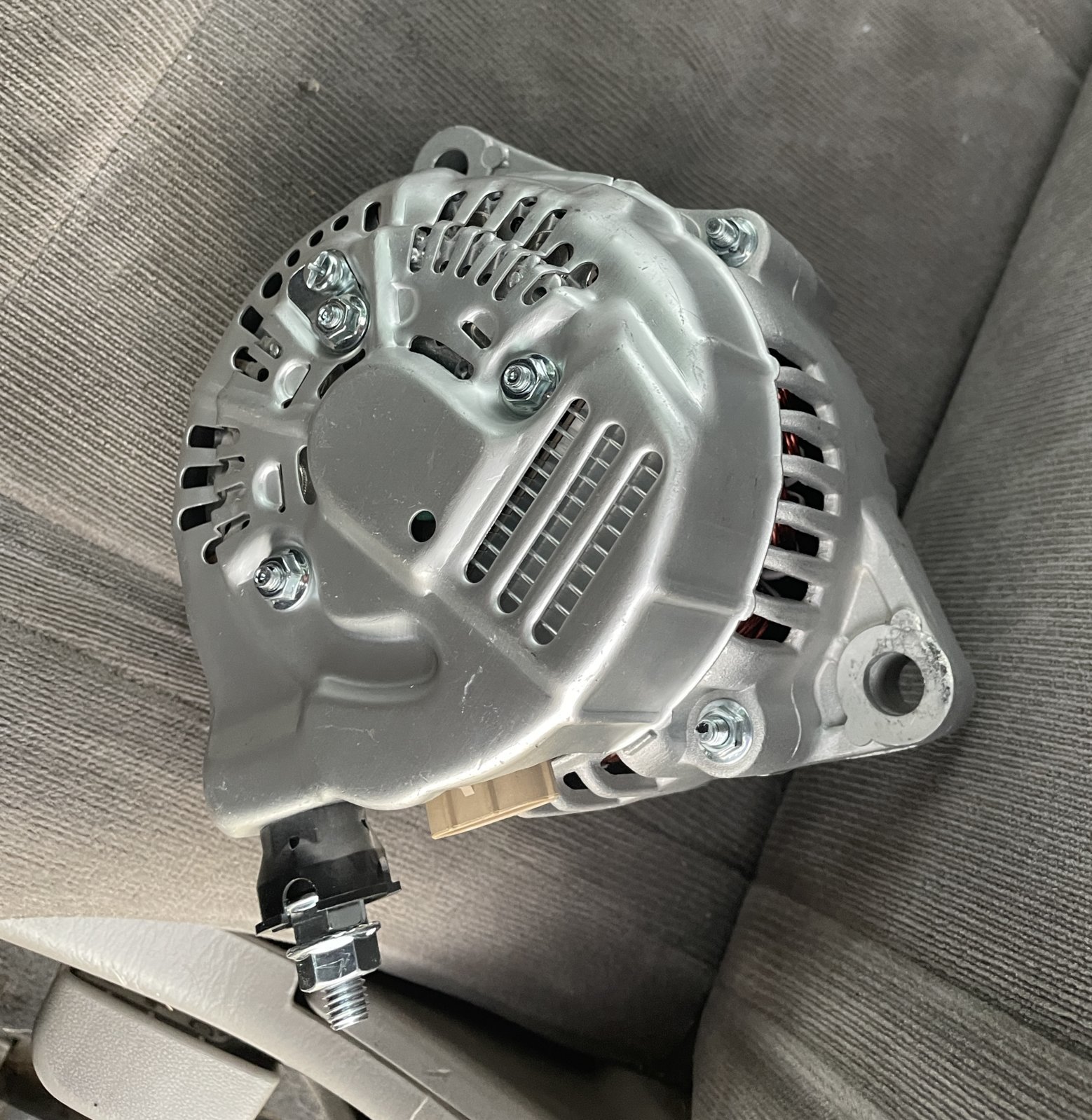

    It's 105amp. And yeah I went with the big 7 kit as well.

    I too have a 1st gen Tacoma 2003 and adding a serious sound system is stressing out the little 60 Amp alternator on my truck, but looking for other Denso alternatives is the trick. I found a 250 Amp with similar mounting! EBay listed NEW ALTERNATOR HIGH OUTPUT 250A FOR LEXUS GS300 IS300 3.0L 102211-0730 As long as the three pin connector has the same pin out and it may need a spacer sleeve. Oh and a small diameter, four groove pulley for charging at a lower RPM.

    Interesting, like to hear how it all fits
