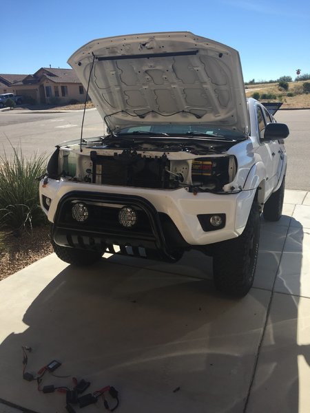

    how to swap headlights without removing bumper on 2015 Tacoma

    No, it's possible. There's been plenty of people that has done it, including me. There's two bolts (one on each side) behind the fender that is hidden, but it's not hard to remove them. And, I'd suggest taping up the headlight lens good so they don't get scratched while you try to remove the headlights.

    +1 you don't have to take the bumper skin off. I did it too...easy please

    Do this! Tape them! I scratched mine a bit trying to take them out.
    Anyways, I had to loosen/move the liner of the wheel well out of the way, then reach up to get to the screw.

    I taped the edge of the fenders too. If I do this again I think I'll tape off the lights too. And I also did not remove my bumper cover.
