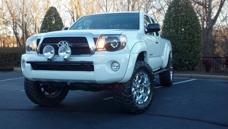

    IMG_20140118_170712_412 (1).jpg i used VHT Nite Shades to get a tinted chrome
