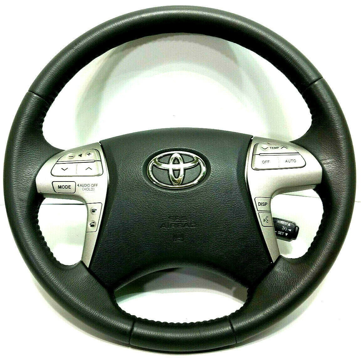

    I found this 2013 Highlander leather wheel, with airbag and controls, on E-bay.
    on E-bay; https://www.ebay.com/itm/Toyota-201...e=STRK:MEBIDX:IT&_trksid=p2057872.m2749.l2649 . The seller offered me a much lower price, and I accepted. So... for less than the price of a Sport airbag / airbag that fits with Tacoma
    a really neat substitute for OEM Tacoma or
    ,I might have a
    blind
    pig in a poke, with NO RETURNS.
    I'm wondering if anyone has tried to integrate a Highlander steering wheel. Does anyone know of any physical reasons why it wouldn't work? Wheel too big, connector bolt/nuts not compatible? The clock spring part numbers are the same. I understand that the S8 pin to R15 28 pin (in my case, 20 pin) sub-harness will need at least one other wire lead added to it. There are other wires that may or may not be needed. I'd like assistance on that part. The mode, seek/scan, voice control, and volume up/down SHOULD be similar, in both message format and connection (s8 plug at steering wheel and 20/R15 28pin in back of radio)

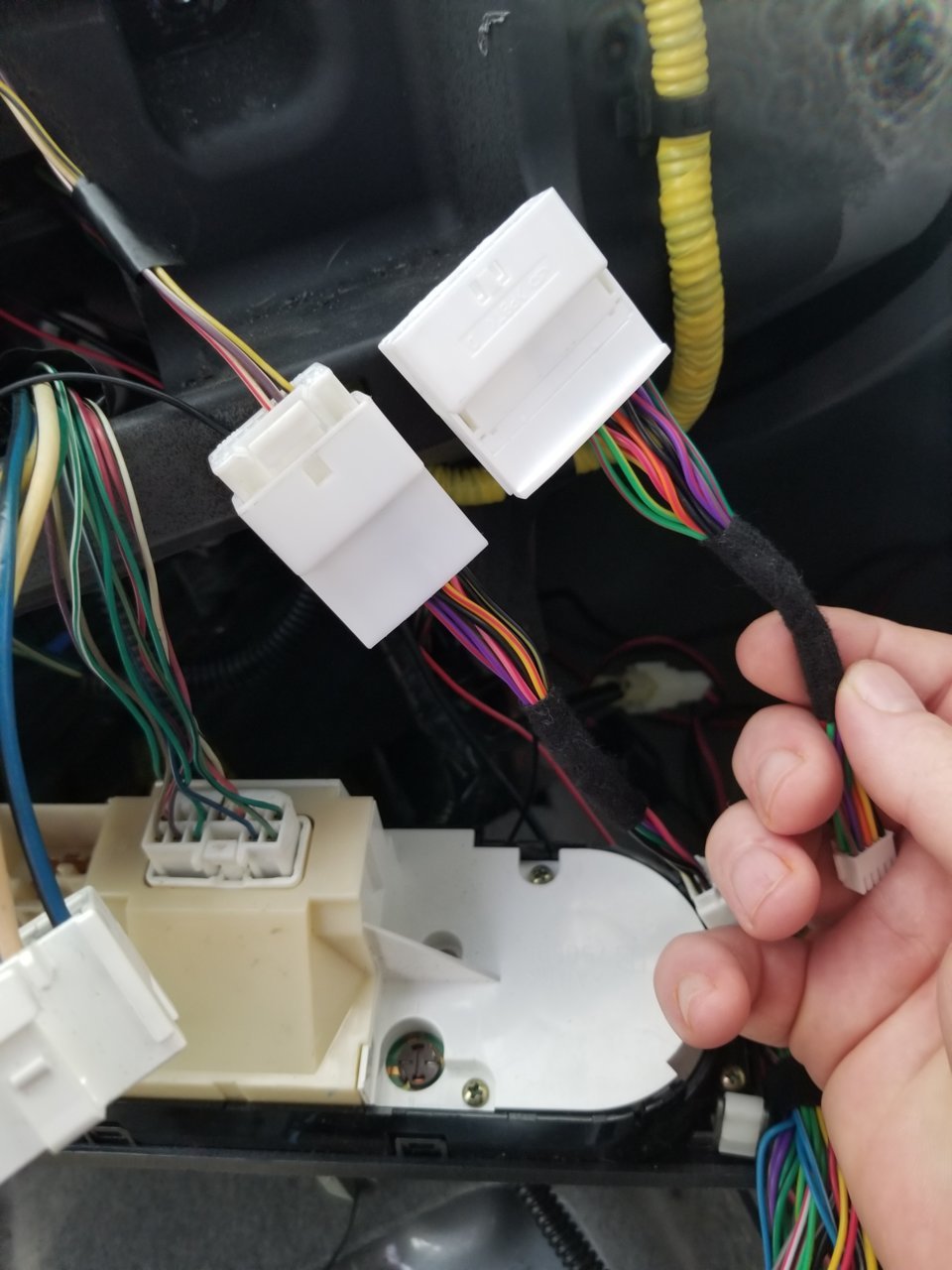

    The Maestro T01 adaptor harness provides seperate/alternative jumper harness selection to support older twenty pin plugs, as well as the newer, ubiquitous 28 pin connector. Here's a pic of the two adapter harnesses, and my 20 pin connected to the three wires from the steering wheel. This is an either/or proposition. You either plug in the adaptor for the 20 pin, or the 28 pin, not both. I am sure, given my wiring, that I could upgrade to a twenty-eight MALE pin on my vehicle harness to mate with the T01 sub-harness assembly. Not sure there is any advantage for me right now, but it is up for further investigation/research/discussion.

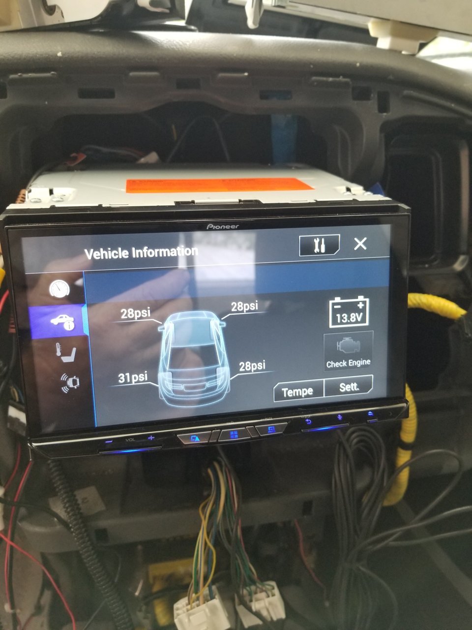

    The 2006 OBD link/connector from Maestro does provide some limited gauges, speedometer, tachometer, intake temperature and the like, as well as TPMS data of temperature and/or tire pressure on the video screen. Neat, but I don't know how well that appears compared to ScanGauge or UltraGauge. You can selectively disable the OBD data/gauge display if other OBD readers are connected, either automatically or "manually" on the video screen.
