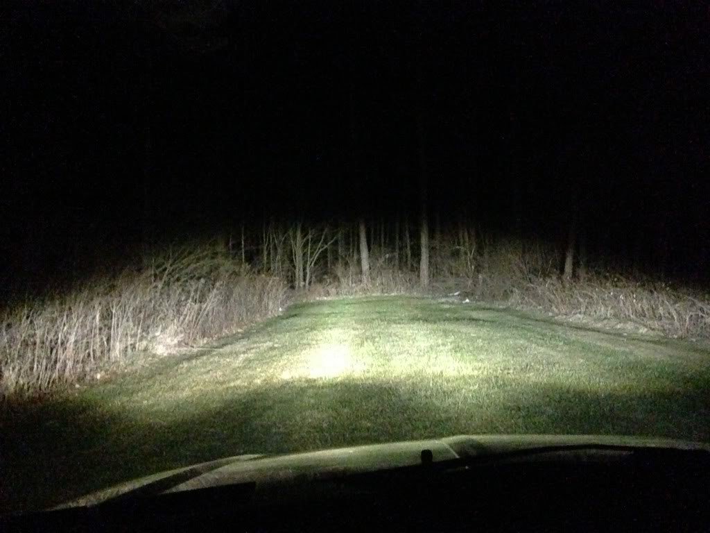

    Here is 4300k in minis
    Here is 5000k in FXR, if you go higher than this you might as well not even do a retrofit

    Just wondering but why do you say if you go higher than its not even worth doing a retrofit? Are they too bright or what.

    no, as the higher K ration the less actual light output and the more purple/blue the light becomes. ideal is 4300k

    4300K is slightly yellow
    5000k is pure white
    6000k isn't too bad but its less light because it's blue

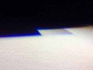

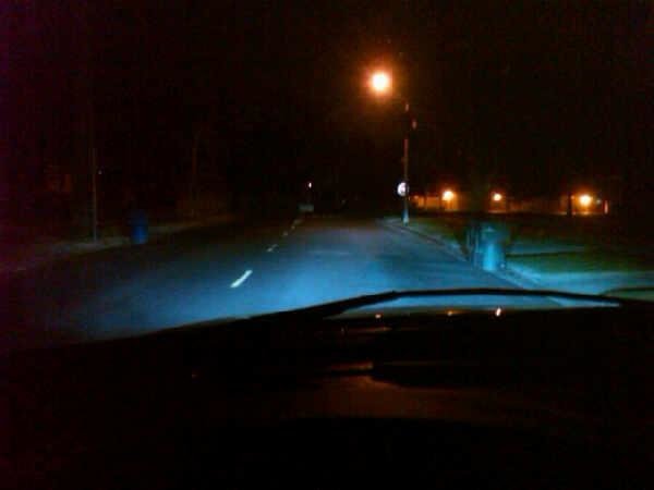

    8000k and up are complete garbage and this is what you see
