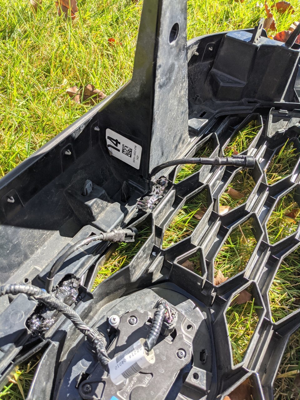

    I didn't want 4 lights in the grille; I wanted three like the Raptor and I wanted them at the top of the grille too. So I decided to not use the plastic adapters to clip in the raptor lights.
    I did it the old fashioned way- with a dremel and some adhesive. There are three spots at the top of the grille that you can dremel to clear raptor lights, and then you dremel the raptor lights to fit. Then you glue that, and dremel the grille support to clear the light housings coming out of the back.
    I used the smoke raptor lights so they kind of disappear when they're off.
    Overall, I like the look better than the plug and play options.
    Off
    On
    Carnage from back
