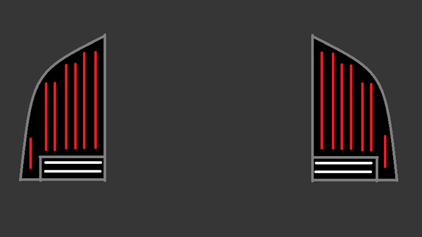

    So that being said, are they super hard to get apart or just impossible without breaking something.
    That corvette looks good. The halos work well with it considering the tail lights are already round.
    I am thinking about xB strips and get a mustang tail light sequencer so they blink outward. So 6 strips on each side in a vertical way hooked up to the sequencer may be the best look and easiest to do.

    Here is my design idea drawn on MS paint (I suck at art):
