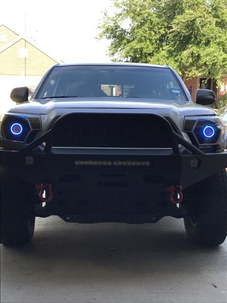

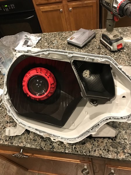

    Finally wrapped these up

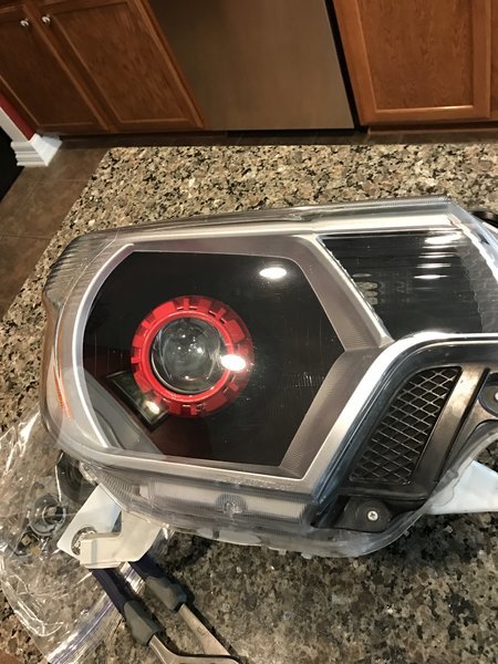

    Did you do these yourself? What kit was it? What are the shrouds?
    Looks good. I'm just bein' nosy.

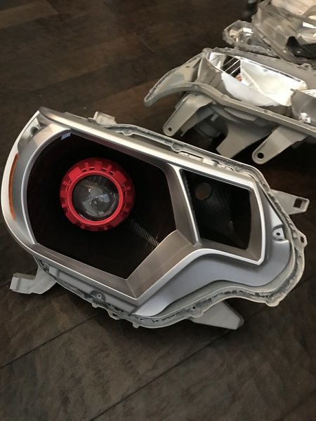

    I did. All retrofitsource...a bit of learning curve tho. Doing another set would be much better. Shrouds are Gatling gun 3.0 I painted, mini D2S projectors, RGB halo and demons

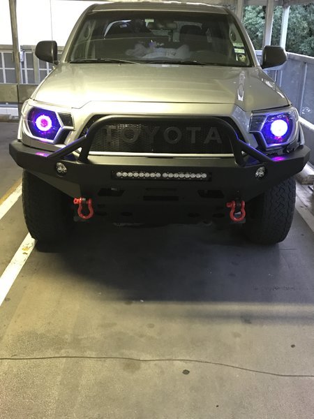

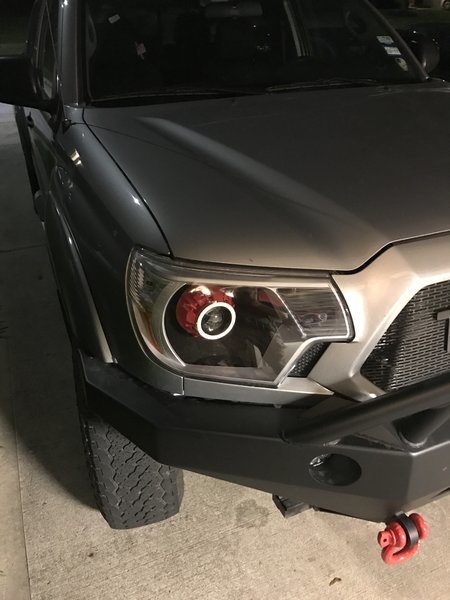

    Few more pics

    Highly recommend color matched

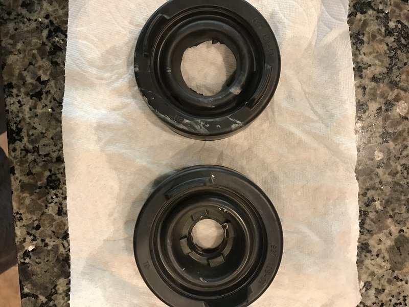

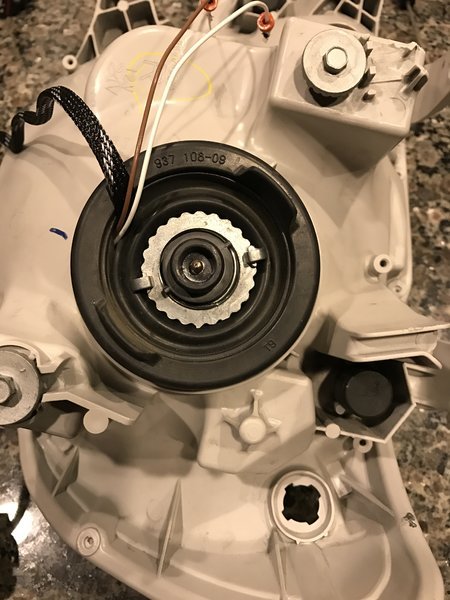

    Forgive me for not knowing how these work but it looks like you cut out the center section of the rubber headlight boot and then poked holes in it to pass wires through, is that right?

    The center cut hole was made more for the lock-nut to fit yet still provide ample factory waterproofing. That said, the wires pass through a smaller slit. Lots of people have moisture problems with these so I also placed 2 packs of dessicant in each light.
