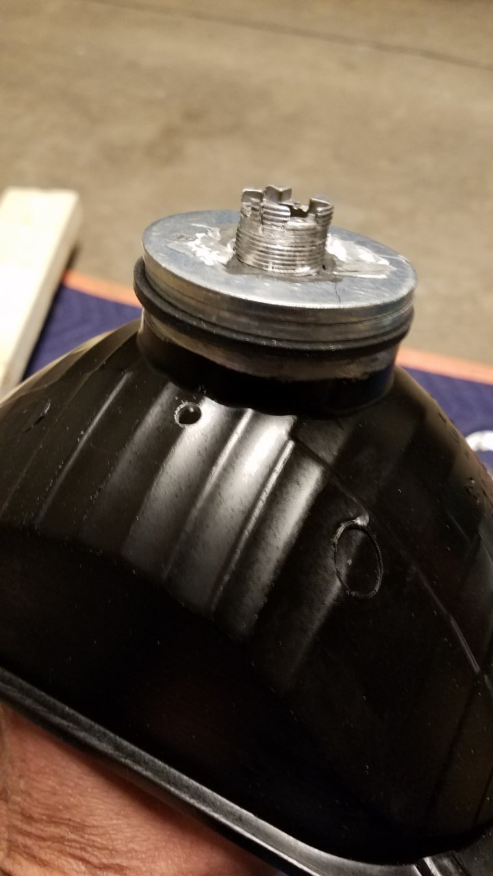

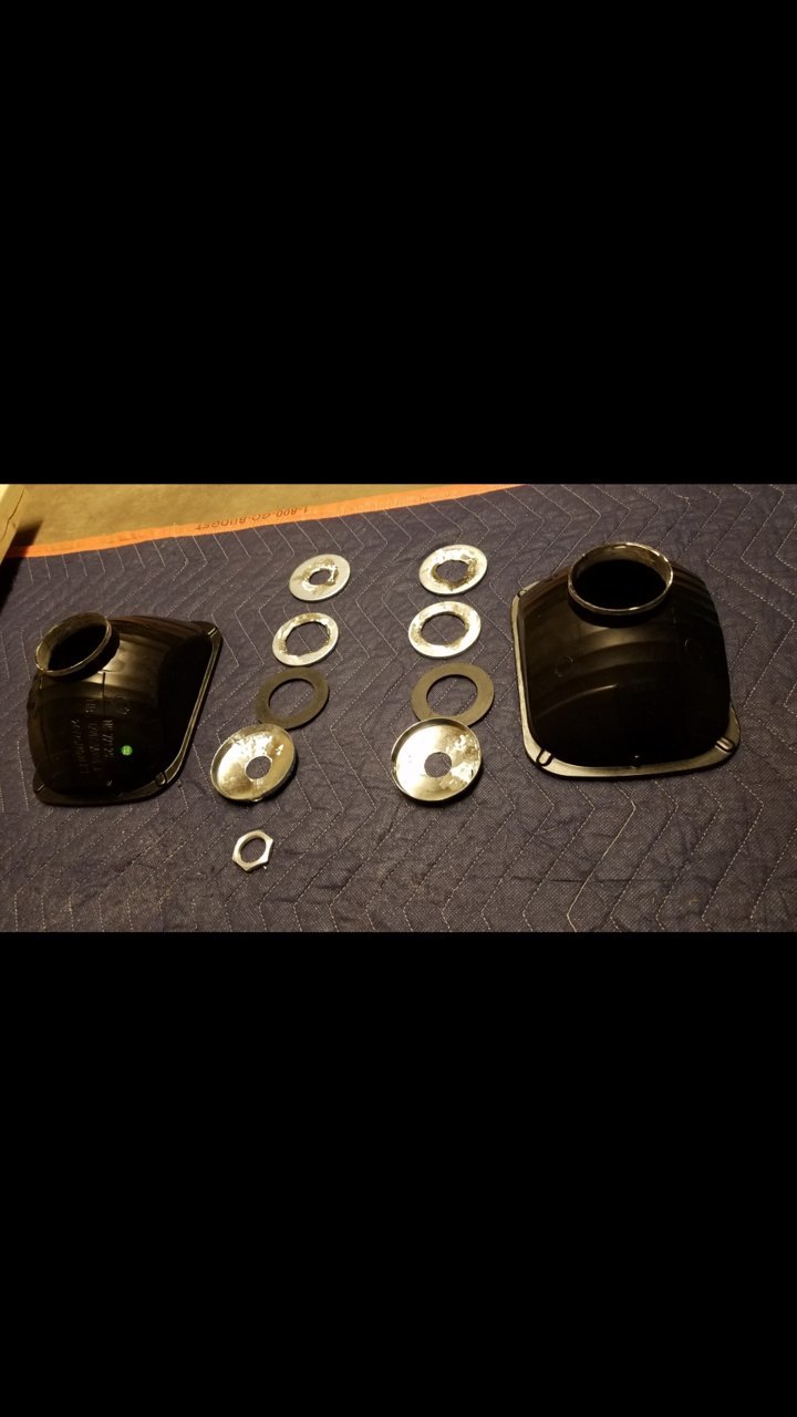

    Has anyone done this retrofit? I am trying to figure out the best way to do it without making too big of a hole in the back of the reflector for the shrouds to cover and am looking for some ideas. I am using the gatling gun shrouds. They are the Mini D2S 4.0 projectors.

    What's funny? Those are very big. You would need to cut the bare minimum that will fit the lense on so you will have the most room possible on back of housing when installing

    itl be tight but possible. you have to cut the hell outa the housings though. gota install the bulbs before hand because its not possible when installed. you can shift battery over some and use heat gun to soften and push in airbox if you need some extra space.

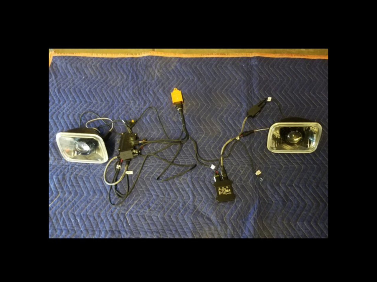

    V6 5sp,RegCab,TVS1320 Supercharger, 56mm pulley, methanol injected Haltech ECU, AC Tvs1320 supercharger,(MUST DO) every 125,000- 150,000 needs rebuild Projector headlights HID 5 speed manual Amsoil for all drive train Smaller 56mm custom pulley, (MUST DO) 2004 DESNO fuel injectors, zero ping ping, 2004 side door mirrors Dick Cepek Rims, Michelin tires LTX, ATM Pathfinders Dynopro ATM ( that last 100,000 miles) Now running Dynopro ATM mud and snow tires KN cold air intake Cat back dual exhaust with ss exhaust tip, Raised exhaust tail pipe to 2" below body line Optima*dry cell battery,red top Alpine sirius radio, 200 watt amp, focal is165 split door pod speakers Focal door speakers Subwoffer behind seat Viper alarm, Electric Locks Dark tinted windows, bucket seats corbeau lg1 Tacoma Rubber floor mats TRD fender extenders, Bilstien shocks, King shocks JBA UCA trailer iv hitch, electric brake control, Drilled slotted brakes, High carbon steel (MUST DO) EBS green stuff 7000 series pads(MUST DO) TRD engine oil cap TRD stick shift, Marlin crawl shift kit. Rear sliding window 2002 4Runner functional hood scoop cut into Tacoma hood, 4Runner dual overhead map light Gentex Auto dim + Compass + Temp, garage,rearview mirror Snow Methonal kit stage 2 Custom 3 core aluminum radiator Linex bed liner Haltech stand alone ECU, Intake supercharger gauge. Stainless steel brake lines, Custom leather wrapped steering wheel, Haltech stand-alone ECU,

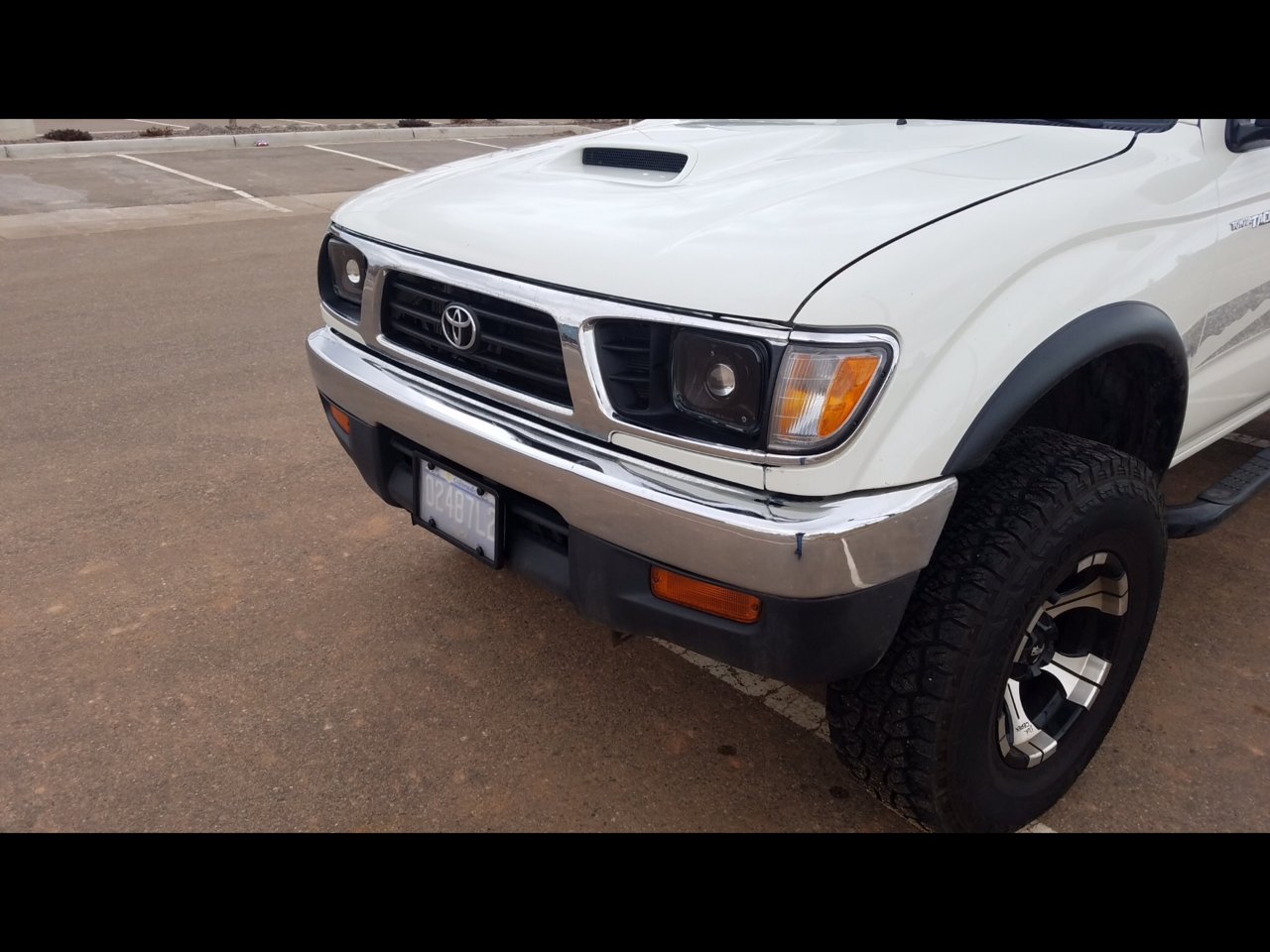

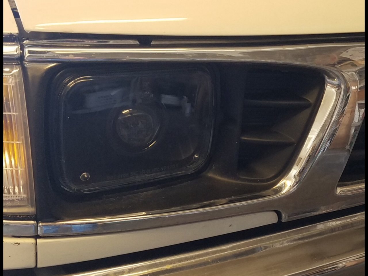

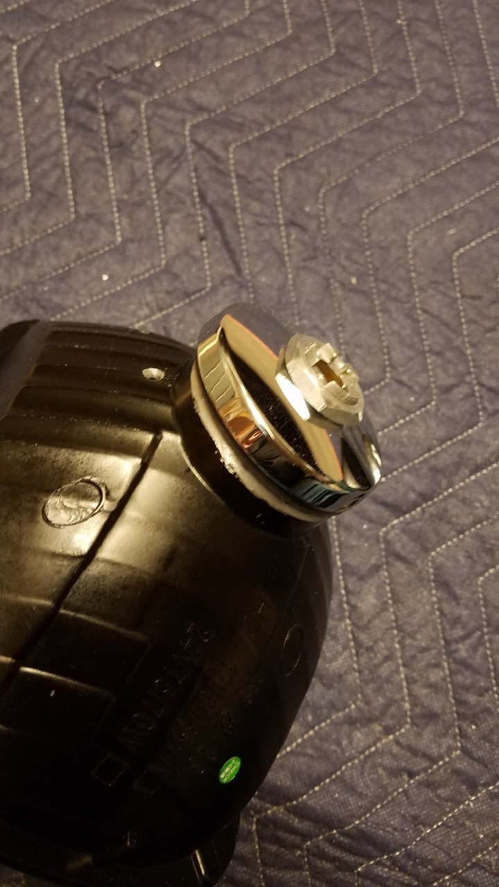

    I used the minis.
    The mini h1 7.0 actually fits pretty well without pushing into the battery.
    The mini 7.0 is smaller in length than the D2S.
    So it doesn’t push into the battery. I’ve been pretty happy with the swap.
    I used glass and metal housing (buckets) with the 5500 k bulbs, not plastic housing, not plastic lens,
    Just ordered the XTR HID (Philips XV2 4800K) bulbs today.
    The Philips is rated at 1050 lums, I think it’s the highest rated bulb for the mini
    The 5500k is rated at 750 lums
    https://m.youtube.com/watch?feature=emb_logo&time_continue=9&v=dRuaHQpbDW8

    that is a mini h1 7.0 in picture. mine hits battery. they are glass and fiberglass housings

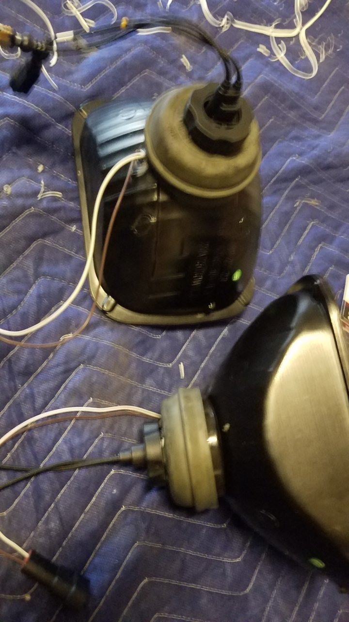

    Ok, though u had D2S, I guess it will depend on the housing bucket after its modified, with buckets and the mini fits for me with no issues

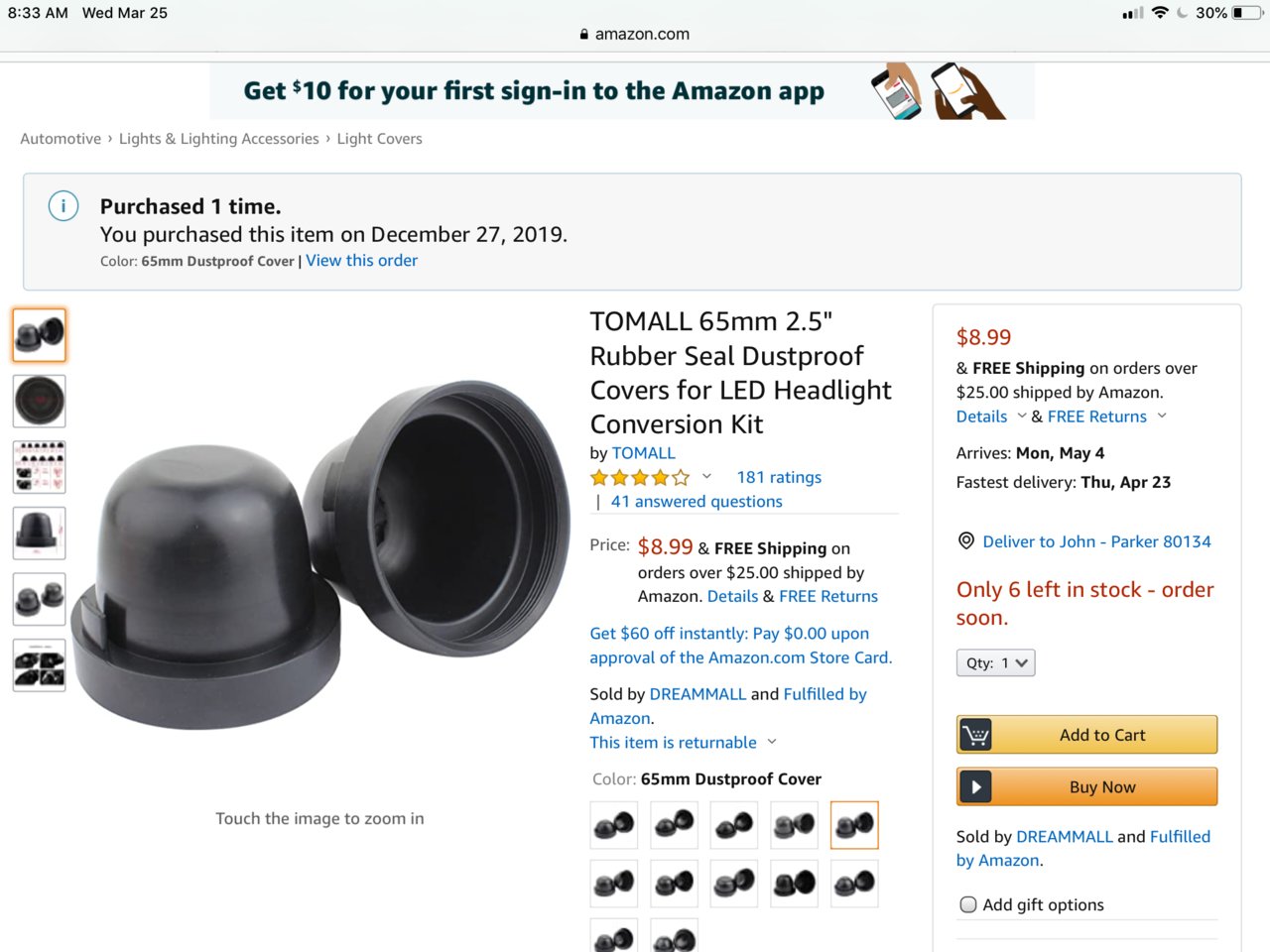

    Also replaced the old gray dust covers with new black ones that cover the complete wires now in the back.
    Was a time consuming project trying to get everything figure out, the parts and steps.

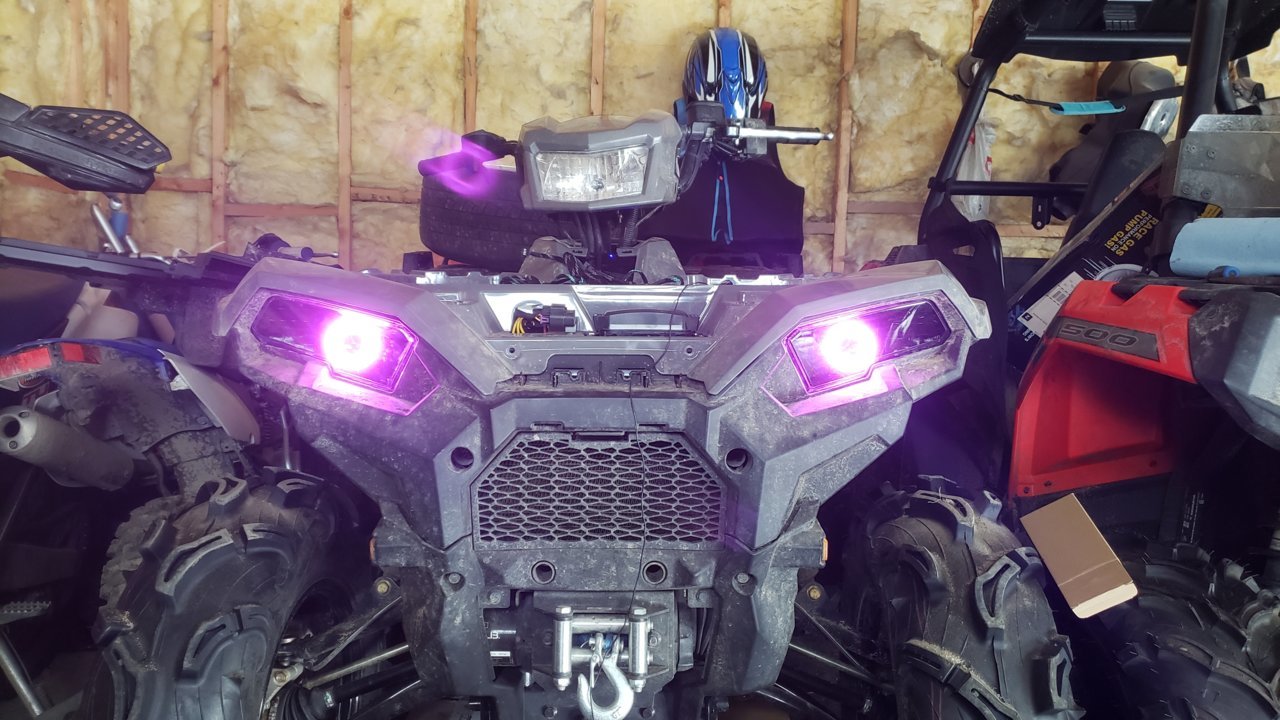

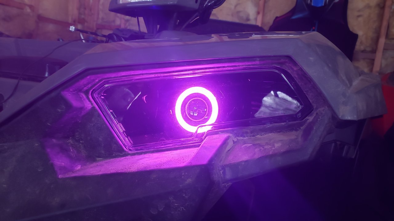

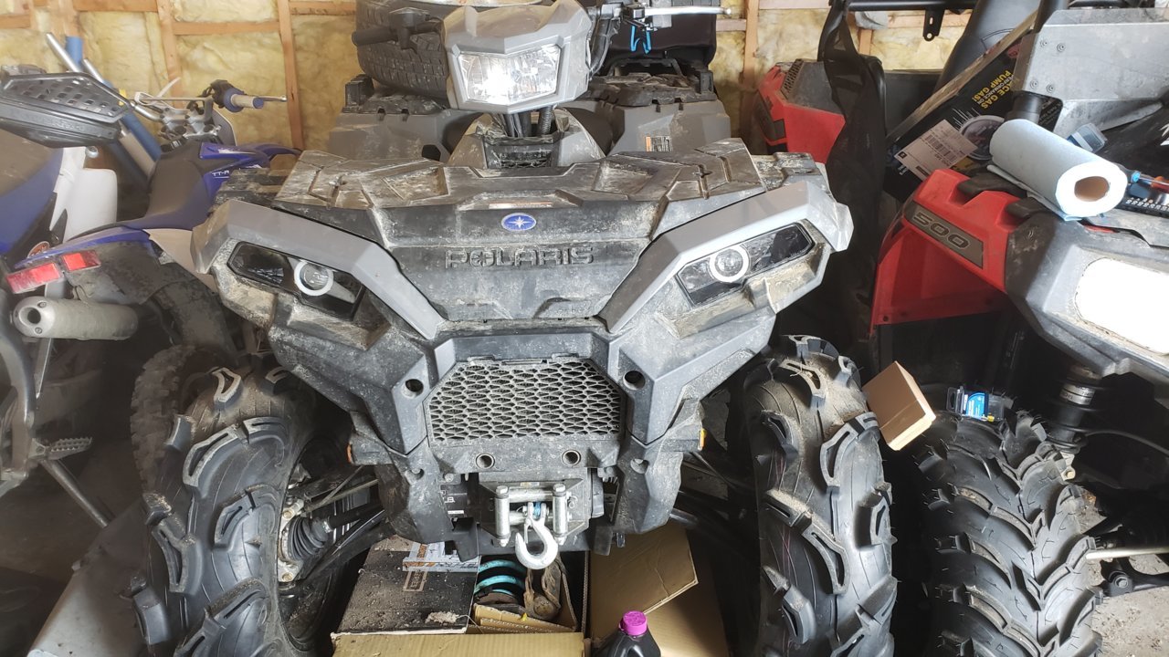

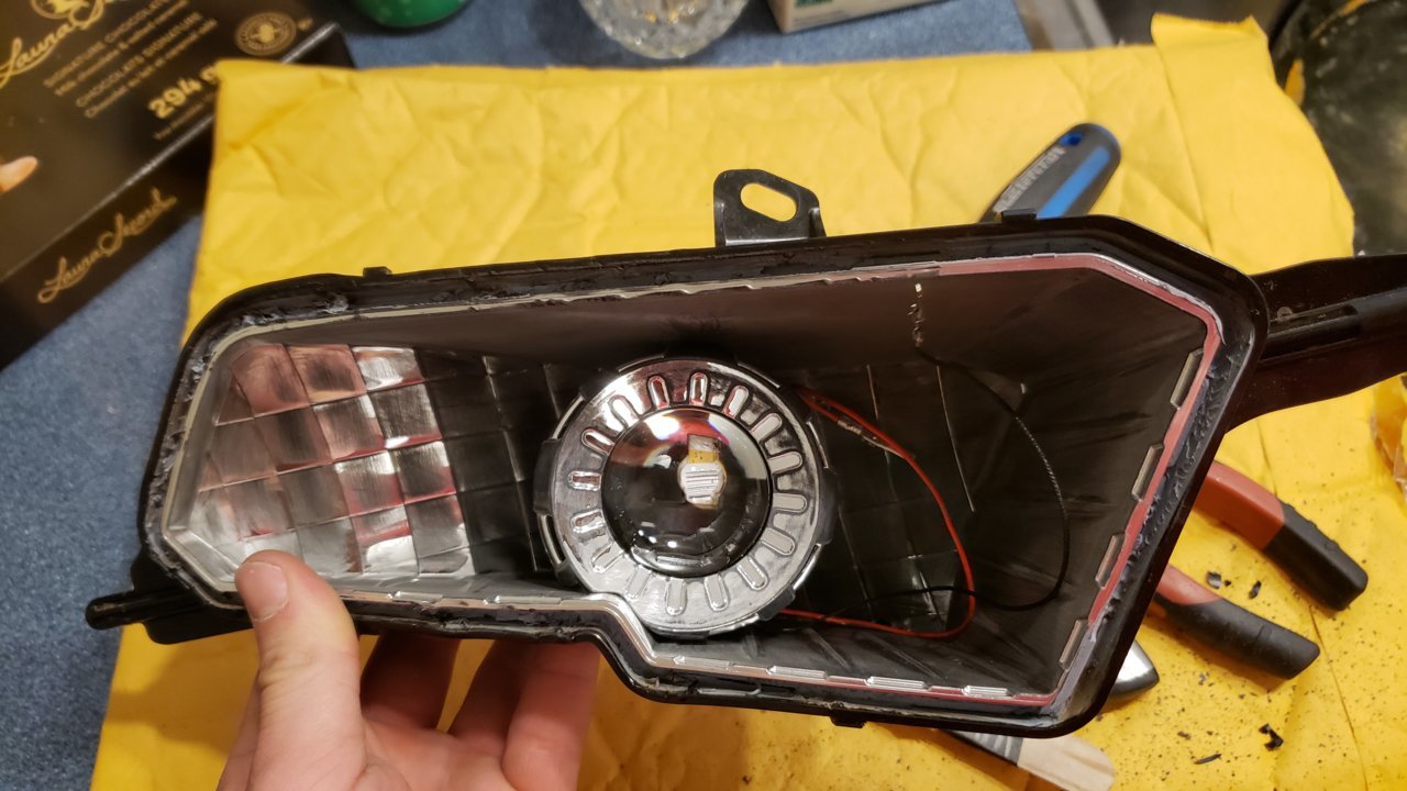

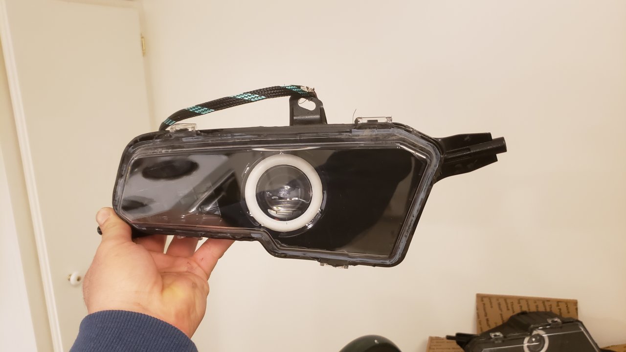

    just finished these for my sportsman. as far as i know im the first to do a retrofit on a 2017+ model. used a matchbox projector and profile rgb halo. talk about a tight fit.

    Those are sick. Been looking at headlight options for my Honda
