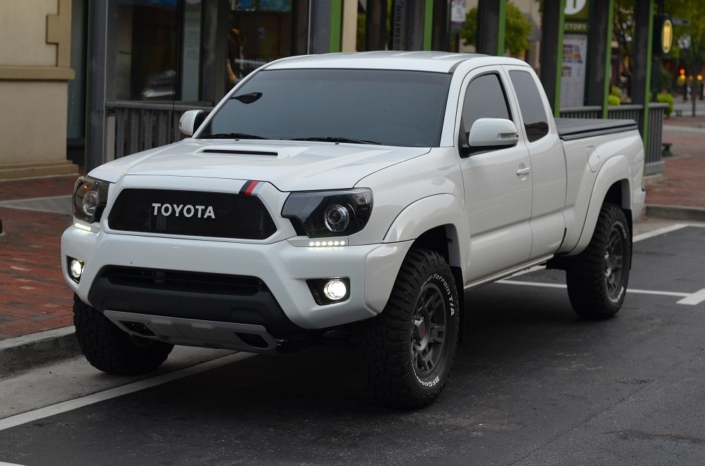

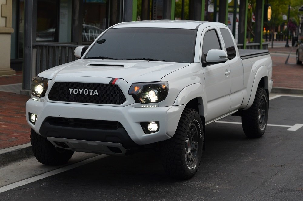

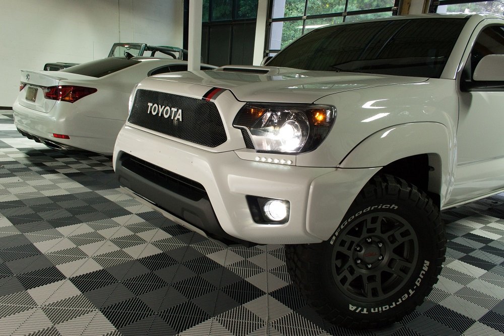

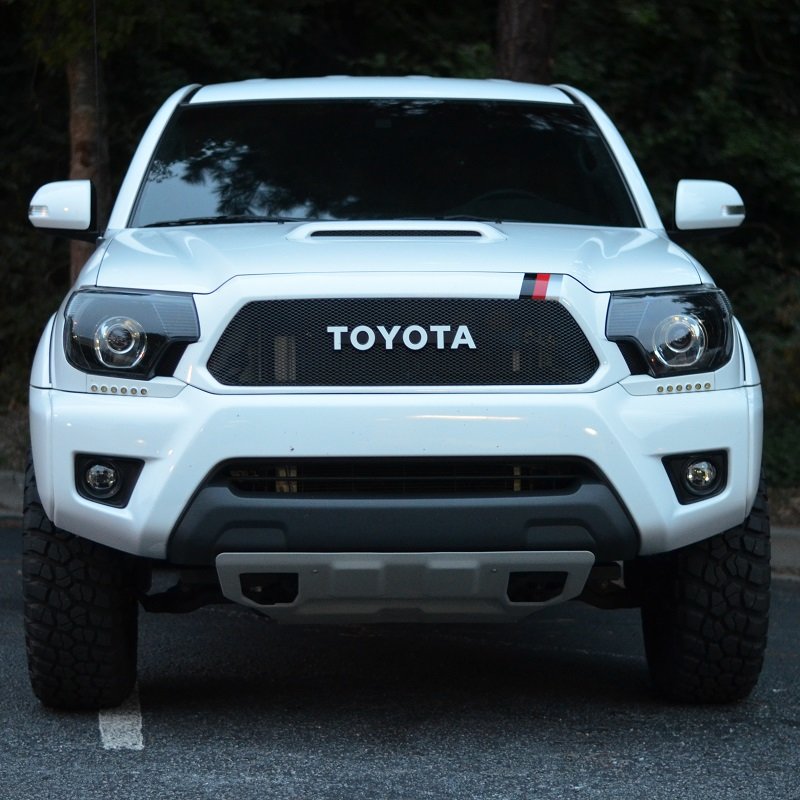

    Finished my personal LS430 retrofit this weekend:

    Tell me that's not your beautiful garage :eek:

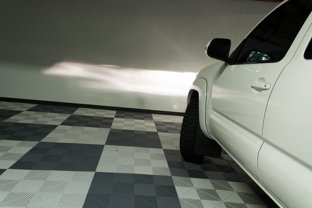

    Can you post up some pictures of the high beams? I know you said you modify the shield to get a taller beam. If it's posted on hidplanet you can just throw up a link.
