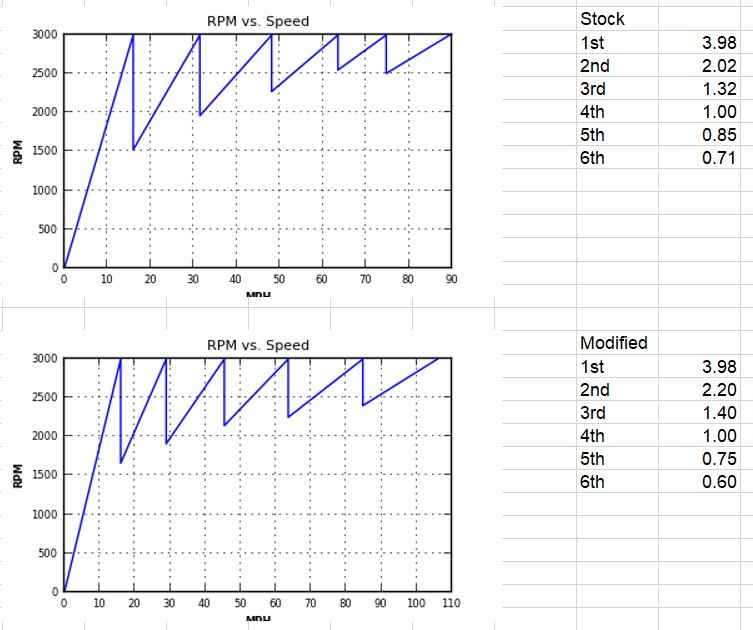

    Same experience here. If you're accelerating, you need at least 2k RPM's to keep moving in this truck, which means you have to rev to 4k in 1st to drop to 2k in 2nd, which is the only time I really notice the rev hang. All other gears are close enough together where I don't even pay attention to it, I just clutch in, shift, clutch out, and the timing seems to work out fine in most cases, except as mentioned in the 5-6 shift where you have to be lightning fast.
    I don't understand gearing design, but if I could spread out 1-2 and 5-6 a bit more, I think it would be perfect. From messing around on a calculator:

    Yeah, I've accepted it as it is what it is, but it's hard not to daydream about past vehicles that had better gearing spreads. Personally, only 1 OD is proper in my mind. 2 ODs is a waste because 5th has barely anymore power than 6th. I'd prefer gearing to be something more like this:
    1 - 4.00:1
    2 - 2.60:1
    3 - 1.75:1
    4 - 1.25:1
    5 - 1.00:1
    6 - 0.70:1
    R - 5.00:1
    And then an axle ratio of around 4.88 on stock tires for my preferences.
    But, oh well. I regeared to 5.29s and now I want to get the Hilux transmission eventually, but I'm fine with how it is for now also. Hilux would improve a few things though.
