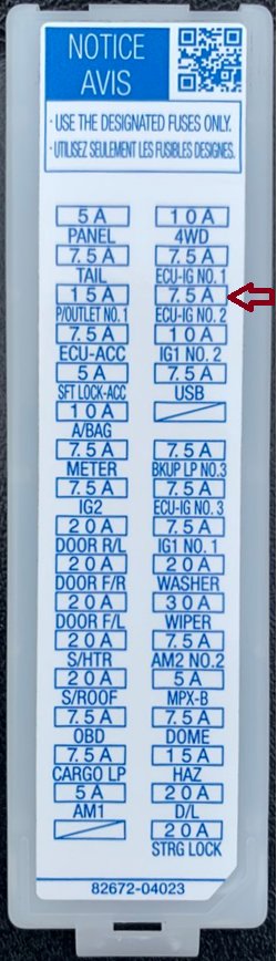

    In the cab fuse panel, identify the fuse labeled ECU-IG No. 2 (7.5 Amps). Remove it and place a new one. Verify systems.

    resolved thansk caribe
