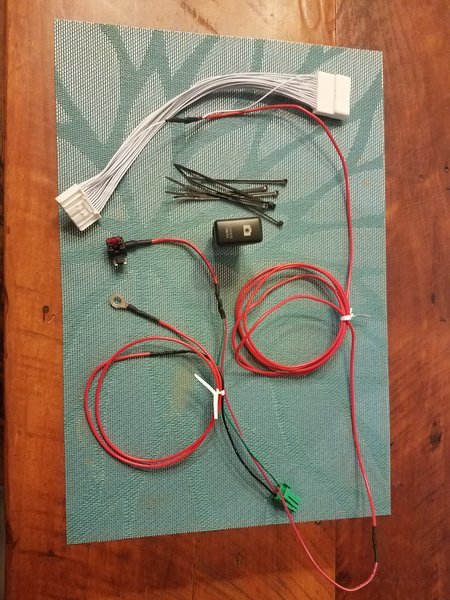

    Order finalized today. Will probably be 2-3 weeks for shipping from manufacturer. Pricing will be the same as current build.

    I will look into this. Build will be similar but will need a different harness.
    A harness for pre 14 should work on 09-13 vehicle with aftermarket HU. Just need to tap in to the other end of the reverse signal wire if it is readily accessible.

    Nice idea, but use black or brown wire for ground, not red. My OCD is kicking in...

    I have switched to a black ground since those pictures were taken. It bothered me too. I was just using what I had at the time. :)

    The diode is necessary to prevent backfeeding 12v to the reverse signal wire. There is no reason why this shouldn't work with your setup. Just need +12 to one side of your switch and connect the lead from the harness to the other side. Bare harness is $18 shipped. Ill solder in the diode and up to 5 feet of wire to tie into your switch for $25.
