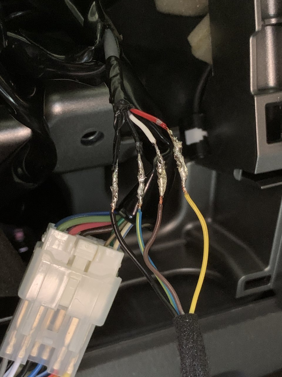

    It's a 2015 - I've got the cables spliced to the wires that were behind the head unit. Here's how I did it, and I'm attaching a picture:
    Maestro / Cables in Dash
    Blue Yellow / Black
    Black(Ground) / Bare wire (wrapped in tape)
    Yellow / Red
    Brown / White

    You might want to practice and redo that solder job. Not saying it won't work but damn bro.

    If it works I’ll tape it up and it will just be between us...

    butt connectors would've been a better alternative too
