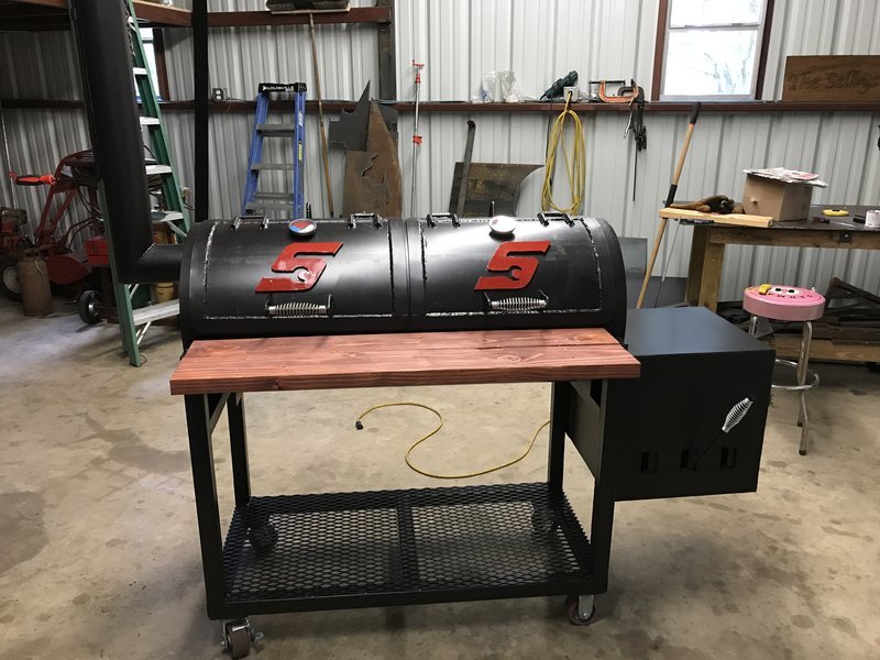

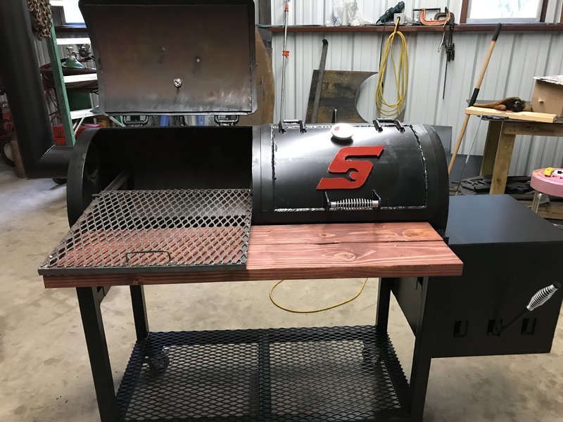

    Thanks! I really like the reverse flow design now that we've used it, both sides are always within 25 degrees and seems to not use much wood at all. Your gonna really like it when u get it built. I also built a normal offset smoker with a friend for his dad for Father's Day. He likes snap on so I added that extra touch on the doors. IMG_0555.jpg
