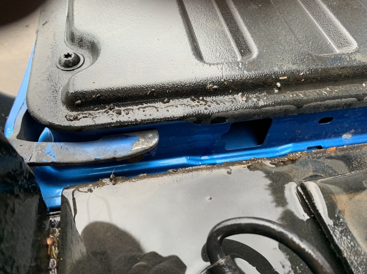

    I'm getting ready to add a Dasaita head unit and a rear view camera in my 07 Taco. I bought the 2nd gen tailgate handle with the camera port. Can anyone tell me where Toyota brings the cable out of the tailgate on later 2nd gens?
  5. Mar 14, 2021 at 4:56 PM
    #25
    Muddinfun
    Muddinfun Well-Known Member
    Apr 17, 2017
    #216500
    7,489
    There’s a square hole in the bottom of the tailgate on the later tailgates. Since yours is a ‘07, it doesn’t have it. There’s a square rubber piece molded to the wires that fits that hole.
