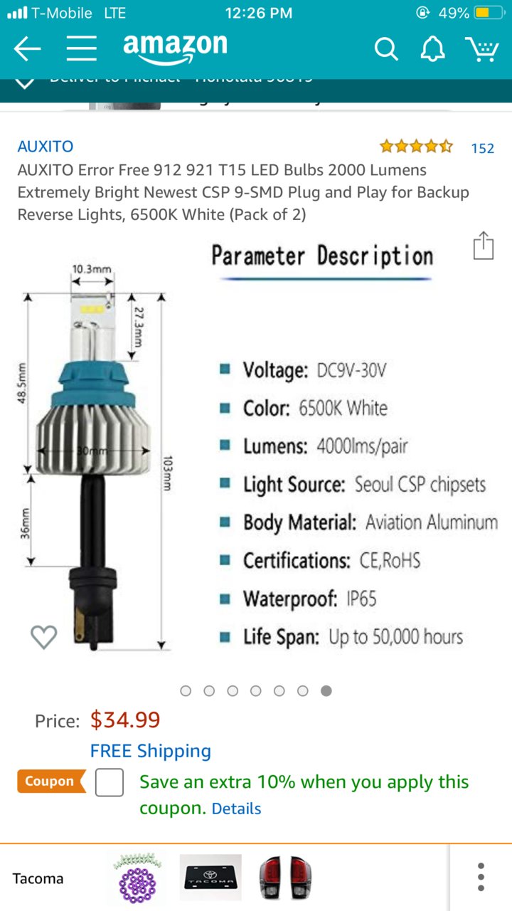

    anyone know if this fits a 3rd gen taco??

    Did you read any reviews on it to see if any reviews have installed it on a taco?
    That’s wicked bright for reverse lights too. Bright as some headlights

    Have them in my 2018 OR 4x4..
    Work great.

    Those LEDs are less than 1000 actual lumens each, sold under a few different brands. Some brands are nice enough to tell you they are intended for short use only or the product will overheat and fail. And as they heat up, output also drops. I use Gy6.35 HIRs which are 860 lumens, but better optically suited for the reverse reflector and can be run all day without overheating issues, so I don’t worry about my lights overheating when backing out of a long trail. But many people have tried those LEDs and like them.
