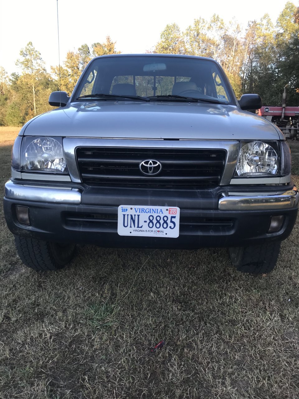

    I recently put new headlights taillights and everything on the truck and the reverse lights worked for a couple weeks and now they come on when they feel like it. Any ideas on why the brake light, running light will come on but no reverse? My guess is the switch in the trans. Also I haven’t adjusted the headlights yet. Wondering which screw would be up and down and side to side.
