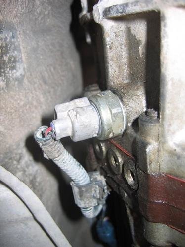

    Takes a 27mm wrench or a large cresent wrench.
    This is what it looks like:
    65870d1463435855t-back-up-light-switch-3_465cc9ac311eb16d57eba38fa79ee42fcc02ce94.jpg

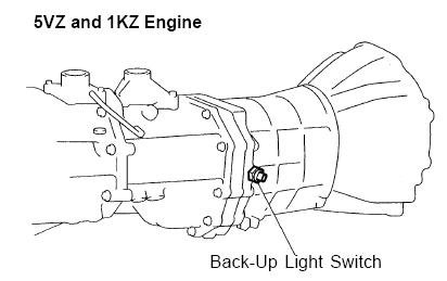

    This is where it should be:
    9506d1155407886-back-up-light-switch-3rd_ba666539f83fe2aac5a2cd0c750f3ae7054b2206.jpg
    9517d1155408887-back-up-light-switch-3rd_eb10228d5c41792d681f8761b62590112b445ba4.jpg

    Just a heads up to you. This was a pretty easy fix for me. The switch is on the passenger side of the transmission right next to the exhaust flange(thank you jimmyh!) I unfastened the two wire plug and jumped out the terminals. You can use a piece of wire or paper clip or anything that conducts. Power up the vehicle(it doesn't need to be in gear). If the lights light up you have a good circuit and a bad switch. Remove the switch with a 27 mm wrench or 1 1/16 inch. Plug back in and good to go. Another thing, the dealership wanted almost $60.00 for the switch. $25.00@ Autozone.
