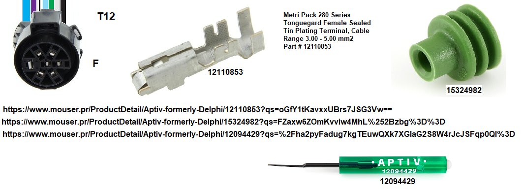

    Disconnect the T12
    De-pin the terminal
    Carefully remove the terminal from wire
    Add smaller gauge wire (extra length)
    Crimp both to new terminal
    Insert into T12
    Mate T12
    tie/secure the wires to harness and at new connection LED's. No flopping around.:burp:

    Anything special about that 280 series Metripack? Just a regular 280 it looks like (10-12g)?
  11. Oct 1, 2021 at 10:53 PM
    caribe makaira
    caribe makaira Well-Known Member
    Feb 13, 2011
    #51121
    11,726
    Caribbean, Puerto Rico
    05 PreRunner TRD Offroad AutoTrans
    Hood Struts, My version Fogs always ON, Map & Overhead Light Mod,
    Nothing special, just as you've noticed, larger gauge.
