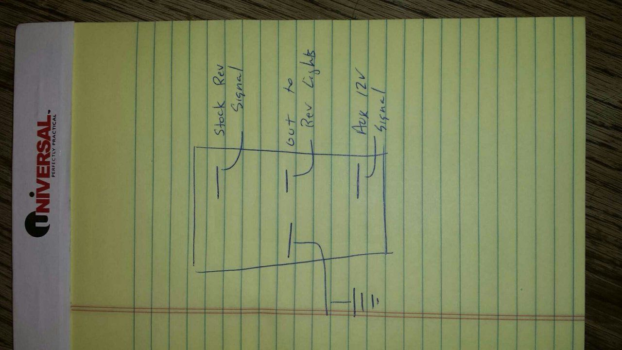

    If you tied in to your existing circuit you need to use a diode.

    I would use a SPDT switch. If it is a lifted switch then you need ground. You could get a light on one side so it is illuminated when you have the "override" active and not when normal. Couple bucks for a switch and time tracing the wires
