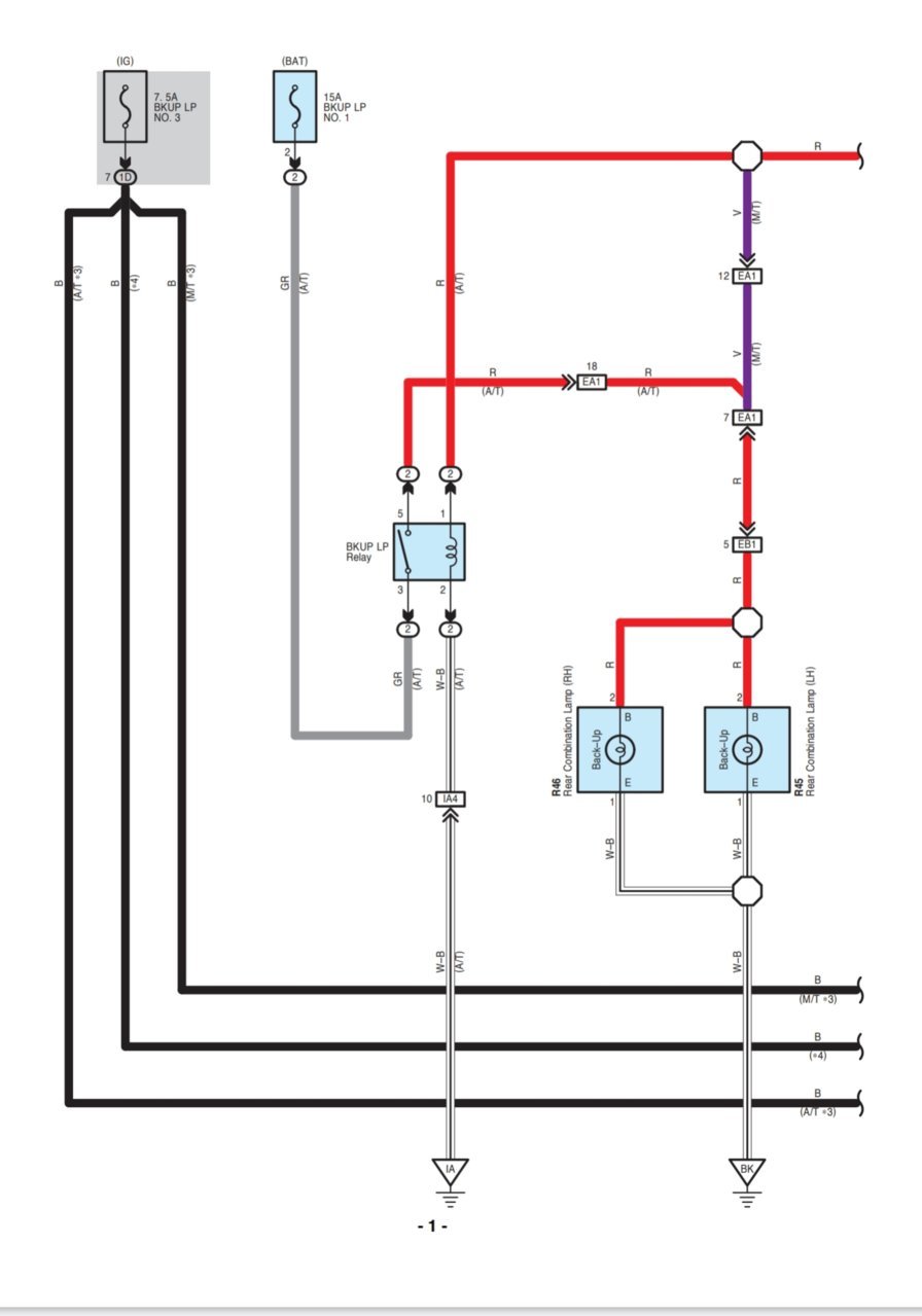

    Here is the circuit.
    Go to the back light and verify ground and power. Then work your way from there. The relay would be next inline. Then the fuse.
