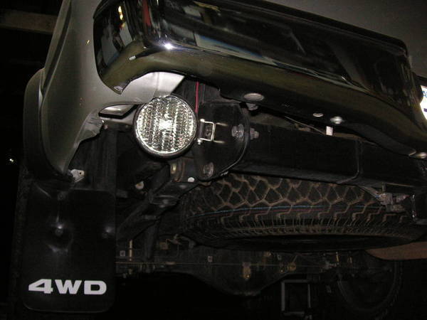

    I put on 2 these. Found them at O'Rielys (Kragen) Auto Parts. They are only about 13 bucks a piece, so if they go out or I bust one, they aren't too expensive to replace. I think they are 35 watts each. They put out pretty good light too. Enough to see back there anyways.
