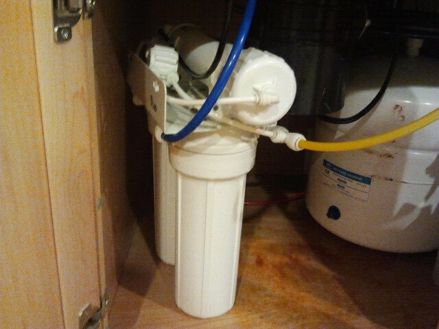

    I get a constant dripping sound in my sink drain while my ro tank is being refilled. I disconnected the ro drain line that is connected to sink drain only to see a constant stream. Its never done this before. I just changed my filters two weeks ago. Am I supposed to do any maintenance to the canister on top?

    NVM. I guess the "membrane" req's replacement as well. Hopefully, that's the problem.

    My Ro sometimes make a dripping noise when the tank is refilling. It's common because its an "air gap" style faucet.

    I used to use RODI water for my saltwater aquarium. The system that I used would dump water from a drain kind of like what you are describing. I think that the ratio was 4 gallons of wasted water for every gallon of RODI water. It had something to do with flushing the membrane while processing the water if I remember correctly. I never did understand why the water was wasted like that though.

    Holy $hit.:mad: 4:1. Time to rethink this RO. Water bill was at $70 last month.
