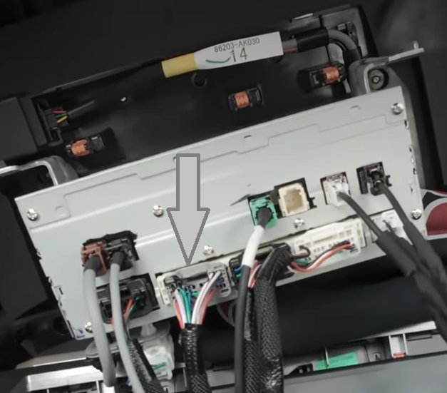

    Hi, I just ordered the wolfbox g900 pro dashcam reverse mirror camera. I will be installing the rear camera on the inside of the rear window looking back. It would be nice to know where I can connect the reverse trigger wire inside the cabin without having to go to the reverse lights or tow hitch. Is there a reasonably easy location inside the cabin. Any help is greatly appreciated.

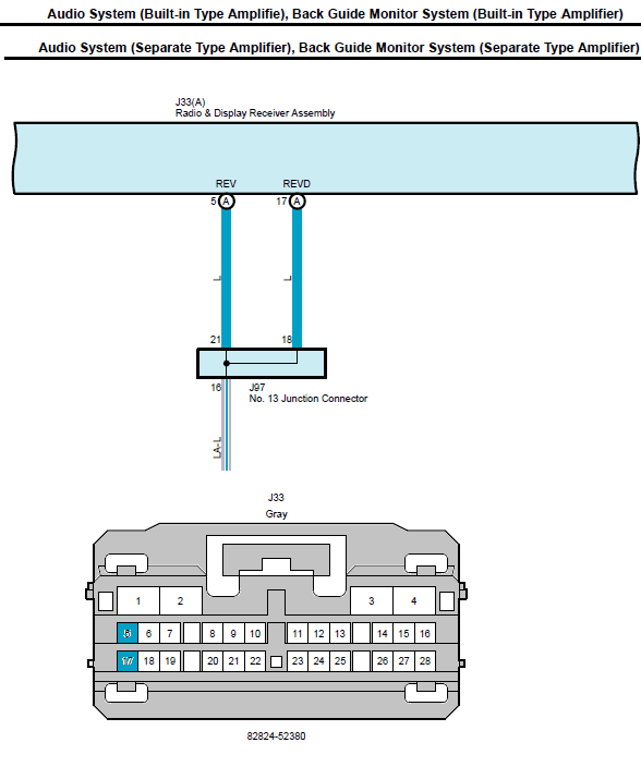

    I am not understanding which pin this is and how do you access it?

    Remove the radio and find the connector on the radio that looks like J33. You’d be splicing in or building a t harness. Splice into pin 5 or 17 on that connector.

    Maybe a stereo shop should do the work with info supplied:burp:
