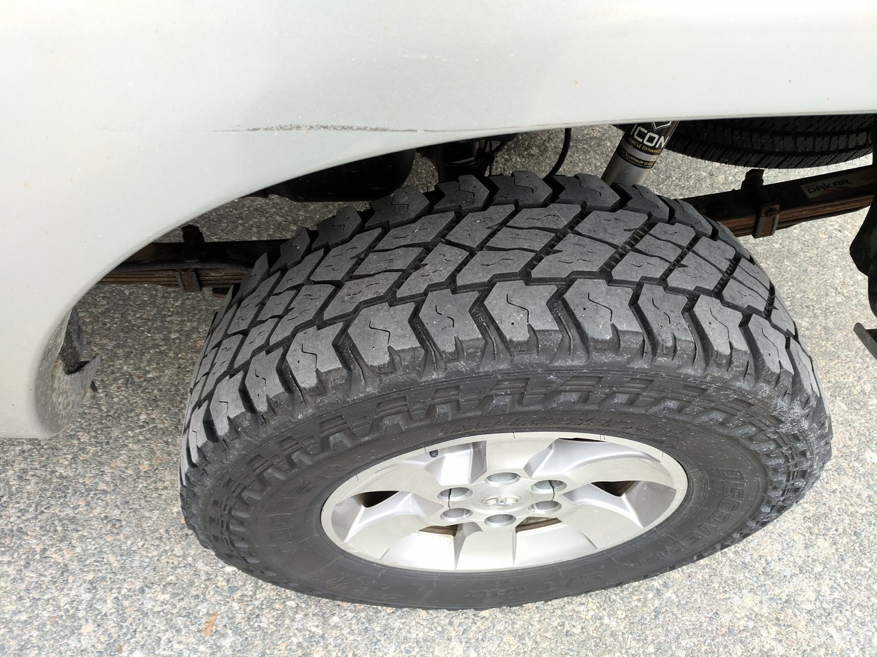

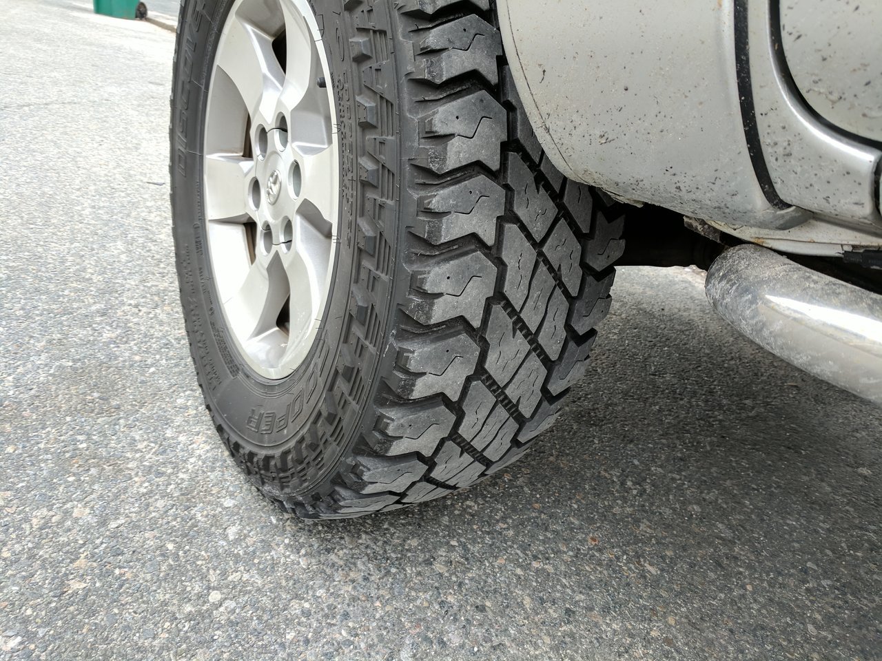

    You can kind of tell how the tires are with the layer of salt on the tread.

    Looking at your pics, I see what you mean about that layer of salt... But, what does it mean? What would cause that? Is it supposed to be like that? What can you do not to make it worse - is frequent rotation enough? Yeah, I know... Bunch of silly questions... (Almost belonging in turd gen forum)
    EDIT: my questions we're not aimed directly at OP...
    After pondering about it a little bit, would wrong toe-in cause this cupping?

    if you can find a tire shop that does this, it's exactly what needs to be done.
    No amount of balancing can fix tires that are not round.

    Is this a common service?

    Common, maybe not. You likely won't find them at big box tire stores.
    Easy to find in an actual tire specialty shop, yes, it should be.
