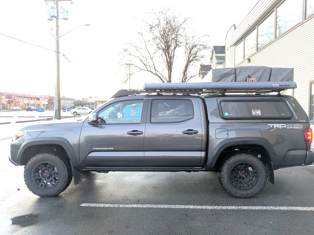

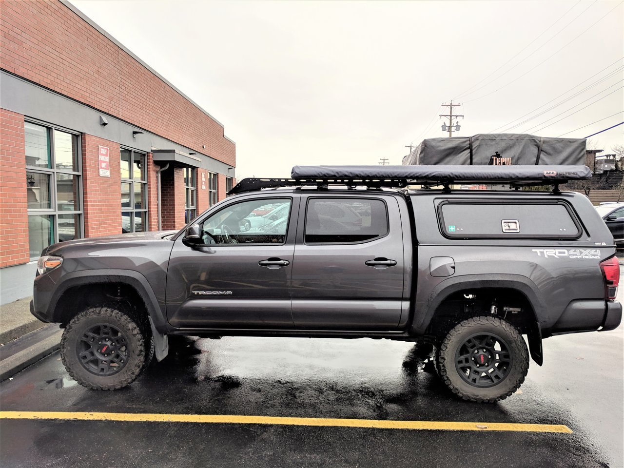

    Hey TW,
    I know there are plenty of threads on the 6112 & 5160 combo, but why not add another to help others make more informed decisions.
    Vehicle: 2018 Doublecab TRD Off Road
    Installed
    • Bilstein 6112 Front Coil/Struts
      • Driver side clip position: 5
      • Passenger side clip position: 4
    • Bilstein 5160 Rear Shocks
    • ARB/OME EL096R (Heavy) Leaf Springs
      • OME says 2" lift with 600lbs constant load. Just what I need.
    • 1/2" carrier bearing drop
    • Pending: 2 or 3 degree rear axle shim (see below)
    Note
    My truck has a permanent load of ~500lbs without occupants and gear. ARE HD cap, Tepui, Prinsu rack, etc. On the stock TRD Off Road suspension, the ride quality off-road was horrible. There was only a couple inches left in the rear before bottoming out. The ride was way too soft and sloppy. Even on-road it sucked (bottoming out on speed bumps). I expected this stock truck to be able to handle 500lbs a lot better than this, but oh well! This means when you look at the resulting lift, especially in the rear, you may not get such a big difference if you have less weight (stock ride height would be higher than my starting point).
    Lift after 1 month (measured fender to center of wheel):
    • FRONT - 2" lift (before: 20.5" after: 22.5")
    • REAR - 4" lift (before: 20.0" after: 24")
      • Again, do not not expect this if you don't have a heavy permanent load. I would bet stock readings on an empty truck would be closer to 22", meaning a 2" lift.
    Off-road performance
    • 10/10
    • So much firmer, even with 1000lbs loaded. Is no longer sitting on the bump stops. Truck feels planted, even at higher speeds. No noticeable fade in the rear over long distances (really bad with stock).
    On-road performance
    • Currently a 7/10
    • I have minor driveline vibrations between 15-60kmh, but believe this will be fixed after adding the shims to the rear axle. Will report back in a couple weeks.
    • Doesn't bottom out any more. Ever. Feels firmer, more planted, and I feel more in control.
    Vibrations fixed:
    • Installed 1/2 carrier bearing drop - still had vibrations
    • Installed 2.5 degree shims on the rear axle - VIBRATIONS GONE!
    Hard to say if it would be good with just the shims and no CB drop, but I'm not messing with it anymore ;)
    Overall - pretty much exactly what I wanted. Much happier with the truck now. Before I would cringe on the smallest bumps. 10/10 would recommend.
    Before
    After
