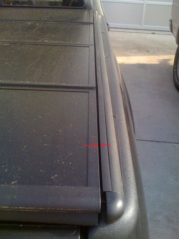

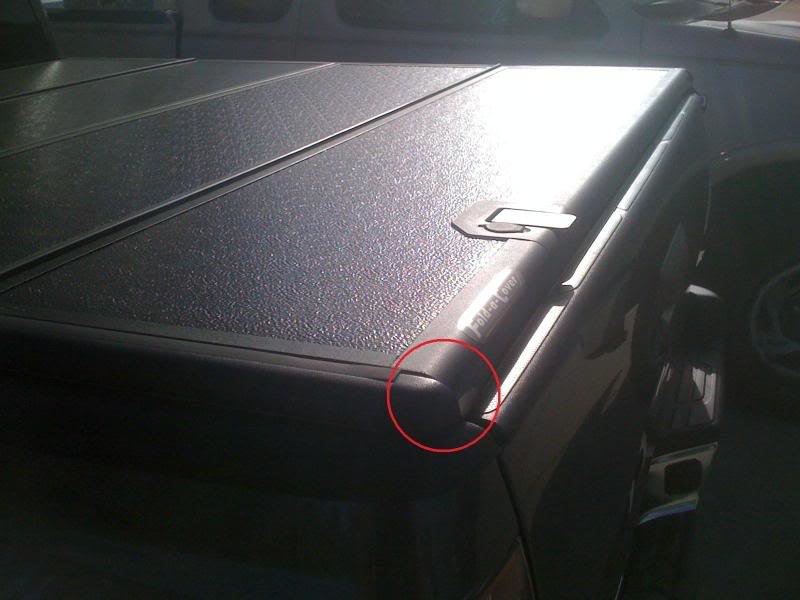

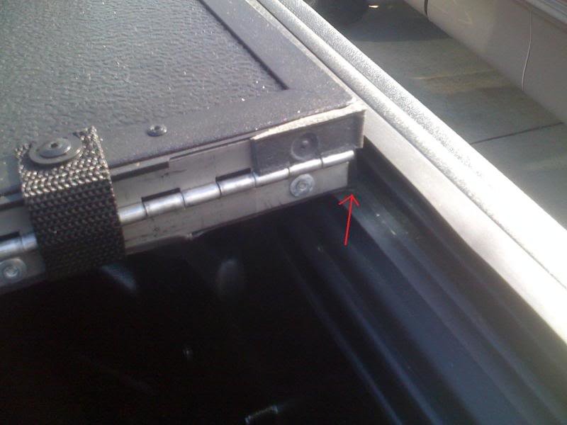

    Here are the little issues with mine.
    A bit of a gap between the top guide rail weather seal and the actual cover. This was a result of me going a bit too wide trying to make sure I left myself enough room to mount the cover. At the time I told myself it'd be better off with a little extra room than not enough.
    Here you can see that there is a second weather seal on the bottom that should keep the moisture out. So the first photo isn't really an issue.
    Here was my major issue with the cover, see how the guide rail sits about an inch back past the actual cover. I followed the instructions to the letter and this is how it turned out because they basically have you guess at how far forward or back to mount the guide rails. However they need to be in an exact spot to catch the locking mechanism that uses pre-existing static holes that determine the exact location of the cover.

    I don't want to argue but I think the instructions were very specific as to the gap on the sides, 1/32 to 1/16 and to lining up the rails to the top. I really don't think you "followed the instructions to the letter". They were very in depth for the most part, the pictures were hard to make out at times but once I really looked I could usually see what they were trying to point out. I did call them at one point and got right through, as I was lining things up there seemed like too big a gap above the molding but the tech assured me the moulding would take up the gap.
    It looks like your rear moulding is on backwards or something. It is supposed to continue the angle of the hatch and come forward. :confused:
    As far as the water tight question I am not sure yet, light sprinkle, yes, downpour don't know. The manufacture says it isn't water tight in their literature but I think that is so they don't get sued.

    My rear weather seal is on the same way as yours it's just hard to tell from the pic.
    My instruction packet said slide the cover back so the tailgate latch hits the tailgate and then move it forward 1/16" which I did, measured it twice, marked the spot.
    The spot was right, but in the end the cover was almost an inch from where the instructions said it would be. This was because of the pre-existing holes that the locking pin installs to. That one piece determines where the cover should lie.
    You said you adjusted yours with a rubber mallet, the guide rails?
    I wonder if I can try that?
    I could fix every issue with this cover in about 20 minutes with some alcohol and double sided tape. But it's not worth the trouble, ya know?
    It's really not that bad. I still like love the cover. Now I'm trying to figure out how to get some lights in my bed now that will come on automatically when I open the cover.
