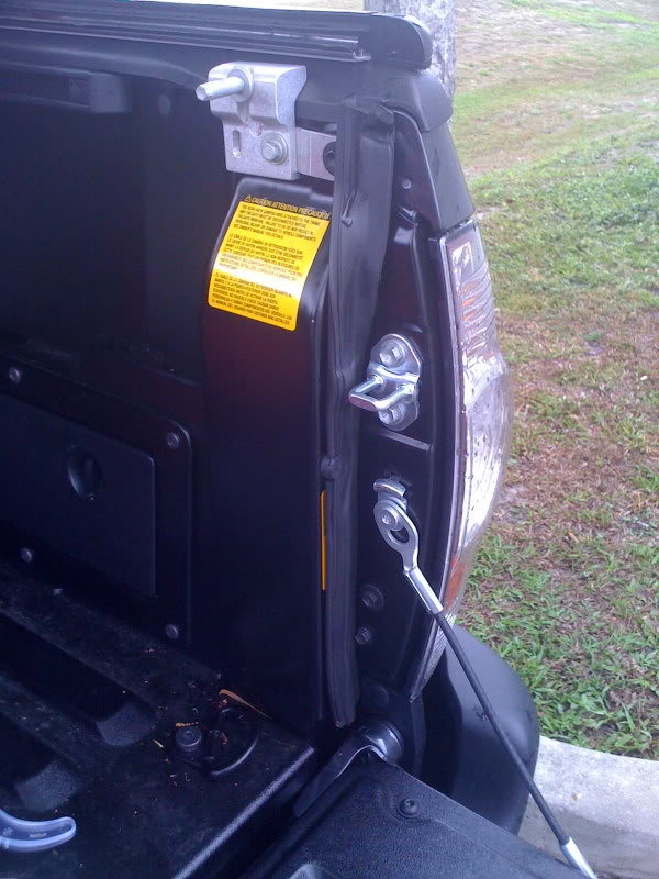

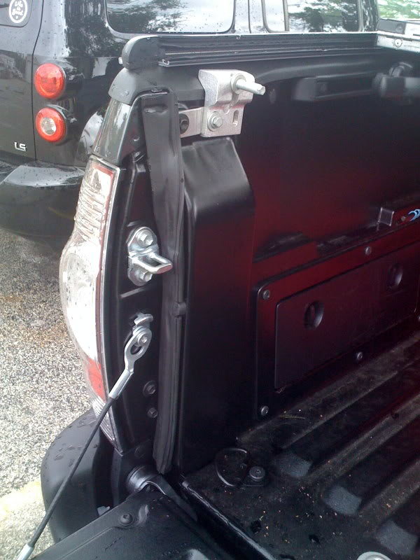

    Since installing my tailgate seal, I get about 80% less water in the bed.
    Sorry for the bad pics, they're from my phone.
    Right side
    Left side
    As you can see i notched it a bit around the tailgate bump stop (just below the tailgate latch catch)

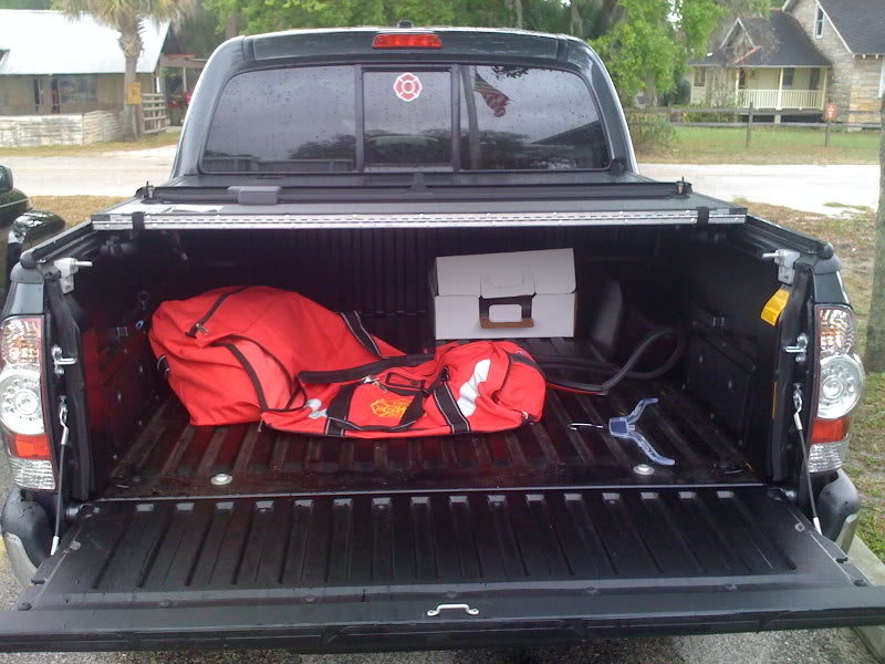

    Both sides

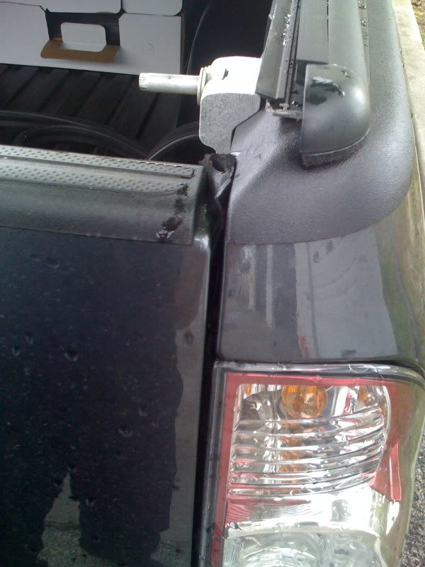

    Tail gate shut, cover open, No more big gap!
    Cover shut

    Thanks for the pics, and the info. I haven't caulked yet but plan to.

    just noticed, is that rear latch only held by one bolt even though theres a spot for 2?

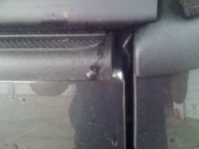

    Yes, you can open the tailgate with the cover shut if you don't install that handle.
    However, you may want to open the cover to shut the tailgate or else it may put excess pressure and wear on the rear seal.
    See the piece of rubber along the top of this picture, it sits on the bottom of the rear panel of the cover to keep water out.
    I think if you shut the tailgate on this it might damage it over time.

    There is 2. One of the bolts used is the stock black bolt to the left. If you notice there is a bracket to the left of the main assembly...
